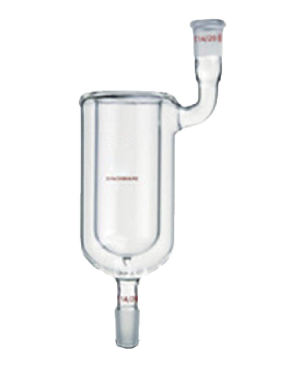

SWIM
Posts: 970
Registered: 3-9-2017
[*] posted on 30-3-2021 at 12:43
A really big Dewar condenser can do the trick sometimes.
The large volume around the ice reservoir helps stop any geyser action.
Also, if the condenser chokes spattering will tend to be caught in the condenser body.
https://images-na.ssl-images-amazon.com/images/I/41YVxSbUe-L...
Helps to put an Allihn condenser on top as a belt and suspenders measure sometimes.
zed
Posts: 2281
Registered: 6-9-2008
[*] posted on 30-3-2021 at 22:05
Ummm. Dewar condenser. Interesting idea.
Thank you.
