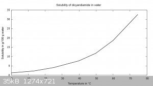

Dicyandiamide has a steep solubility curve in water and can be readily recrystallized from it. 81.58 g of dicyandiamide are dissolved in 400 mL of 75 °C water, filtered hot and cooled to 10 °C. The solution has a pH of 7-8. The crystal shape changes, it is no longer needles but rather rhombic plate-like. Recovery was 70.06 g (86%). The previous tests show this is probably unnecessary. The reason for the change in crystal shape has not been found so far. At 0 °C the solubility is 1.27 g/100 g water, at 74.5 °C it is 32.58 g/100 g water.
solubilityDCD.png - 35kB
