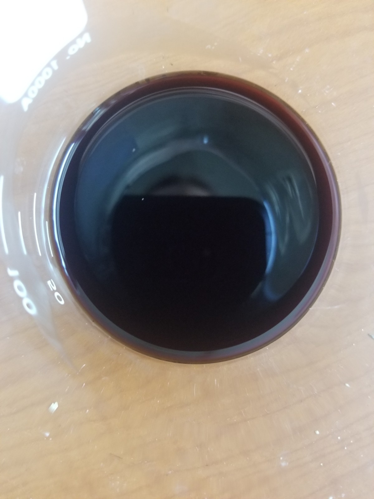

Recently, I extracted paracetamol for use in random projects I wanted to try. One reaction that I had read about for the iodination of phenolic rings,
mono-substituted and poly-substituted, using H2O2 and I2 in water. Many of the compounds listed that they tried were similar, including
para-aminophenol (PAP). Their 1:0.5 ratio of H2O2 : I2 gave roughly 49% yield of the mono-substituted PAP and roughly 30% for the di-substituted PAP.
And the reaction was carried out at Room Temperature, or a quick heating to 50C to get the reaction started.
My question here is how to tell that I got the right compound without NMR or fancier stuff? I have DCM and ways to filter and even a chromatography
column. Their paper calls for a Sodium Thiosulfate mix to quench the byproducts and Iodine water, and then for a subsequent DCM wash. But before I

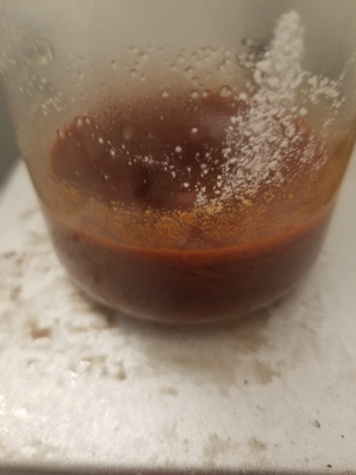

carried out the DCM procedure, I decided to do a spot test by dissolving my crudely filtered product (I didn't have Thiosulfate so I thought a simple
filtration would do) in DCM. This was disappointing to say the least. It just stayed in the water layer and did not move, but didn't dissolve in the
water either!
In reflection, am I possibly mistaking the reactivity/activity of paracetamol as opposed to PAP? Also, I tried heating at a constant 50C for a quarter
of the literature stated time (24hr reaction time), and got same result. Bunch of red precipitate from water solution, dried and filtered with vacuum,
and then spot tested by adding DCM and precipitate. Added water to see if that had any affect of the dissolution of my precipitate.
There are a few attached photos:
-Reaction mixture photo showing the ugly precipitate that is definitely hydrophobic
-Spot test with DCM

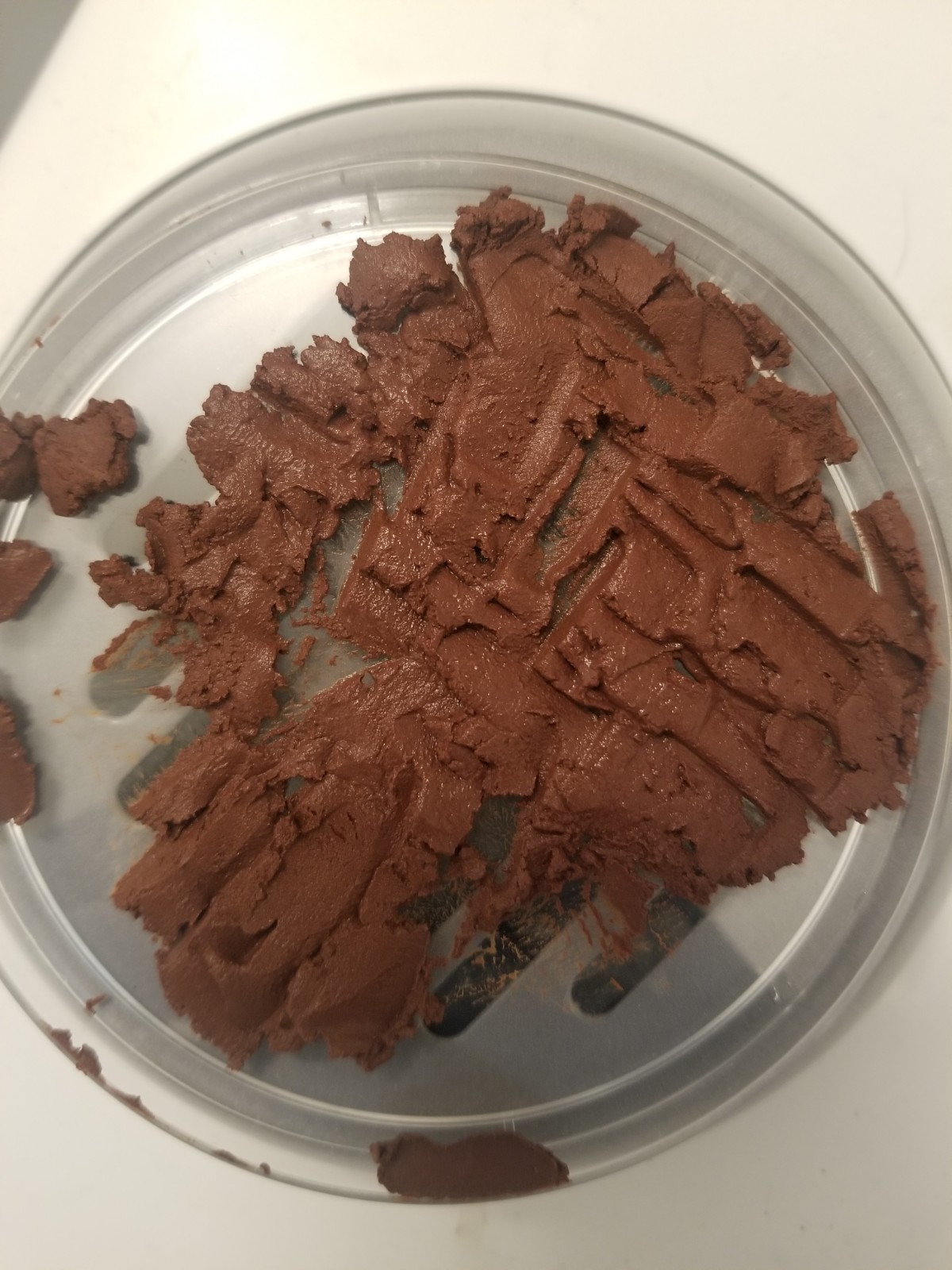

-Drying 4-acetamido-2-iodo-phenol (or 4-acetamido-2,5-diiodo-phenol)

Update, going to try an acid base cleaning. I used chemicalize db to lookup pH stats, and it seems like its soluble in basic solution. So I went ahead
and mixed a NaOH solution and dumped the dry powder in. Dissolved fairly quickly forming a dark brown liquid.
I also did a lookup on a similar analogue with known characteristics.
4-Amino-2-Chloro-phenol on Sigma says that it is "White to brown powder or crystals"
ChemicalBook.com (4-amino-2,6-dichlorophenol) says "Beige or slightly brown to pale reddish

Is there melting point data? You may want to try that.
You may want to do recrystallization on the brown ppt.

Try and react away any excess iodine, that's what the thiosulfate was used for in the original procedure, sodium metabisulfite will also work for
this. any left over iodine will dissolve into the DCM with your product and complicate purification.
You could theoretically try an acid-base extraction to remove the iodine. After ridding any water soluble things, mainly the peroxide, add 1 M sodium
hydroxide to your DCM solution and extract your product into the aqueous layer as the phenolate salt and react with iodine to make iodide. You can
reacidify the mixture and extract the product into clean DCM.

Ah, you guys were definitely right. The original red precipitate was filled with leftover iodine, and I ended up decided to scrap it. However, I had a
bit left that I dissolved into NaOH solution and it got rid of iodine coloring, and it left a nice light brown precipitate upon HCl addition
(dropwise, 12M). I dried it and it became an even nicer light brown. As soon as the drying is 100%, I will try DCM test. Note: My P-acetamol is
definitely contaminated.
