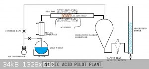

Nitric acid from ammonia Oswalt style (without platnium)
OstwaldStyle NA Process.png-thumb.jpg - 10kB
This process uses urea as a source of ammonia which is heated till it decomposes into ammonia and carbon dioxide, oxygen is added to the system using an Air compressor. A condenser is used to dry the ammonia/air stream. The ammonia air mixture is fed into a Quartz tube with a 8mm ID that is heated with nichrome wire heating element. The reaction chamber contains NiO or CoO as a Catalysis that are supported bed of Sand or a red brick chunks. The ammonia is oxidized to nitrogen monoxide. The Quartz tube runs into an Absorption tower (converted 2L sep. funnel water with broken glass to increase surface area. which admits air via the custom condenser fitting. The absorption tower oxidizes the nitrogen monoxide to nitrogen dioxide which combines with the moisture of the reaction to produce nitric acid. This condensate runs into a reservoir to collect the Nitric acid the excess gasses run to a vertical anti suck back column before running along a small tube to the base of the tower.

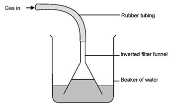

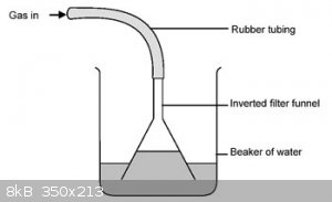

A funnel-and-beaker trap is a device for dissolving highly soluble gases in water. The trick with these gases, such as ammonia and hydrogen chloride, is that they cannot be dissolved in water by simply bubbling them through it: the high solubility results in the water rushing back into the reaction vessel. The funnel-and-beaker trap is used to prevent that.
