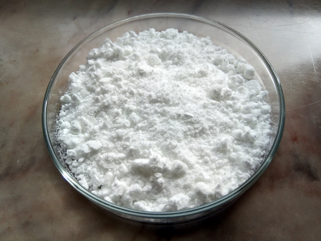

So I gave the evaporation of chlorite solution a go. I measured 100 ml of the 25% NaClO2 solution and started to boil it down. At approximately 1/3 the original volume, the NaClO2 started precipitating from solution. The solution was boiled down until it reached 1/4 of the original volume (it was roughly 25 ml), with some residual water still left. I let it cool down to about 60°C. Now, in light of organics making chlorites potentially shock-sensitive, I took the rather risky move of adding ethanol to the still warm liquor, hoping that it would make drying the product easier by removing some of the water and potentially even precipitate more of the NaClO2 from the liquor (first trying it on a 1 ml sample to see if anything bad happens). Nothing bad happened in the 1 ml sample nor the whole batch, so I continued by collecting the solid NaClO2 through filtration. The ethanol definitely helped somewhat, prior to addition the precipitate was a mushy, unattractive mass, but the ethanol made it a nice, loose and powdery precipitate. After transferring the product to the filtration setup, I washed it a bit more with some cold 96% ethanol. At this stage I decided to test if the powder moistened with ethanol was shock sensitive, just in case. I took roughly 0.25 g and hit it with a hammer on a hard metal surface, nothing happened (but this is no guarantee that nothing bad can happen between dry NaClO2 and anhydrous ethanol, proceed with caution if you decide to add ethanol).
After that I left the product to air dry, stiring the powder occasionally to speed it up. The mass hardened as it dried out, so I broke it up and grinded it with a mortar and pestle (the ethanol had dried out as no scent could be picked up, but I could tell the product didn't completely dry off from the water). The crushed powder was then transfered and weighed. I got 20.31 g, but since I dont think the NaClO2 has fully dried out yet (I might put it in a dessicator bag) this shouldn't be taken as the final yield.
I didn't bother with taking pictures of the setup or the procedure, as it was pretty basic. The solution was evaporated in a 250 ml beaker on a "kitchen" hotplate (yes, I'll upgrade to a proper hotplate with magnetic stirring soon), the product was filtered on a glass funnel with filter paper and a simple water aspirator providing the vacuum. Below is a photo of the crushed up, partially dried product. Looks perfectly white on the photo, but in person there is a very subtle yellowish tint.

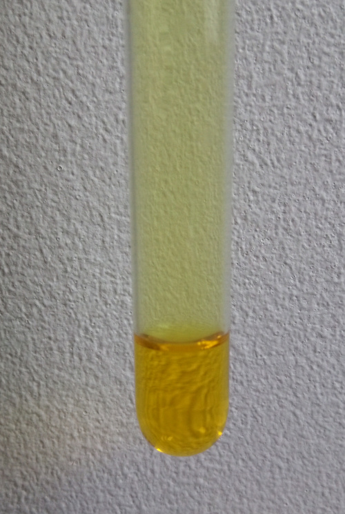

I decided run a few tests to confirm that it is indeed chlorite and not chlorate, for instance. I added the powder to some dilute H2SO4 in a test tube. It made a few popping noises, as the solution turned yellow and some vivid greenish-yellow ClO2 gas collected above the liquid.

I know from experience that NaClO2 is quite stable. I have a 28% solutoin and I left some of this in a petri dish on a warm radiator (50 C or so). After one day I had a white dry crust, which could be scraped off and ground to an irregular powder (some pieces are larger than 1 mm, while there also is very fine powder).
The material definitely is NaClO2 and not NaClO3. On addition to conc. HCl a lot of ClO2 is formed, but there is no smell of Cl2. ClO2 has quite a different smell. With NaClO3 the smell of Cl2 overpowers the smell of ClO2, when it is added to conc. HCl (with NaClO3 you get an appr. 1 : 2 mixture of Cl2 and ClO2).

EthidiumBromide
Posts: 42
Registered: 27-9-2020
Mood: Effervescent
[*] posted on 14-10-2020 at 12:50
Thank you for your inputs, Woelen and Bedlasky.
Indeed the solid chlorite generates ClO2 exclusively. I am familiar with the smell. It's the odor of dichloroisocyanurate based disinfectants so I recognized it immediately. Very smelly, and I'd say even less bearable than chlorine.
I'll probably use up the solid NaClO2 quickly so I won't perform any titrations, but it's good to know that it can be done iodometrically.
