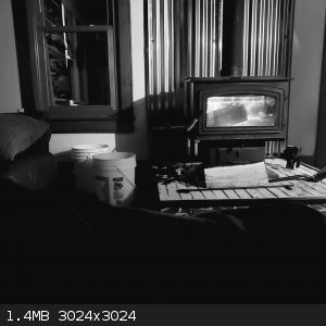

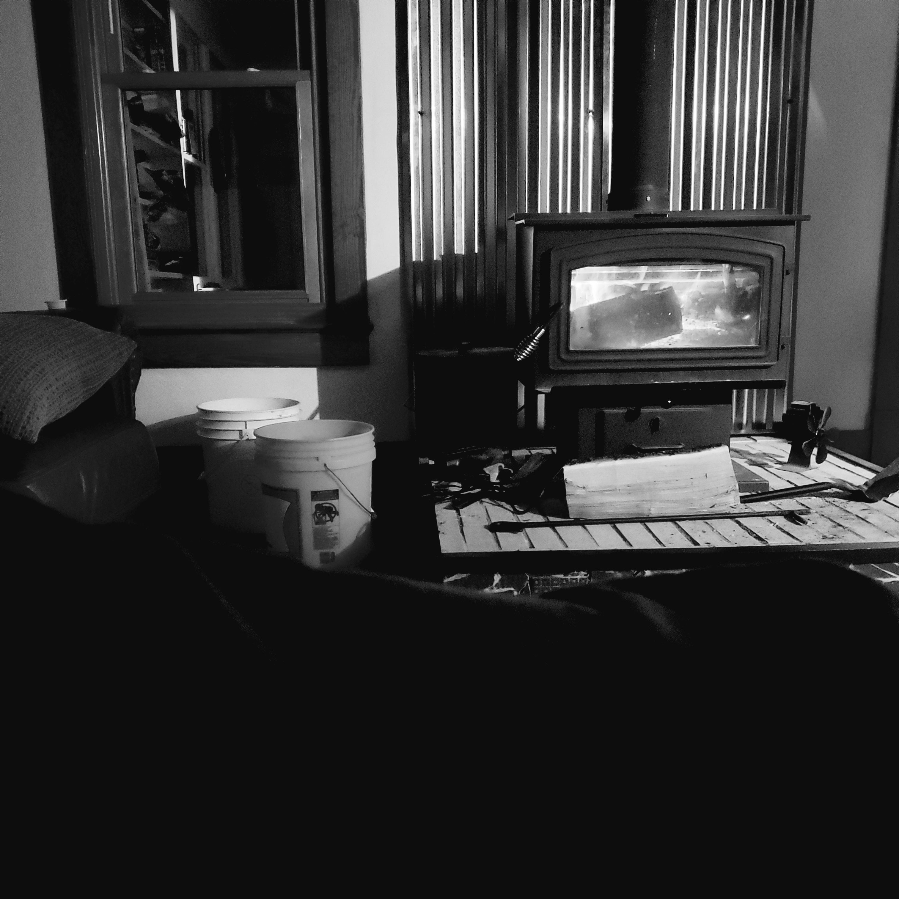

[*] posted on 28-1-2021 at 05:04
Three primary factors in generating heat from a wood stove:
1) fuel source energy density.
2) harvesting heat energy from fuel within living confinement.
3) preventing heat energy escape from living confinement.
All fuel is not equal. Some fuels provide energy at a magnitude of ten in volume when compared to other fuels @ higher energy density. Some fuel would release too much energy. Like thermite, for example.
Personally, I like hedge tree. Maclura Pomifera. Grows fast (relative) in most conditions. Very hot. Can melt metal if oxygenated. Serious Spark hazard in open fire.
8.8M btu/m^3
Other powerful fuel:
Bumelia aka wooly bucket aka chittamwood
Mountain "mahogany"
Both Hotter than hedge which is
To use the heat in a living area, it has to be harvested out of the cycling stream.
Most stoves are a pipe. Heated on one side, exhausted on other. The trick to heating is to harvest the heat by using it as a load.
Masonry is a simple way. Bricks/stone pull heat like a capacitor. The simplest way to make a load in a heating circuit is to just put masonry in contact with hot surfaces. More efficient is to pass exhaust stream into a masonry hollow chamber before exiting chimney path.
For measure of efficiency, exit gasses should be just over the minimum temp to prevent stack collapse/reverse flow, obviously hotter than ambient temp by a margin, but if exit gasses are really hot, heat is pouring out into atmosphere.
Then the heat just has to be kept in the space. That's a matter of confinement materials and the temp differential inside vs out. I can tell you that blocking/disrupting wind from working against building surfaces is paramount and overlooked. Ppl focus on insulation, trying to make a big cooler, what should be done is blocking wind access to building by heavy vegetation or walls.
20210128_061025.jpg - 1.4MB
