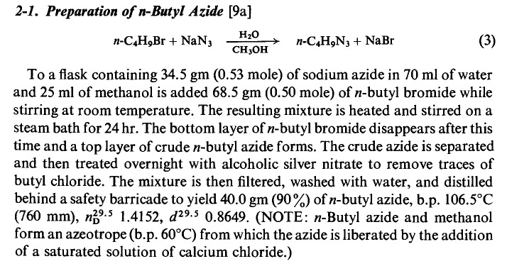

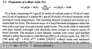

So after about 40 hours at ~60-65C(with s.stirring) - almost none of my n-chlorobutane converted to n-azidobutane...
I roughly followed the instructions from the pic below, only with n-BuCl instead of n-BuBr. I also done none of the weird workup steps, instead I just separated the layers and continued to distillation.
The prep I've roughly followed:
IMG-20200924-WA0000.jpg - 157kB
I recoverd most of the BuCl and NaN3, hoping to try it again in DMSO. But it came to my attention that Cl- has the same nucleophilic strength as N3- in aprotic solvents, so it probably ain't gonna work too.
I probably just gonna make some n-BuBr instead and try again(this time in DMSO from the get-go).
