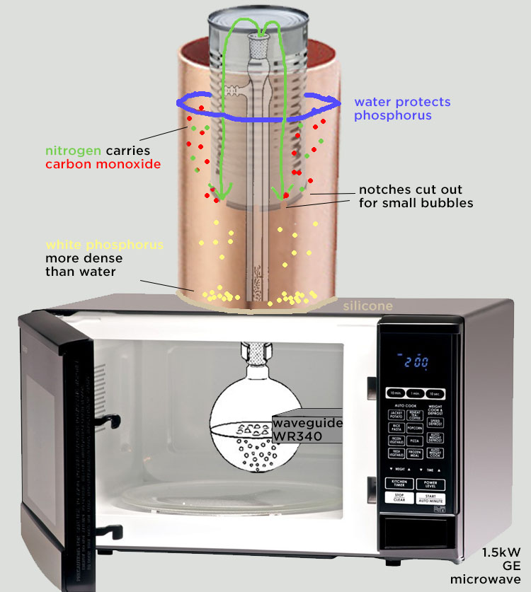

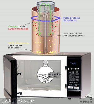

I actually spent about $15 on a 200mm from Chemglass. I did think of a vigreux, but I don't own one and just assumed that an air condenser would be more versatile/disposable if my experiment deforms it. Why would someone use a vigreux over a packed column for fractional distillation? I already own a fractioning column. A jacketed column without barbs would certainly be an improvement though. Let me know what you'd part with it for, Dr. Bob.
I'm using a GE consumer microwave to convert phosphoric acid to phosphorus per US Patent No. US6207024 . I'm pushing the limits of boro, the reaction requiring a minimum of 600C to occur. I will try it, and upon its potential failure switch to a ceramic reaction vessel.
Also the drawing is a very rough one, I won't really use 8-inch copper pipe and a tin can. I'll have proper guards in place for the escape of the microwaves. This image is just to get an idea of the logistics. Also there are aspects of the patent that I do not have the capability to replicate, such as the microwave tuner ($$$). Maybe it will be a complete waste of time, who knows!:P
