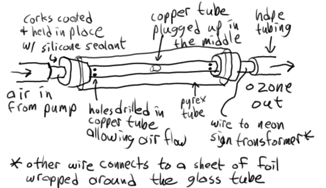

Simplified ozone generator
I designed this ozone generator to be easy to build, since you just need a length of glass tubing (you can use old fluorescent tubes), two corks with
center-drilled holes, a short length of copper tube, silicone sealant, and of course the requisite air pump and neon sign transformer. It just
simplifies construction a little bit since the inlet tube, outlet tube, and inner electrode are combined into one piece. It also allows for a decent
air flow to maximize ozone generation.
Instead of corks, you can just wrap the copper tube with massive amounts of electrical tape so it forms plugs at the ends.

Fluorescent tubes won't be robust enough for your purposes.
And an aluminium rod would make a better electrode - ozone attacks copper and rubber.
The air supplied should be dry; moist air produces NO<sub>2</sub> as well as ozone.

Yeah, I suppose fluorescent tubes would probably be too thin. It'd be simple enough to substitute an aluminum tube for the copper one, although
aluminum tubes may be a bit harder to find. For the glass, maybe a broken graduated cylinder or the neck of a cracked flask could be used. Or just
the right size tube if you can get it. There are also some huge test tubes out there that're like an inch in diameter, that you could cut the bottom
off of and use.

A thick Al welding rod would make a good electrode and a scrap freezer is a source of easily manipulated Al tubing . . .
Teflon is inert to ozone and other plastics may be too, but you'd need to google that!
Commercial ozone generators use SS (416?) possibly.

The most common polymer (plastic) used for ozone handling is less expensive than teflon and is called Kynar (or PVDF). It costs about 20% as much as
teflon and will handle ozone without breaking down.
A compatible rubber material is Viton. It is expensive but will handle a lot of abuse.

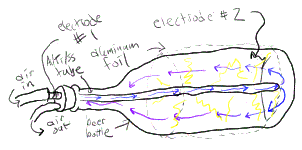

I came up with a new ozone generator concept that uses a beer bottle, a cork, and a metal tube as its components. This is a lot simpler than the
first one, but still uses the inlet tube as one of the electrodes. This one is nicer because you don't have to do anything to the tube besides cut it
the right length, and the glass insulator is just a beer bottle. I should build one of these things and make sure it stands up to the electric
arcing. I think it will though; beer bottle glass is pretty thick.

If you have glassblowing skills you might try to strengthen the ends of fluorescent tubes so that they could take strain stoppers would exert.
Propane is good enough for soda-lime . . .
Failing that, find a friend who can work glass!

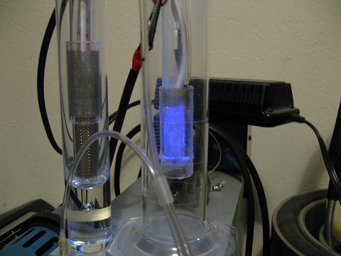

roamingnome
Posts: 363
Registered: 9-9-2006
In any design, it comes down to the dielectric material used. It will probably fail first producing a direct short.
These simple pyrex test tubes as dielectric will probably fail mid experiment if left running continuously. I hope pulsing them on/off will preserve
them.
![Ozones.JPG - 31kB](http://www.sciencemadness.org/talk/files.php?pid=203342&aid=13226)
The oxygen tube enters the bottom of the test tube passing up threw the corona

hissingnoise
Posts: 3940
Registered: 26-12-2002
Mood: Pulverulescent!
My archaic BE generator consisted of an enclosed Jacob's Ladder driven by two NSTs in parallel.
Its output was bubbled into water and after several hours running I got very dilute acid.
To reach 68% the thing would have to run for a friggin' year!
The problem is that the concentration of NO<sub>2</sub> in the output is so small that to capture all of it large, complex absorption
towers would be needed.
