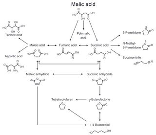

Furthermore, malic acid seems to be an interesting precursor to whole host of important compounds, such as succinic, fumaric, tartaric and other acids, their anhydrides and several solvents such as butyrolactone and THF:
SynjJQ7m.png.jpg - 11kB
Source: Kövilein, Aline, et al. "Malic acid production from renewables: A Review." Journal of Chemical Technology & Biotechnology.
The above image does not contain direct arrow from malic to maleic, instead it shows two routes:
malic -> fumaric -> maleic
malic -> succinic -> fumaric -> maleic
