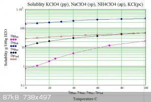

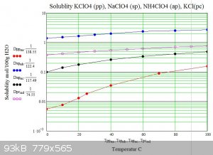

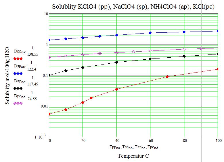

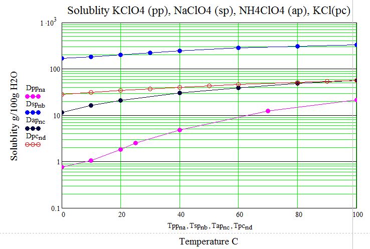

Below are graphs of the solubility of sodium potassium and ammonium perchlorates in water versus temperature. For comparison potassium chloride is
also shown.
The graphs show how potassium perchlorate has approximatly 200 times less solubility than sodium perchlorate at 0C. .
The usual double decomposition synthesis requires that the target salt is insoluble or has the lowest solubility of the reactants and products of
the decomposition at some temperature. As can be seen from the graphs ammonium perchlorate has three times the solubility of potassium perchlorate at
any temperature hence water solutions can not be used to produce ammonium perchlorate from potassium perchlorate in the usual way.
