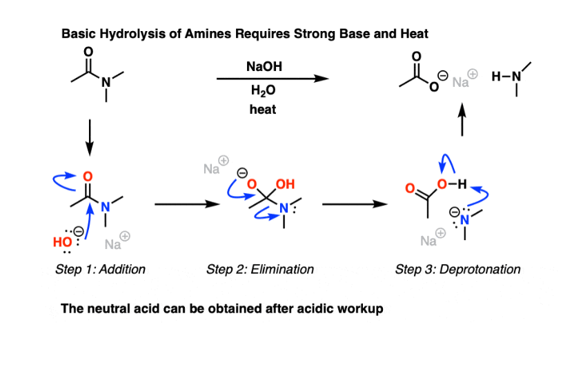

Posts: 3026
Ever had a look at that mechanism? It doesn't use water.

@EM I have since carried out the reaction, and it was quite successful, however it did quite a bit of damage to the flask.
I have a write-up on the way in case anyone is interested, should be ready soon.
Yeah it isn't hydrolysis, but then again, many reactions are called "hydrolysis" even though the main reaction taking place doesn't involve water.
For instance the "hydrolysis" of an ester, or an acyl halide, with dilute NaOH.
The hydroxide ion is so much more nucleophilic than water, so the water will hardly participate at all, but it is convenient to call it hydrolysis.
The DEET reaction, however , can be more accurately called alkaline decomposition ![:D](./images/smilies/biggrin.gif)
@tsjerk I think the reaction mechanism involves nucleophilic attack on the amide carbonyl, resulting in an amide anion as a leaving group.
The amide anion is a stronger nucleophile than hydroxide, so the reaction requires forcing conditions such as an excess of alkali, or distillation to
remove the amine...
I hope I'm right, I spent long enough working on this reaction!
Posts: 3026
Hydrolysis can occur without water, sodium hydroxide dissolved in some other solvent will do the trick just fine. Hydroxide is just deprotonated
water.
![hydrolysis.png - 73kB](http://www.sciencemadness.org/talk/files.php?pid=684103&aid=98244)
https://www.masterorganicchemistry.com/2019/10/07/amide-hydr...

Quote: Originally posted by Tsjerk ![](images/xpblue/lastpost.gif) | Hydrolysis can occur without water, sodium hydroxide dissolved in some other solvent will do the trick just fine. Hydroxide is just deprotonated
water.
The hydroxyl ion your saying would pass muster.
Water being present certainly wouldn't hurt.
