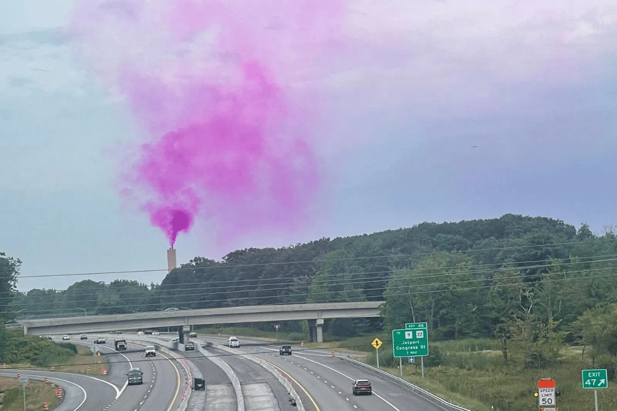

mayko
Posts: 1218
Registered: 17-1-2013
Location: Carrboro, NC
twice in as many days!
Iodine cause of pink smoke at Portland waste facility. (3 Aug 2023)
Quote: | Waste that contained iodine was the cause of pink smoke that was emitted at Ecomaine’s Portland waste facility on Thursday morning.
https://web.archive.org/web/20230805163131/https://www.bango...
Purple vapor continues to billow out of Portland waste management facility (4 Aug 2023)
Quote: | PORTLAND, Maine — For the second day in a row, mysterious purple vapor is once again billowing from the smokestack at Ecomaine’s waste management
facility in Portland. [...] Ecomaine said on Friday they believe it is still iodine and are taking steps to address it. Ecomaine burns around 170,000
tons of commercial trash a year. Customers are reminded to properly dispose of their trash. |
