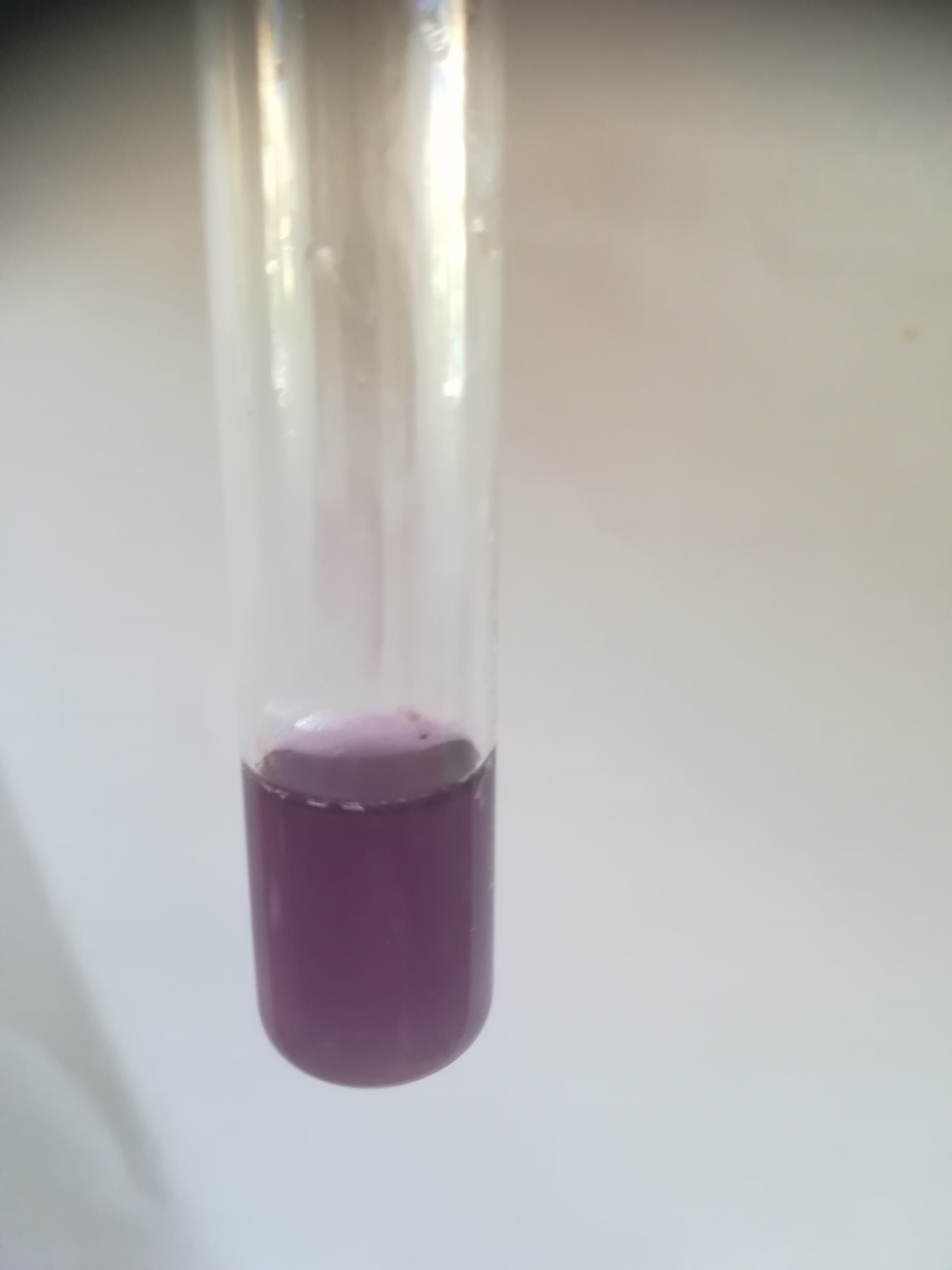

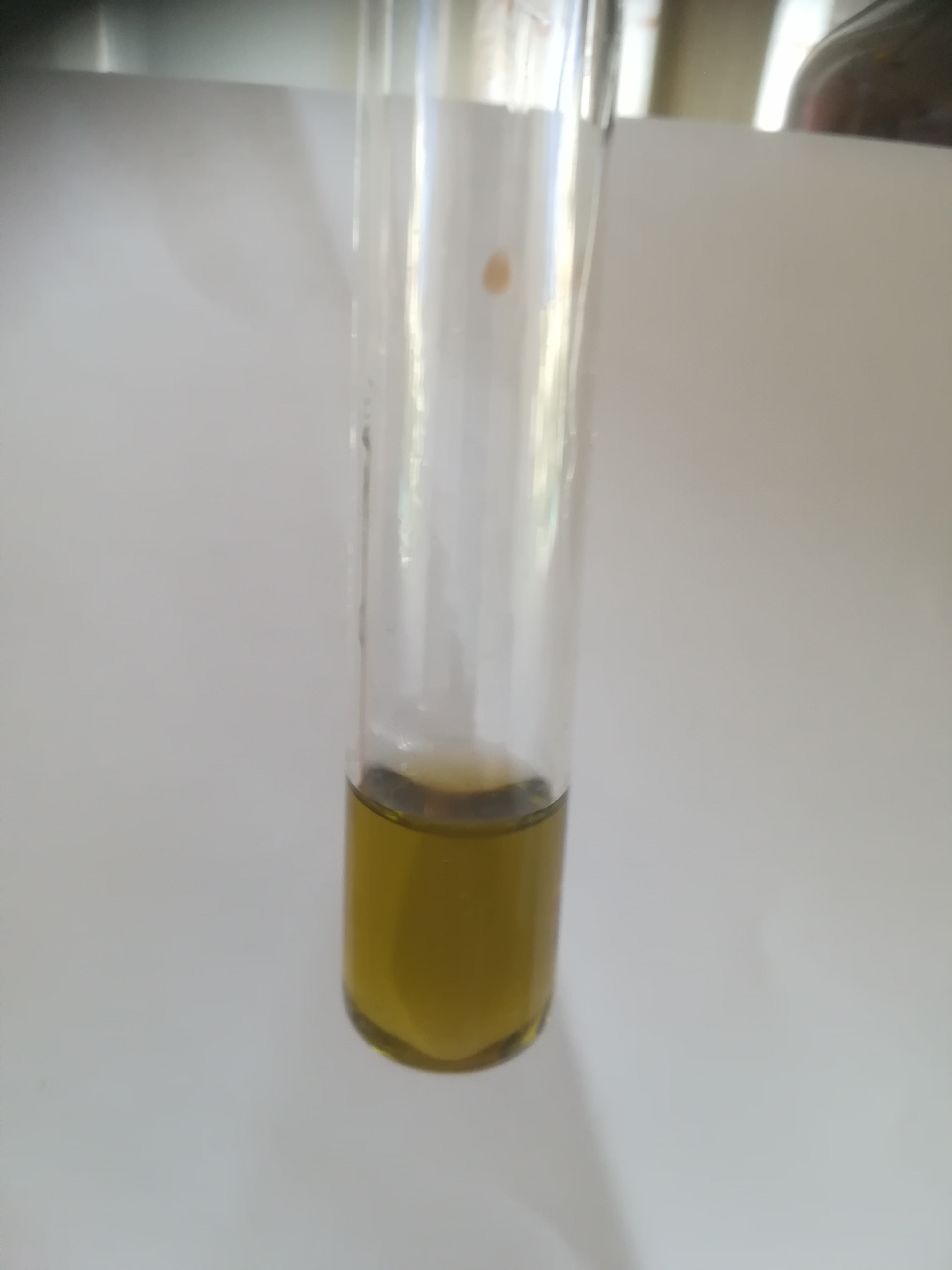

[*] posted on 30-6-2019 at 10:20
So I tried prepare these two hexaaqua ions and here are results:
I dissolved small amount of manganese sulfate in two drops of water. After that I added two mils of concentrated sulfuric acid. Little bit of white precipitate was formed. Then I added drop of potassium permanganate and swirl. Solution turned colour in to violet. I added another drop of permanganate for more intense coloration. This colour was caused by bridged complex ions [(H2O)4Mn(SO4)2Mn(H2O)4]2+; [(H2O)4Mn(OH)2Mn(H2O)4]4+ and [(H2O)4Mn(H2O)2Mn(H2O)4]6+ along to [Mn(H2O)6]3+.
I tried similar experiment with cobalt sulfate and hydrogen peroxide, but oxidation didn't take place.
IMG_20190630_171551.jpg - 1.1MB IMG_20190630_171633.jpg - 1.7MB

Posts: 8027
[*] posted on 2-7-2019 at 11:19
As a side check, I would also try adding a few drops of dilute permanganate solution to conc. sulfuric acid. This should give a green solution. With the manganese(II) it gives a violet solution. I just want to be sure that the violet solution is not just very dilute permanganate.
Try this experiment if you have the chemicals. It really is interesting:

[*] posted on 2-7-2019 at 13:13
Woelen: I tried add only potassium permanganate to conc. H2SO4 after I this experiment firstly made - I expected green colour too, but it was rather brown-green (see the picture). Violet colour was caused certainly by Mn(III) complexes. I downloaded text about preparation of Mn(III) in conc. H2SO4 and H3PO4 on this link if you interested: http://downloads.hindawi.com/journals/jchem/2009/736463.pdf
IMG_20190630_170929.jpg - 1.3MB

Posts: 8027
[*] posted on 3-7-2019 at 11:22
@DraconicAcid: You're right, the complex could be something based on HPO4(2-) or H2PO4(-). I did not isolate any solid. I simply did not think of the acidic ions of phosphate.
@Bedlasky: Nice that you do all these interesting experiments. These experiments also urged me to do some experimenting again, despite my very small amount of free time for this ;)
I first dissolved some MnSO4.H2O in concentrated H2SO4. Quite some heating is necessary to get it dissolved. The solution is colorless. I let the solution cool down to allow safe addition of water to this solution.
I took a single drop of a solution of KMnO4 and added this to the cold solution of MnSO4.H2O in H2SO4. This indeed gives a violet solution. The color is not really bright, it is a somewhat dull color. The left picture with the off-white background quite well shows the color of the solution.
Next, I took a small amount of the colorless solution of MnSO4.H2O in H2SO4 and added a little solid KNO3. I started heating gently. The KNO3 fairly quickly dissolves in the acid and at a certain point in time, the liquid turns violet. The color is very similar to what I get with addition of KMnO4. Now, I can get a more intensely colored solution, because in this experiment I could add a little more KNO3 without adding too much water. On stronger heating, the violet color goes away again. It becomes brown and it also fades, I see bubbles of gas, the nitrate/HNO3 boils off, but also decomposes. Brown gas is formed above the liquid. On shaking, the brown gas reduces part of the manganese(III), the color fades.
When this experiment is compared to the one I did with H3PO4, then there is some similarity in the observed reactions, but with H3PO4, the color of the produced solutions is much more brilliant. With H3PO4 you get a really beautiful, highly saturated purple color.
I repeated the same experiment with Mn(CH3COO)2. With this, I did not get good results. The acetate ion, which is quite stable and not strongly reducing in aqueous solutions, it fairly easily oxidized in the strong H2SO4. With KNO3 added, on heating there is quite a lot of production of gas. I obtained a violet solution, but almost instantly, when the color appeared, it also faded again and there was a vigorous production of colorless gas, mixed with a small amount of brown gas.
These experiments convinced me that indeed compounds of manganese(III) are formed in the strong H2SO4. The color of the Mn(3+) is different from the color in H3PO4. This almost certainly is due to the different coordinating environments.

[*] posted on 8-7-2019 at 11:53
Nezza: Carbonate complex have nice colour :).
Woelen: I've got an idea why is MnO3+ ion brown-green instead green if you make it from permanganate solution and conc. sulfuric acid. Maybe this ion partially decomposes in to MnO2 and O2/O3. Maybe it would be more stable in super acidic media (for example in oleum or H2SO4/H3BO3 system - these are most common superacids).
[Edited on 8-7-2019 by Bedlasky]
