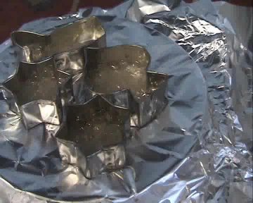

A hotplate is covered with aluminum foil and set to 200°C. The cookie cutters are placed on it. A CD cover is broken into small pieces.
xmas1.JPG - 26kB xmas2.JPG - 13kB
The pieces are put into the cookie cutters. After about 90 minutes there should be a more or less even melt.[2]
