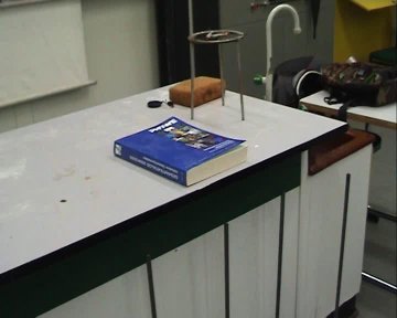

Experimental
A hole is cut into a big catalogue. Into the hole there are placed approx. 10 g of potassium permanganate.
Buch1.JPG - 17kB Buch2.JPG - 18kB
Approx. 10 ml of glycerine are put on the potassium permanganate. The catalogue is then closed and left untouched.
Buch3.JPG - 18kB Buch4.JPG - 16kB

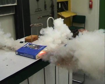

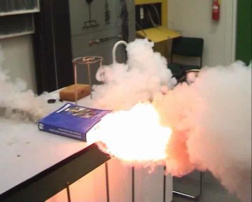

After about 40-50 seconds the catalogue starts to smoke and to burn.[2]
Buch5.JPG - 17kB Buch6.JPG - 16kB
The inside of the catalogue is still glowing after the flames have ceased.
Buch7.JPG - 18kB
