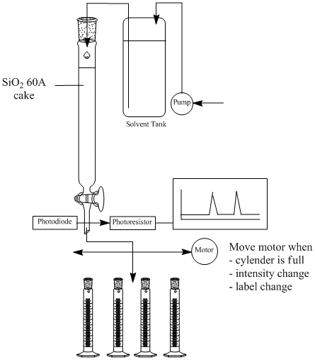

1st : Automation for chromatographic colum
Chromatography column often use plenty of test tubes to separate compounds. To do this you have to stay hours while watching your material purifying
drop to drop. Test tubes have to be changed manually every 1 minute that let you no time to do anything else.
Filling solvent and distributing product can be managed automatically easily
Other upgrade is setting a detector at the end of the column. UV LED and UV sensitive resistor (or Infrared) can easily detect a compound that is
passing through, because many organic compound are not transparent to UV. Then the separation of the compounds are easy monitored.
like an autosampler, a test tube holder in the shape of a disk (so only 1 axis and a rotary action is enough) with the holes in a spiral pattern, or
simply concentric circles. a servo to rotate the disk and one to move the entire disk radially under the column (to change rows), a timer and done
brubei
Posts: 188
Registered: 8-3-2015
Location: France
Quote: Originally posted by Ubya | like an autosampler, a test tube holder in the shape of a disk (so only 1 axis and a rotary action is enough) with the holes in a spiral pattern, or
| I'd love to learn arduino to build this.
