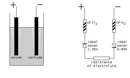

Thank you Woelen, Gentlemen!
Woelen I particularly enjoy your model of the chlorate cell as the following:
model.gif - 6kB
[Edited on 30-3-2019 by Simoski]
