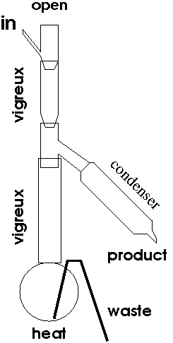

Have you seen drawings of countercurrent continuous stills? Very simply, it's a vertical column with side outlets over a heated pot with an outlet. The feedstock is continuously run in from the top and is heated by rising vapor. Once the system stabilizes, there is a temperature gradient hottest at the bottom and coolest at the top of the column. At the point where the desired product condenses, the vapor or condensate (depending on design) is taken off. The waste is continuously removed from the pot.
Here's a rough sketch of something one might put together out of reasonably standard glassware. The input rate would need to be controlled along with the heat to keep the takeoff point just above the boiling point of ethanol. Wrapping the whole assembly with some form of insulation is probably necessary to keep the gradient constant: aluminum foil as a heat reflector, glass wool/foil would be better. The input flows down the side away from the takeoff point.
A second, higher takeoff might be necessary to condense and discard the more volatile fractions so they don't accumulate in the column or leave at the top making an explosion hazard or poison the operator. :(
cont-still.gif - 3kB
[Edited on 23-11-2009 by densest]
