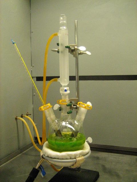

[*] posted on 19-10-2010 at 14:44
Quote: Originally posted by entropy51
BTW entropy, you will be glad to know that I'm now tending a little batch of sulfanilic acid per Brewster.
Yes! I finally ran a Brewster prep before Magpie.:D
I'm sure you will get a higher yield, however.:(
Did you distill your aniline first? If not, your product may be a tad off-color.
I'm not so sure about that yield. I got lazy and am just using antifreeze straight out of the jug as heat transfer fluid. The stuff bumps! Next time I will use purified ethylene glycol.
Lazy on the second count also - did not distill my amber aniline. I just want enough good product to make some methyl orange. I'll post a picture on edit.
Edit: The thermometer is reading 160-162C.

entropy51
Gone, but not forgotten
Posts: 1612
Registered: 30-5-2009
Mood: Fissile
[*] posted on 19-10-2010 at 16:11
It will bump less if you put a little stir bar it, or at least that's true when distilling antifreeze.

[*] posted on 21-10-2010 at 18:53
Here's some preliminary results on the sulfanilic acid synthesis I began earlier this week. As I indicated I used antifreeze straight out of the jug as heat transfer fluid for the heating period. This boils at 166C so I did not get the high soak temperature of ~195C that I would have if I had used pure ethylene glycol. I tried to make up for this by using a long (8 hour) soak time.
At the end of the soak the product was poured into a beaker of crushed ice as shown below. This resulted in the precipitation of a somewhat gummy suspension. This was then placed on a 7cm Buchner and pumped dry, saving the filtrate. The solids were then redissolved in hot water and some activated charcoal added to remove some slight discoloration. This could be described as a very light red or purple. Suspecting that a lot of product was in the filtrate from before I added this to the hot water solution followed by a little more charcoal. This was then heated to boiling and filtered to remove the charcoal.
The filtrate flask was then cooled in an ice bath and the gummy product recovered on the Buchner funnel. It was washed with 5mL denatured alcohol. Then it was placed on a dinner plate to dry at 55C. Then I turned up the oven to 80C. After several hours it was still gummy. It was then placed in a desiccator over CaCl2 (per Vogel). After several hours I weighed it at 15.4g (see 2nd picture).
Tentatively assuming this is sulfanilic acid dihydrate, the yield would be 68%. I'm suspecting that I didn't get it washed well, especially in regard to residual sulfuric acid. Monday I will recrystallize it and try to isolate a more pure sulfanilic acid product.
