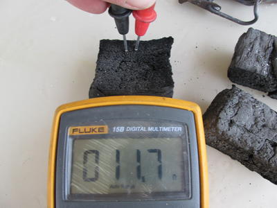

[*] posted on 4-3-2018 at 09:38
For anyone interested in using this bread/carbon stuff structurally, the average shrinkage during pyrolisation came out at 27% today.
3 chunks of home made bread were measured, pyrollised in a charcoal fire, then re-measured.
Again the resistance is quite low this time measuring 11.7 ohms in a point-to-point test.

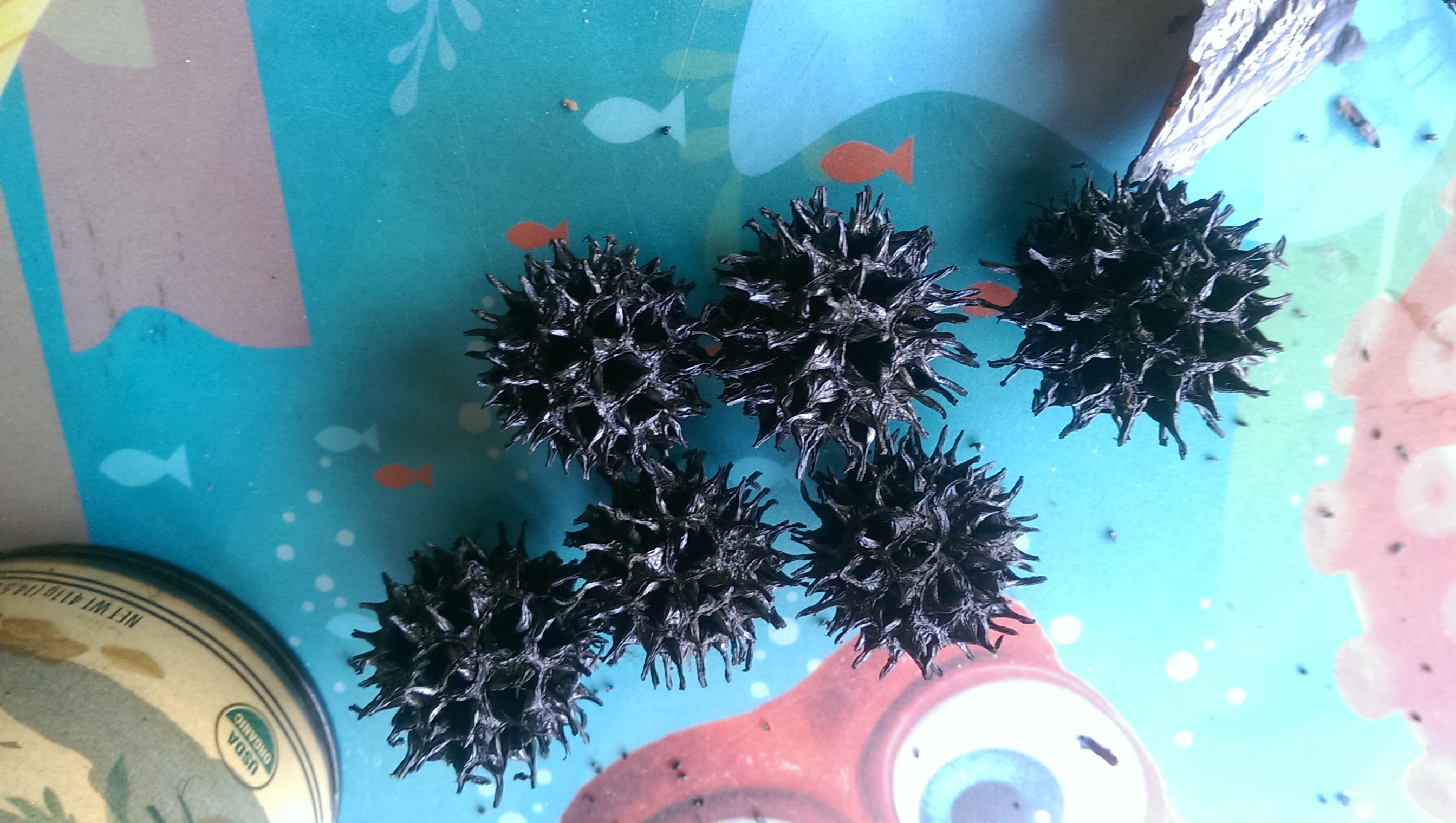

[*] posted on 16-4-2018 at 03:54
Tried a second firing on the sweet gum balls, not measured first time. One trial of two balls lost 5.26% more on second firing. Not a tremendous amount and the shape/size distortion was minimal. Though I did not get a caliper on them during any of this.
IMAG5392.jpg - 836kB ^ v IMAG5391.jpg - 980kB

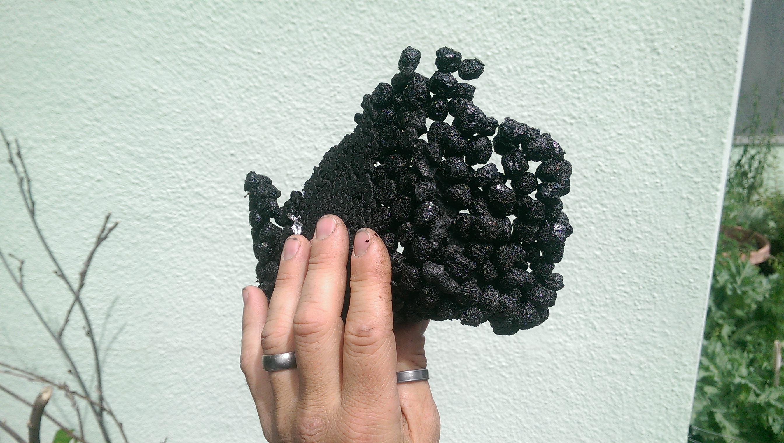

Ok so the preform did not work... It easily could work, but this time was no. The whole top portion was stuck in one chunk (nicely), further down was not so. The gluten/sugar mix was not evenly spread despite misting the cereal and folding the powder in. When the cup came out, part of the lower char came dislodged and fell in the recess.
Frosted cereal would be far more convenient or just some kind of rice crispy treat like mixture. The forms are nice and so far seem well suited to my goal.
IMAG5469.jpg - 1.1MB IMAG5470.jpg - 1.2MB IMAG5471.jpg - 1.3MB
So after all this playing around with carbon char foam, and a wide field of possibilities, I narrowed down to one goal. At least first off. I want to play with high temp fun, I don't want to buy ceramic fiber blanket for the prices I've seen... So refactory foamy insulation it is. For a quick and dirty project to test these materials, I wanted to do something like a heating mantle-ish set up.
I know it's more professional to come to the table with a finished product before revealing your plans.. but I literally don't care if I fail here, in fact I'm sure I will, many times at the very least. Lol.
Basic plan is to cast a rough shape as seen above. True up the sides, trim and shape the thing. Then either paint it or wrap and refire it and then paint it with ceramic or plaster etc. Install a through way for wires and standoffs for the element.
I could easily see a small mantle for my 14/20 set taking shape with enough effort. But really the possibilities are immense. Electrodes, catalyst support, insulation... It's wide open. Best to pick one and optimise.

[*] posted on 22-4-2018 at 14:17
Newest test run, same steamer insert form and ss cup center form.
IMAG5518.jpg - 1.3MB IMAG5521.jpg - 1.3MB
-(Pic 1): New kind of frosted puff cereal cap and rice crispy (w/ starch/sugar binder) side shot
-(Pic 2): consequence of over fill was cooking on side = separation rift largely empty.
IMAG5527.jpg - 1.3MB IMAG5533.jpg - 1.4MB
-(Pic 3): Side shot of strata. Was surprisingly TENACIOUS grip on the center form cup,
-(Pic 4): frosted chunks, sans adulterants, really hold shape with minimal contact.
IMAG5540.jpg - 866kB IMAG5507.jpg - 882kB
-(Pic 5): rice crispy preform from center cup, shrunk a lot, but I did add a fair amount of water to make moldable consistency.
-(Pic 6): removed chunk of last experiment.

Someone brought some nasty BlunderBread hamburger buns to my 4th of July cookout and they've been sitting in the fridge since. Finally, a use for them!
These sat in my freezer until last week. They were dehydrated when I pulled them out. I wrapped each of four in Al foil and stacked them in a steel can, which was then half-buried in a charcoal fire.
Once cool and unwrapped, I found tough, surprisingly strong carbon foam slices. They were much lighter, from ~60% to ~25% of the starting mass of ~34.4g. The bottommost foam was not only the lightest, but the only one for which I could find a detectable (ie, finite) resistance.
Code:
mass (g) resistance (Ohm/cm) Top 20.41 - 13.59 - 10.36 - Bottom 8.22 35k
I can think of at least two possible explanations: heat gradient (hotter at the bottom) and redox gradient (more O2 at the top)
