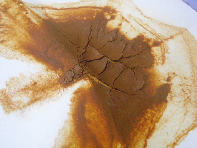

These make me confuse:
Yesterday,I decided to conduct a couple of experiments with my sperrylite (PtAs2) mineral.
1.I put about half a gram of PtAs2 in nitric acid.Then I heat it.Sperrylite react with warm concentrated nitric acid producing a yellow solution.Then I add few milimeter of ammonium chloride solution,hoping that ammonium hexachloroplatinate will be precipitated.But nothing happen.
I guess ammonium hexachloroplatinate only will be precipitated if ammonium compounds solution is added to chloroplatinic acid.While I might have platinum nitrate in the yellow solution.So,I add magnesium ribbon,hoping that platinum metal precipitated out.It first bubbled,then a brownish orange compound start to precipitated. Here is the picture of it:
P4092331.JPG - 122kB
I can't figure what compound it is,so I set it aside and conduct other experiment:
2.I react PtAs2 with aqua regia,then I add ammonium chloride.But no ammonium hexachloroplatinate precipitated.Then I add sodium bicarbonate to the solution.It first bubbled,releasing carbon dioxide.Then a brownish orange compound start to precipitate.The colour is similar to what was precipitated in the other experiment.Here is the picture of it:
P4092332.JPG - 141kB
So,what is these thing actually?I guess it would be either platinum dioxide monohydrate or sodium platinum chloride.But I also doubt it is an arsenic compound.
And,if this is platinum's compound,roasting it should turn it to platinum metal right?
