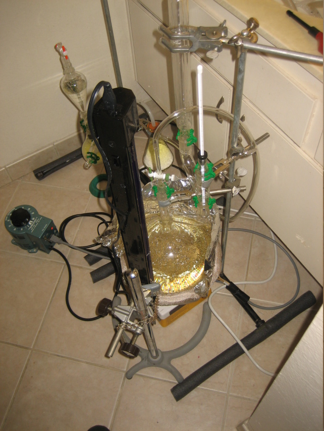

[*] posted on 12-1-2011 at 17:34
I attempted free radical chlorination of toluene as per lien1's post here:
https://www.sciencemadness.org/whisper/viewthread.php?tid=10...
Instead of using a mercury vapour lamp I used a blacklight. As you can see from my previous post, I was quite confident that the blacklight would work because although the light is less intense it is indeed within the specified light spectrum. Post chloronation a fractional distillation was commenced with an insulated snyder column at atmospheric pressure. After the toluene finished coming over the thermometer climbed up to about 163 and there it sat until the temperature climbed to about 190. At around 190 some high boilers started condensing which were a blue/violet colour. My experiment failed to produce products which are consistent with free radical chloronation conditions. Per Organic Chemisrty 2nd edition by Morrison and Boyd p. 386 the products synthesised are consistent with chloronation in the dark.
[Edited on 1.13.2011 by slinky]

That sucks, what a waste of time for you, i think the light intensity from black light is fairly pathetic, also borosilicate will absorb around half your UV leaving you with not much happening. Buy a merc vapour globe and ballast, 250-400 watt is good. If it has a white phospour as most do you need to simply remove the outer glass shell with a careful scratch and tap then run the bulb with the outer shell. removed, it generates lots of ozone and will sun burn you within minures so have yourself protected from this. Get the globe as close as possible to your condenser, remembering this reaction occurs in the vapour phase. If you do not notice the bp going up significantly during the process something is wrong

Thanks panache, I have a large ballast on the way. It should be arriving within a few days. I'd have to agree, the intensity of the blacklight was very weak compaired to a mercury vapour bulb. I thought that allthough less light was given off the fact that all of the light given off was within the desired spectrum would be make the blacklight sufficently powerful and a safer higher efficency route. I was incorrect.
Thanks for the tips regarding the bulb. I'll likely use a transparent bulb. I'm thinking about cutting a hole in an extra large stainless steel mixing bowl so I can mount the bulb to the center of it. The mixing bowl will serve a dual role acting as a light shield for me and acting in the same manner as a parabolic dish. By adjusing the location of the bowl I will be able to concentrate the bulk of the light/heat energy to a small focused area within the refluxing toluene.

Working with chlorine outside of a hood is fine so long as you respect the chlorine and HCl and capture it correctly.
When I first started chloronating the toluene I had a thin glass tube bubbling the offgassing HCl through a 10% NaOH solution. A lot of the HCl was not reacting with the NaOH and escaping with this method. I remembered that Lambda-Eyde used an inverted glass funnel to capture bromine fumes in the bromine thread.
https://www.sciencemadness.org/whisper/viewthread.php?tid=69...
I promptly switched to the inverted glass funnel and placed a heavy flask weight around the neck to keep the funnel submerged in a deep NaOH solution. This worked great. The sunken weighted funnel causes the HCl to have to push down hard on the surface of the NaOH in an effort to escape. I adjusted the chlorine generator drip rate (about 2 drops per second ) to the rate that the solution could accept the offgassing HCl. There is no bubbling at all in the scrubber once the atmosphere within the glassware becomes saturated with HCl. This works much better than a tube bubbling imo. I just checked the PH from time to time and added more NaOH as needed.
[Edited on 1.14.2011 by slinky]

It is most important to realise that although specular reflections produce a clear image in the surface of the material, the actual amount of light reflected may be deceptively low.
A matt white painted surface, for instance, has a reflectance of 85% to 90% compared with only 60% specular reflectance from a polished stainless steel surface, while polished aluminium will be approximately 85%.
Source: http://www.thornlighting.co.uk/gb/en/res_radiance_reflection...
Aluminium is indeed a superior reflector to stainless steel. These aquarium guys take reflectors seriously because their lights are running so often that they can't afford to lose a few % of reflectance.
Here's a breakdown of what surface textures and finishes reflect well or not and their prices. http://anomet.com/cgi-bin/online/storepro.php
In the end I decided to go with a matt white painted surface. It should protect the metal from corrosion the best and can be reapplied. If were to use aluminium it would likely corrode and destroy the high polish eliminating the reflector's efficiency. Matt white's performance is comparable to aluminium and is much better than stainless steel.
