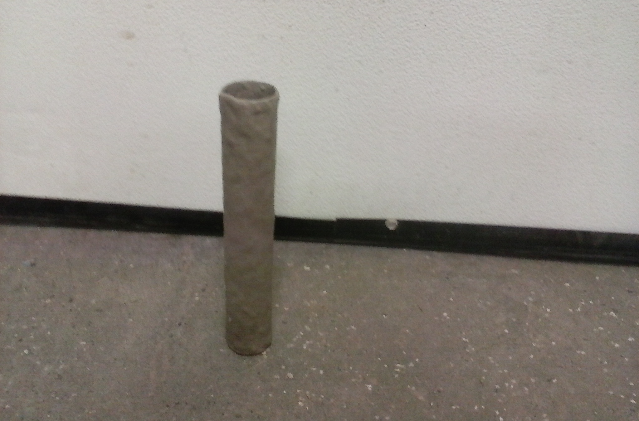

Here is a stoneware tube that I made by putting successive layers of slip onto cardboard. It is crudely constructed, will shrink when fired, and is
surely not as heat resistant as fused alumina or pure mullite, but I think it will do the job.
[Edited on 28-3-2016 by JJay]
The stoneware tube is performing well so far. At maximum power (slightly over 300 watts, considerably less than the ones I made previously), it is
glowing yellowish orange, and the inside of the quartz tube inserted into it is has a peak temperature of just under 700 C. The stoneware shrank
slightly when heated, which was expected. Also, the cardboard tube burned to ashes.I'm going to try to pick up some rockwool tomorrow to see if I
can't heat the stoneware to cone 10 without a kiln.
I let the apparatus cool all night, and this morning discovered that while it has maintained its form, the tube is cracked pretty severely. In a
couple of places, the cracks actually go all the way around the tube, so I had to handle it carefully. There are a few reasons as to why these cracks
occurred.. for one, it was constructed by an amateur who has never done any pottery. Also, the tube was made with unadulterated high-firing stoneware
clay flour (adding grog, which is flour made from fired clay, would probably reduce cracking). In addition, the tube was not kiln-fired prior to
winding it with nichrome.
I sealed the cracks with slip, which is now drying. I'll heat it again later. It will probably crack some more but less severely.
And I just realized that rockwool will melt at around 1200 C, so I'm not going to be able to reach cone 10 (1330 C) with it.
Vermiculite starts to sinter at cone 10 and might work as insulation in a pinch... I feel like a caveman working with these primitive materials....
