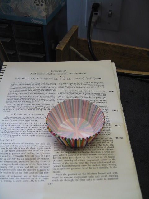

[*] posted on 24-3-2016 at 15:41
Here's a simple idea for cheap weigh boats. I grabbed these muffin papers when my wife wasn't looking::D

That is the epitome of "Why didn't I think of that?"! Good show.

My wife had the same problem Magpie, now when she needs them she buys 2 packets, your wife will catch on too

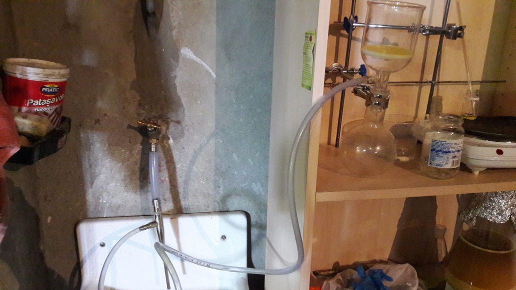

[*] posted on 25-3-2016 at 01:08
filtration for less than 15€, no problem of corrosion or flammability.
20160325_100125 - Copie.jpg - 232kB
Posts: 3620
[*] posted on 25-3-2016 at 07:10
Aspirator, flask and funnel for 15 euro ?
where ... I want one.
brubei
Posts: 188
Registered: 8-3-2015
Location: France
[*] posted on 25-3-2016 at 07:28
Sorry, I talked about the vaccum system :D instead the use of electric pump wich can be damaged by solvent or gaz
[Edited on 25-3-2016 by brubei]

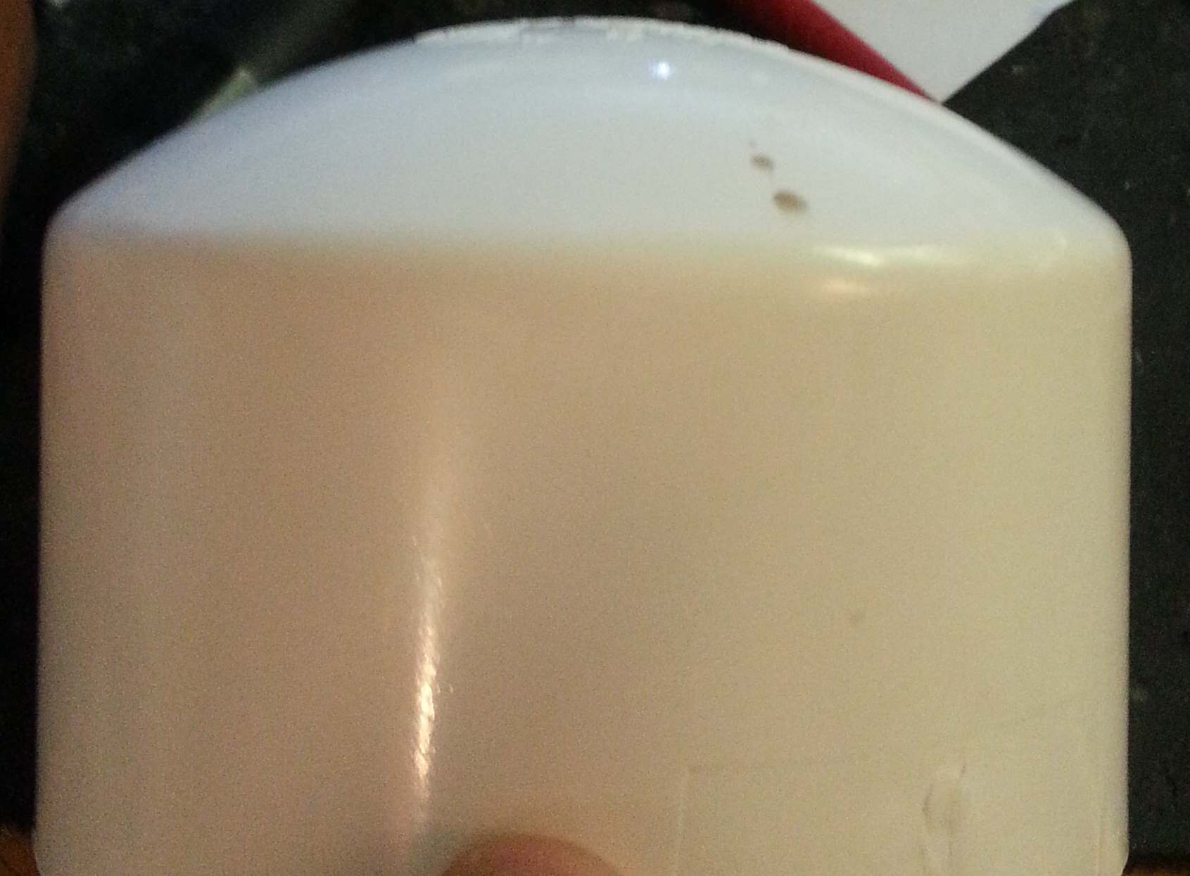

Imporvised Buchner Funnel
I need something I can use for vacuum filtration and a Buchner funnel the size I need is kind of pricey and I have a tendency to break things I need so I came up with an idea I want to run by you guys to see if it should work.
I took a 3" CPVC endcap (hole size is 3.5" actually) and drilled some holes in 1/16" ABS sheet that is cut to sit in the endcap. The endcap has a ledge about 1/8" from where the curvature starts on the end and the filter plate sits on this. I am not certain if I need to glue the plate to the cap but I suspect I will get better results should I do this.
Now the cap has no hole in the end ATM but I plan on drilling a hole and putting a plastic nipple on it sunk into the plastic. As the end is concave, a hole in the center, counter-sunk, should allow liquid to flow down the hole easily. A hose (4-12") will attach to the collection vessel which is an air-tight pipe with a port to connect the vacuum.
Now my biggest question is the capacity of the funnel. Curently there is about 300-350ml capacity using just the endcap. I can glue on a container to act as a larger holding resevoir but I'm not sure if that causes a problem with filtering solids (large mass blocking vacuum filtration..?)

Leaving it unglued makes for easier cleaning. I would leave it like that if it functions ok.
Looks like a good bit of gear. Drilling of all those holes looks tedious. I see no reason why your plan wouldn't work -- subject to the limitations of PVC as a material of course.

As to the depth theoretically there is no limit depending on how long and powerful the vacuum pump is, but for practicability I'd wager there is a formula for the bottom surface area per given height.
For simplicities sake, I'd leave it as is and divide the batches.
for your next one I'd keep the holes centered around the middle and leave more dead space around the outer edges say 5 to 10mm or so.

Pretty cool. Avoid holes at the edges, though. These will allow for channeling of sample through a paper or celite pre-coat. I'd also watch the size of the holes. If they are too big, your paper will suck through them and break.
If you want to semi-temporarily seat your filter support (and seal those holes at the edges), some RTV silicone would work well (it's fairly inert when cured, stable at higher temperatures for hot-filtration, and can be cut loose with a blade).

Thanks for the replies. I plan on filling in the outer holes with some glue of some type. I drilled them out before I knew the inner diameter of the circle so all in all, I stayed pretty well inside of the outer perimeter!
The holes took about 15 mins to drill with one of those electric screwdrivers with a chuck bit attached.
I'm thinking of adding an O-ring to either the plate or the bottom ring of the end cap. If I can make it perfectly flat I should be able to remove the plates yet allow them to seal well when in place.

I did this with a cut off soda bottle and a yogurt container, the biggest problem is connecting the body with the 'sieve'. Leaks open constantly, epoxy is the shit.
Posts: 2683
[*] posted on 4-5-2016 at 03:59
That is a neat idea, and might be good for teachers who need lots of cheap simple apparatus. They will be fine with water but not many organic solvents, as even methanol will leach out the plasticizers from PVC.
They do sell plastic buchners, I have found a few over the years, but they are made of polypropylene or polyethylene, so those will stand up well to solvents, unlike PVC. It is always nice to make your own stuff, but for some things, there are already really inexpensive solutions. And real Buchner funnels are actually pretty inexpensive, especially used, but they are heavy and thus pricey to ship, and break if dropped.

Clever idea Rose! You might try to find a polypropylene or HDPE bottle to modify. For example, milk bottles are HDPE, although the wall thickness is small. The RTV silicone also sounds like a good idea. Let us know how your funnels work.
What you want to do, to fill in holes, is glue a piece of PVC over them with PVC cement, or else dissolve PVC into PVC cement until it won't dissolve any more, then fill the hole with that.
PVC, when cemented together, forms a single PVC piece as solid as if it came from a factory that way.
PVC is a low surface energy material (only twice that of Teflon) and glues hardly stick to it at all, unless you flame treat it (pass a propane flame over so that the shiny surface turns dull temporarily).
