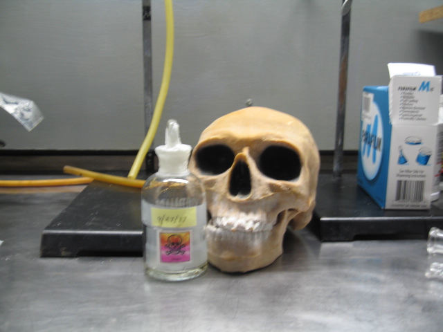

[*] posted on 27-9-2017 at 09:38
Today I made 2-3ml of oleum using the procedure of CD-ROM-LAUFWERK as presented by garage chemist. This is an extremely facile method. Phosphoric acid is first dewatered to metaphosphoric acid (HPO3) under strong heat. This then dewaters the H2SO4 to SO3.
The hot phosphoric acid severely corrodes the 100 mL rbf but garage chemist says NaOH will remove this.
oleum.JPG - 127kB
[Edited on 27-9-2017 by Magpie]

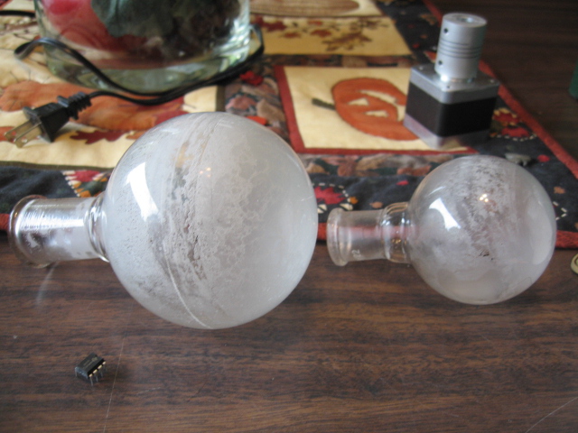

[*] posted on 28-9-2017 at 18:24
I was able to remove the grit by refluxing with concentrated KOH solution for a few hours.
edit: No, this did not work. See pictures below:
IMG_2114.JPG - 155kB
[Edited on 29-9-2017 by Magpie]

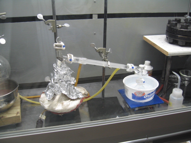

[*] posted on 28-9-2017 at 18:52
Today I made another batch of oleum, this time at 4X scale. I used a 600mL beaker for preparing the HPO3 and a 250mL flask for making the oleum. The yield was excellent at 29.6g vs an estimated 2-3g for the 1X scale.
I should caution that my ground glass joints leaked profusely. Therefore a good fume hood is mandatory.
2 pictures will be posted as soon as I figure out how with my new computer.
making oleum at 4xIMG_2112.JPG - 150kB IMG_2113.JPG - 134kB
[*] posted on 29-9-2017 at 17:07
The NaOH did Not remove the corrosion product from my flasks. See above picture.
