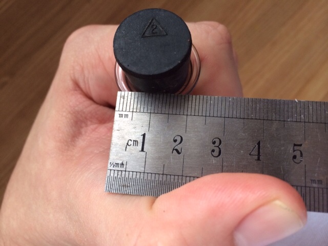

I'm buying some test tubes from elementalscientific.net, and it only sells rubber stoppers separately, the tubes are 20 mm across, but their stoppers
use a different scale (or whatever you call it), does anybody know what size stopper fits a 20 mm test tube?
Mailinmypocket
Posts: 1351
Registered: 12-5-2011
Just checked for you, you would want to get a number 2... 1 fits but is a bit too small

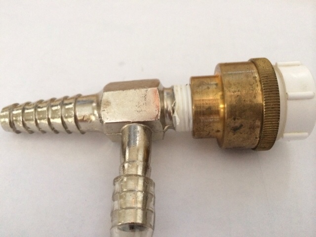

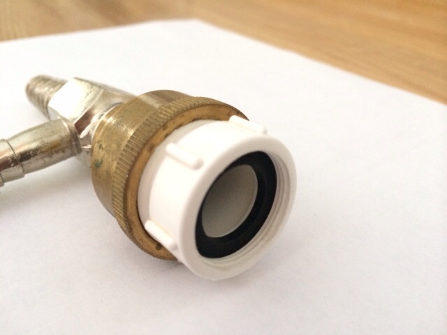

Since I can't seem to find any sort of help on this: How do you set up a water aspirator? More specifically, I'm confused about the top - it looks as
though it should thread onto a hose or sink or some such.

Mailinmypocket
Posts: 1351
Ugh I had a hell of a time when I bought mine... I bought the brass attachment bit from the same company that I got the aspirator from. I think this
is the part you are referring to, it seems to be hard hose size. They sold it as a faucet adapter but it clearly is not for household tape anyways. I
went to a aquarium specialty store and bought the white piece, it's a tap adapter for a "Python" aquarium vacuum thing, it converts the kitchen tap
thread size into the required size. It cost me something like $4. I would have liked a metal one but oh well... It works perfect anyways.
**edit: here is the item http: http://www.amazon.com/gp/product/B000255NUU?ie=UTF8&forc... it actually consists of two pieces, the top bit is a male end which you may or may
not need depending on your faucet
