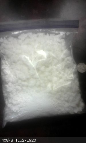

[*] posted on 18-11-2017 at 04:55
I just did two runs to see how heat affects yields. During one run I boiled the solution down. During the other I evaporated it in a tray with a fan and a space heater.
Both had lousy yields, around 17%. Both had a lengthy plateau where the specific gravity of the solution remained at around 1.27-1.28 while lots of solids precipitated. I prefer the tray/fan/space heater route because it requires less supervision. It was also actually extremely easy except for the vacuum filtrations, but I had the assistance of a mechanical stirrer.
It seems plausible that the apparent decomposition and decreases in pH I had observed previously might be caused by impurities in drain cleaner sulfuric acid.
Heating the solution to 110 C doesn't seem to degrade the product much with the pH at around 9, but I think there is some kind of co-crystallization that occurs with a hydrate of sodium carbonate and sodium ethyl sulfate.
IMG_20171118_060047 - Copy.jpg - 408kB
As has been reported elsewhere, it resembles cauliflower.

[*] posted on 18-11-2017 at 12:37
Great work JJay! This post was very validating for me, my result looked very similar on my one and only attempt so far. But due to an unfortunate rookie mistake involving an open stopcock on a sep funnel I lost nearly all of the resulting nitroethane I made with it and that was my only way of validating I had produced the proper compound. I will attempt again soon and let you all know if I find anything worthwhile during my efforts. I have a couple of ideas on improvements to its preparation that I want to try out.
