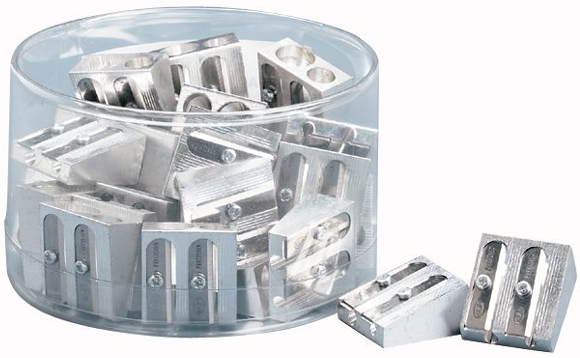

BTW can anyone think of a source of Mg I might have around the house? It doesn't have to be pure at all. |

Thanks, I forgot all about pencil sharpeners. I know them and fireblocks are all I could think of.

Pencil sharpeners? Why make pencil sharpeners from Mg when the cheaper and safer Al will do?
Sources of Mg include anodic protection blocks, often found on boilers and such like for corrosion protection, and flint blocks for emergency fire
making (hikers, mountaineers, explorers – any multi purpose sports store will sell them). And the streets of eBay are paved with sellers of
pyrotechnical Mg powder. Look for fairly pure, fairly coarse stuff…
