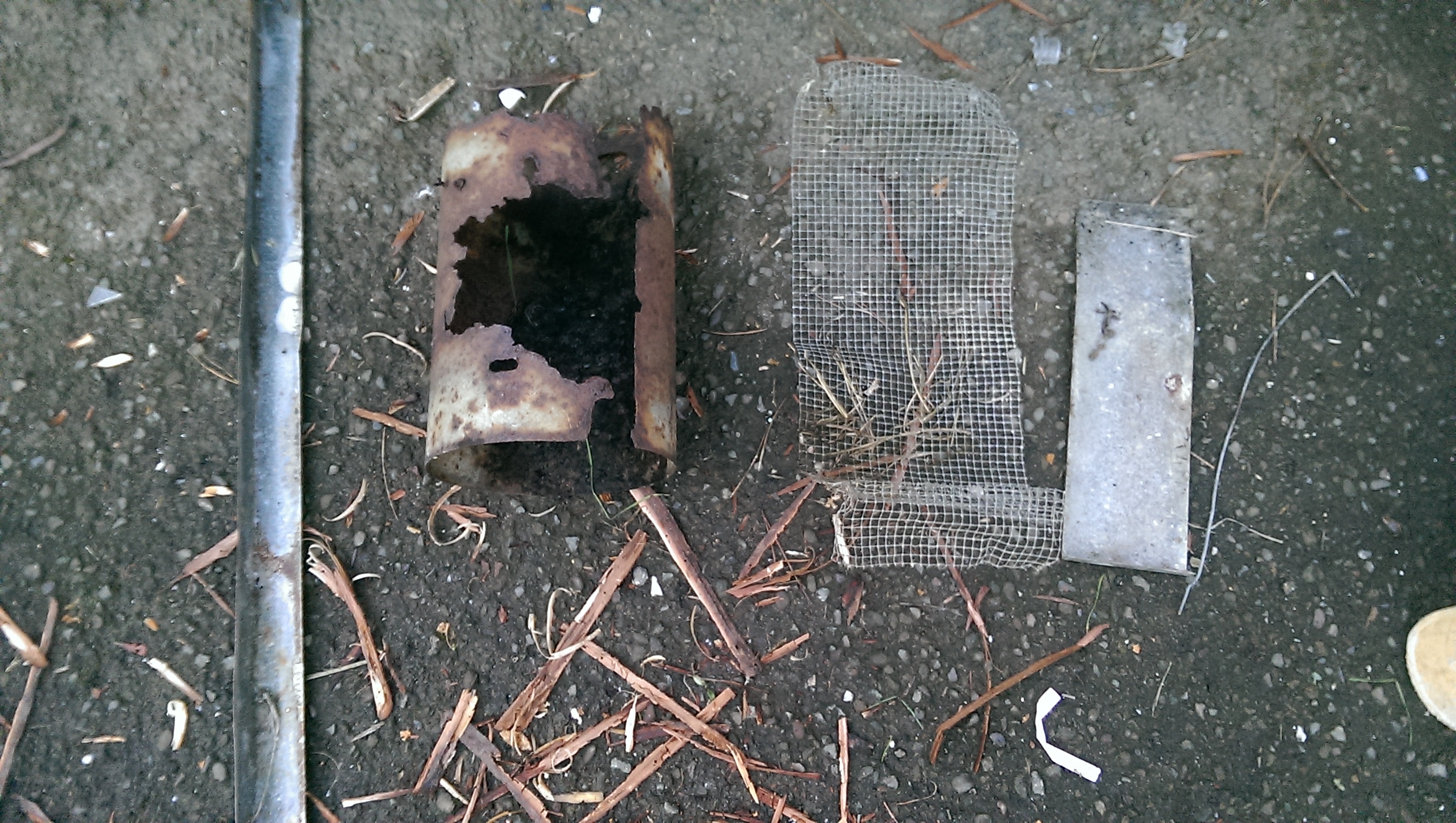

new cooker... Check, just a few min, some rusty scrap and drywall screws.
IMAG8270.jpg - 1.6MB IMAG8281_1.jpg - 340kB IMAG8265.jpg - 1.3MB IMAG8290.jpg - 1.3MB
Been messing around with the first samples I made, soaked one in crude copper sulfamate and got some copper sponge to grow across/through the porous carbon. Its baking now. Third time through. 1) no conductance, 2) meager conductance in several spots, 3) still cooling. Thinking electroplating it slowly at very low amperage after improving the overall conductivity of the sample. Small metal dendrites may be fun.
Decided would try copper doping first as 1, soluble Ni for later and prety much only when needed, 2. Ammonia + Copper salts = soluble cellulose for the next trial.
Piece #2, pre carbonized, is soaking in Ni sulfamate and has been wrapped in thinned out cotton ball material. Tied with a fillament of same twisted to make thread. Thinking of adding a honey glaze or cellulose washes to tighten it up and add an even coating. After reading for a bit came across this VVV :)

Well, here they are!
Some photos of the bread, pre-baking:
The slices were individually wrapped in foil packets, as shown:
Once this was done, they were baked at 260 degrees C for exactly one hour. Then, they were taken out of the oven and left to cool. Once cool, they looked like this:
As you can see, the porous structure and general shape is retained. However, a little bit of the volume was lost (it's a bit hard to see in this photo):
The resultant product behaves like a firebrick, in that while it is quite resistant to breaking, it abrades easily. Finally, the two samples were snapped in half to test how they would fracture:
To my surprise, they snap cleanly down the middle! This indicates good structural rigidity of the carbon foam.
Electrical results will follow later, and temparature results may have to wait for now (no access to a blowtorch). Still, this was an extremely easy experiment to carry out, and produces a rather useful material!
EDIT: Electrical results in! This stuff has a resistivity of, at the very least, 3.94 x 10^5 ohms per cm, putting it about on par with cement or limestone in terms of resistivity.
[Edited on 11-19-2016 by elementcollector1]

It amazes me that 260C achieved this.
Great work!
[*] posted on 19-11-2016 at 12:04
Superb work there elementcollector1 !
It would be great if anything can be added before/during/after to make an excellent catalyst or something.
