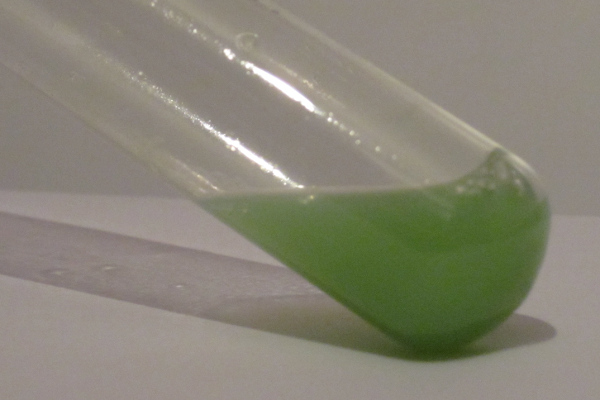

here goes. the washed CuCrO4 precipitate from sample 1. suspended in some water:
1c.jpg - 84kB
this was heated to boiling and two drops NaOH 3.8M were added: it immediately turned black. after cooling and standing overnight, the filtrate was recovered as a pale yellow liquid. upon further boiling a dark yellow solution remained:
1d.jpg - 79kB
[Edited on 7-11-2012 by tetrahedron]

@Tetrahedron:
That shows neatly and conclusively that the method works, as far as I'm concerned. Case closed.
