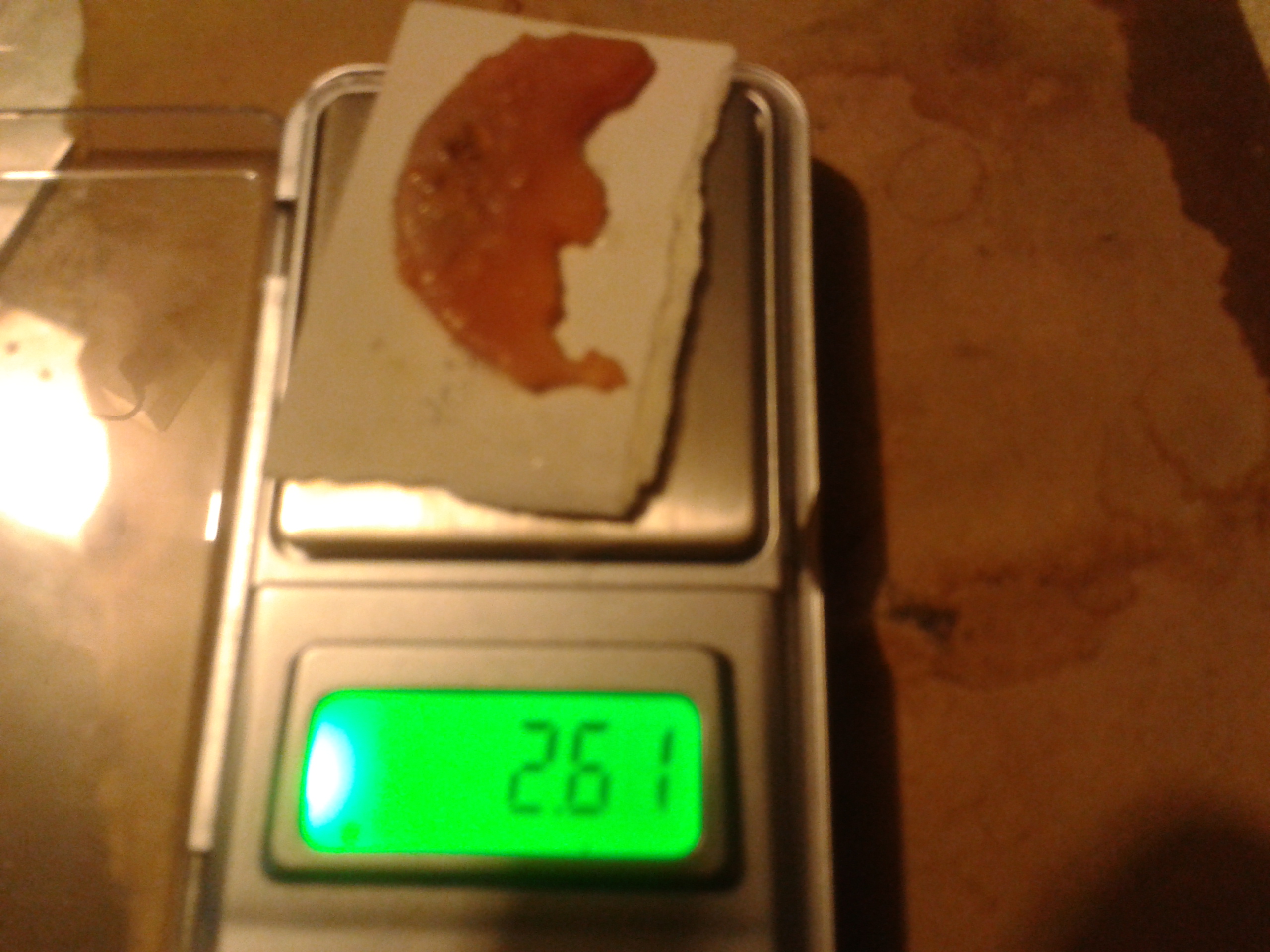

Right the results are in but not sure how accurate they are, for the retort with lime i got 1.35 gms of phosphorus, and for no lime 1.75 grms, the no lime retort seemed to also be really reacting well as there was a lot of phosphorus being wasted and burning up in the air after passing through the water:mad: used a new element and think temp was to high measured at 945 deg c with probe, you get the same effect if you heat the outlet with a gas torch the phos seems to volatile and wont condense and just passes through the system, will play with settings when i get a chance cheers nuxy
nux vomica
Posts: 267
Registered: 18-7-2013
[*] posted on 25-9-2014 at 21:54

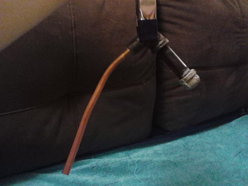

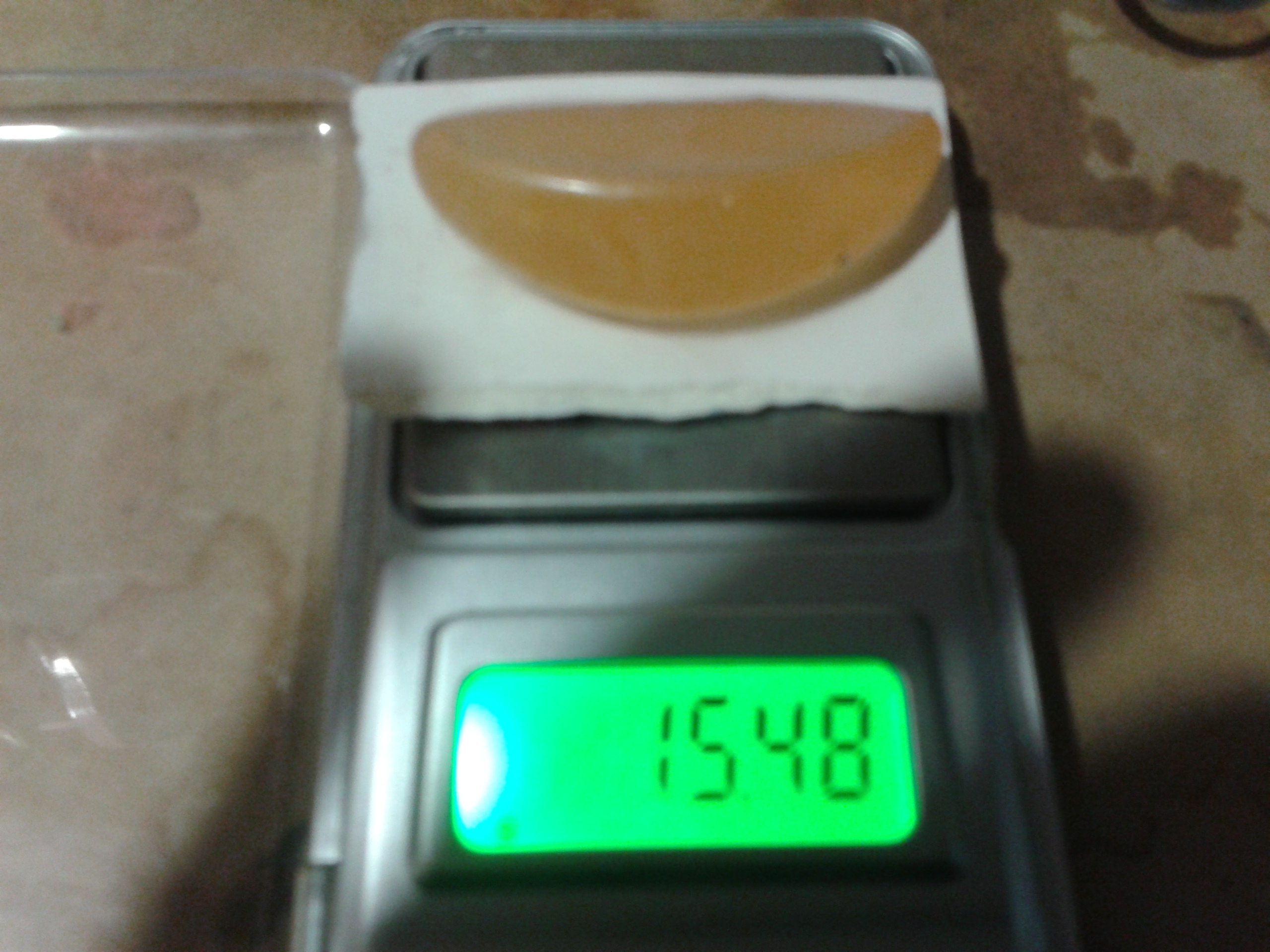

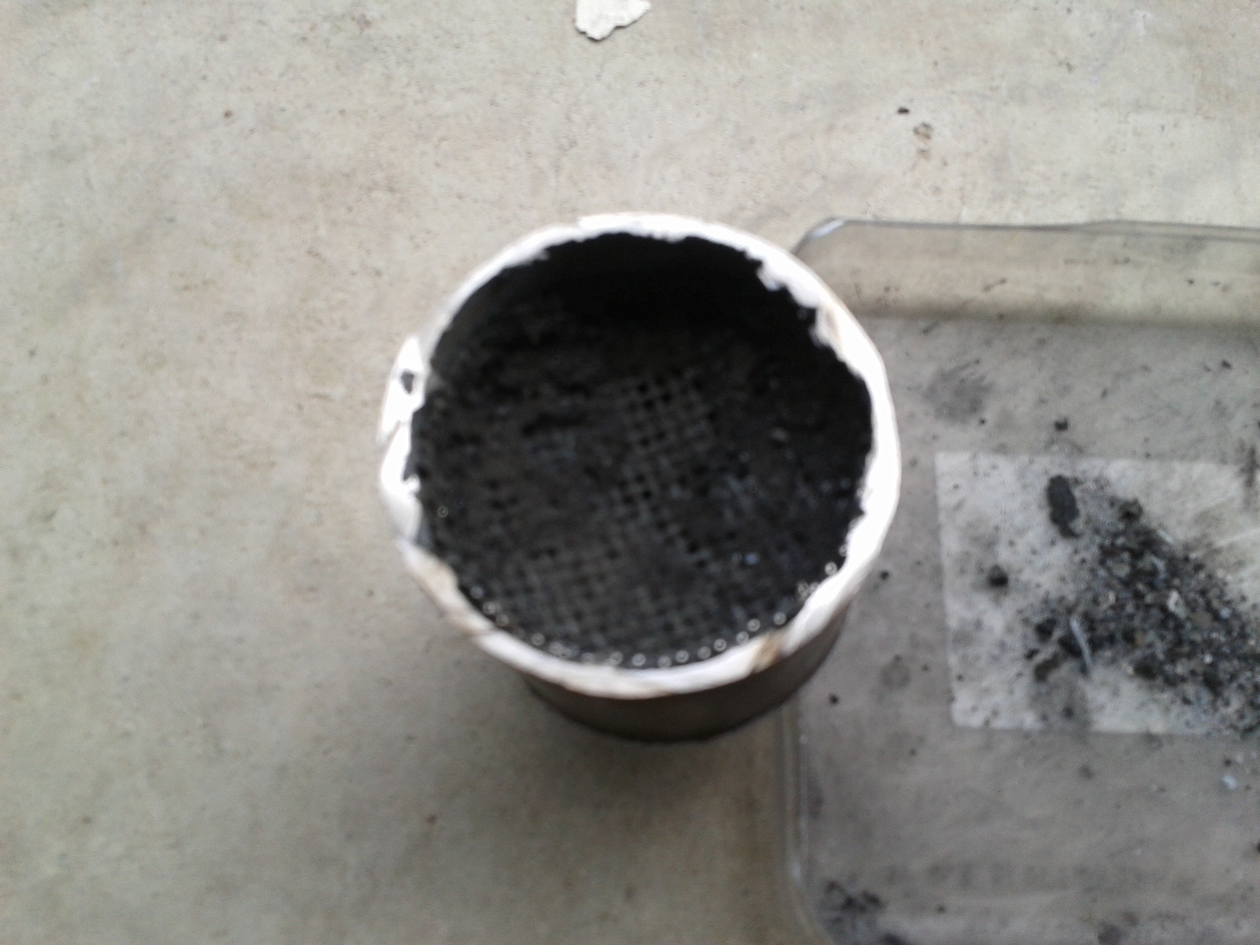

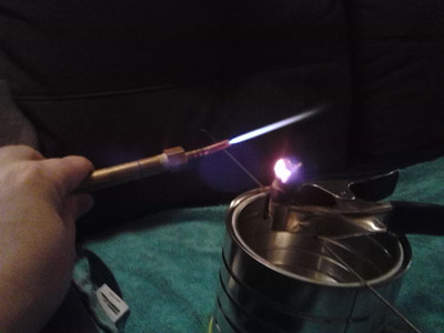

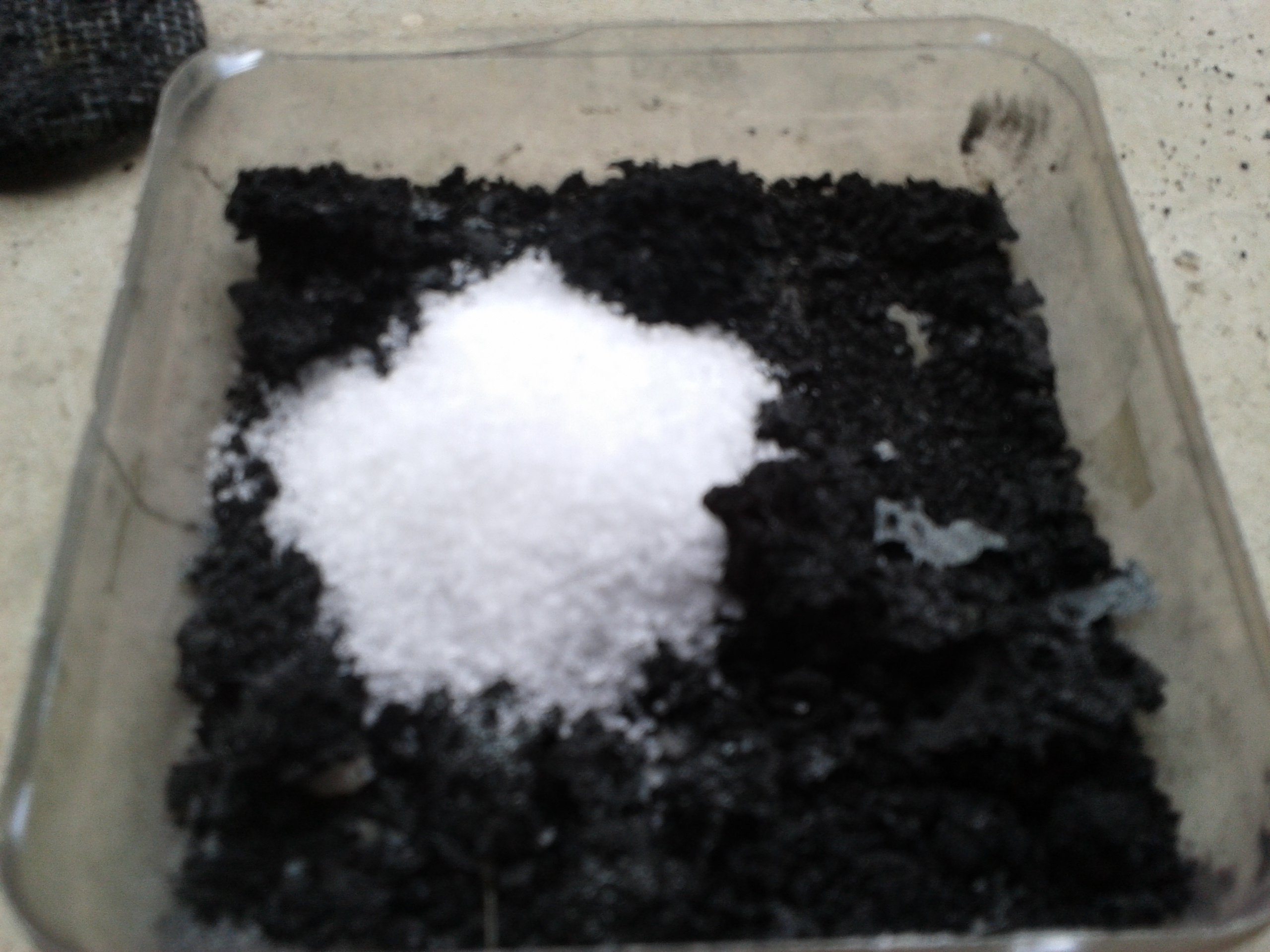

Had three more goes for the return of 2, 2.3, 2.65 grm phosphorus used a glass tube leading into the water and found the phosphorus condensed on the glass and will run down the tube if you heated gently with a gas torch occasionally much better way to do it.

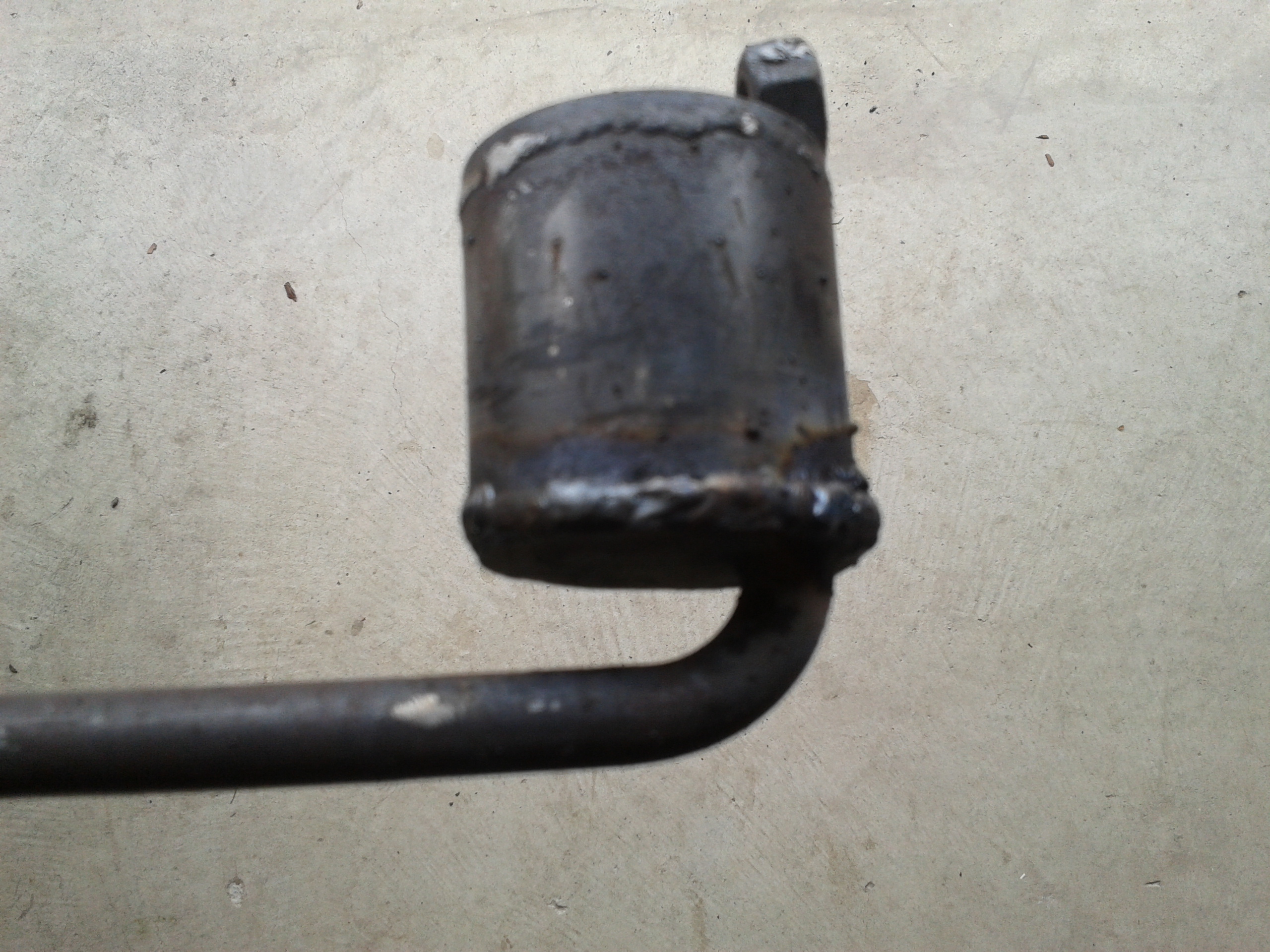

Took a pic of map and coke mix didnt crush them up but mix and seal in retort, arc welded tube at home useing 2.5 m/s rods.
Cleaned all the phosphorus up in chromic sulfuric acid mix total is 15.48 grm dont even really need that much so might see if i can turn it into red phos seems a bit more usefull and stable than the white version cheers nuxy.

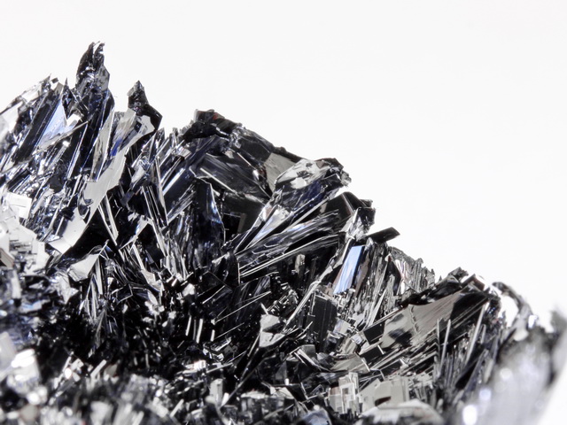

Im not sure if preparation of black phosphorus crystals has been discussed but I'm very curious as to how it its created. I know extremely high pressure is applied or gas phase transport.
Please share some info or refer to one of the 48 pages of this thread

This is my HHO torch which is semi-dismantled at the moment.
yJxn9Ck.jpg - 55kB
THIS is what I need feedback on. I built 2 retorts. 1 big that's not done yet and 1 small. This is my smaller one that I want to begin doing larger chargers in (25+gms).
yopDzh2.jpg - 39kB
It's crude but I'm gonna hit the back cap with MAP gas and the middle with a cooled burst of HHO. I did NOT weld the copper distiller to the steel because the threads on that adapter connect to my bigger retort (it can be reversed for larger hundred gm charges).
What I did to connect the copper pipe is put it in the reducer with a small gap around the pipe (like 2mm). Then I used a small flat screwdriver and quite a bit of AL foil to pack it in tight all around the pipe down to the bottom. After that I poured SiO2 dust all around the pipe. Then I hammered the dust down hard ass possible going in circles packing it down. Then I put another layer of foil up top and hammered that down to sandwich the SiO2 dust between 2 layers of very tightly packed foil. So basically it's like a rock of SiO2 powder crammed between the pipes that effectively seals out air. This way down the line when I'm ready to scale I just hammer/wrench out the pipe and connect it to my bigger retort then use the small retort as the distilling side.
The thing is... I'm a bit worried as to whether a "seal" like this will hold up.
I've seen the amount of smoke just a few gms produces. The first time I tried AL I did it open air in my home with no ventilation... my whole house filled up with smoke. I immediately opened all the windows and threw fans in. Then I started testing the same volume in my bathroom in a small retort. With a respirator on my face and small fan vent on the ceiling.
My "ventilation" now is a fan in the window (bathroom fan isn't powerful enough for large charges). I can't do this outside. It's too cold. Nosey neighbords, etc. So it has to be done inside. I've already heated the pipe with MAP and HHO to see how it holds up and as long as I keep enough coolant in the line the pipe stays bright orange-yellow and doesn't melt. You can also bang on it and it doesn't deform unless you turn down the MAP gas. My concern though is at higher weight the reaction itself could melt the AL. Then I'm left with just SiO2 and I'm hoping worse-case-scenario that will stop any breach of O2.
Finally, I've thought about flooding the retort with CO2 gas. As I saw someone else in this thread do that and that will allow me to test the retort with smaller amounts first. The problem is he did that around 750C in a testube. I'll be slightly under the melting point of steel (1300C?). From what I understand, CO2 gas is no longer "inert" at these temperatures. As in, the AL with burn in CO2 like oxygen inside the retort? They say not to put out MG fires with CO2 so this has to apply to AL as well, right?
Sheesh, so many things that could go wrong I think I'll just start small maybe 15gms and see how that holds up.
My end goal is to build a "quick fire rocket distiller" so safety & engineering are huge concerns here. When I switch to the rocket model I'll test very small amounts first on video. I know many on here will be concerned with clogging. But I think good engineering will stop that.
