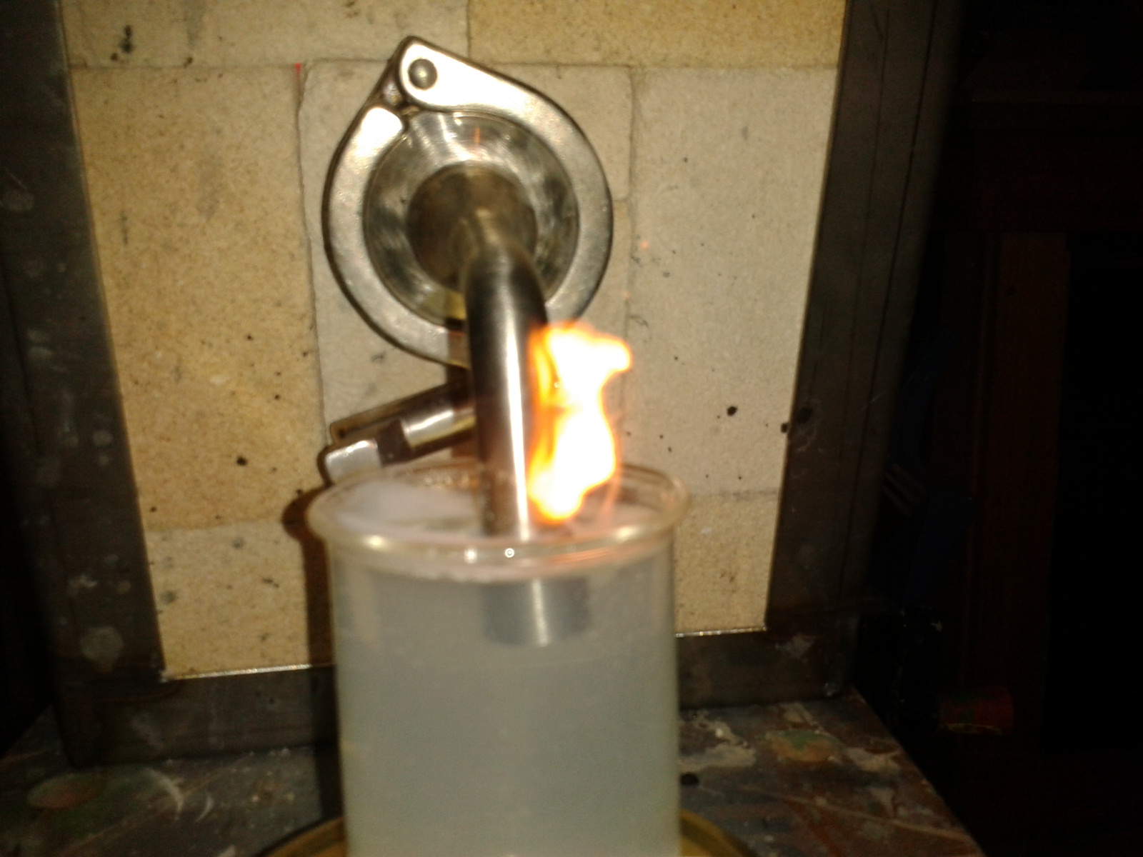

Managed to make a small amount of white phosphorus today i added 50 mls of 47 % rust killer to 25 grams of crushed heat bead, and heated the mix up until it was like black lumpy honey ,then put it in a s/s retort i made at work from odd and sods, i then put it in my electric forge and after 3 hours of bubbling and self igniting fumes i was left with 1 gram of white phosphorus ,great but scary stuff .
will try mono ammonium phosphate next ,did a trial run and managed to get a tiny amount of WP so looks promising.

Nice work. What kind of a flange closure system is that? It almost looks like a Victaulic. Does it require a gasket?
Is the assembly reasonably easy to clean?
[Edited on 12-8-2014 by Magpie]

There called triclover unions we use them in product pipelines in food and pharmacutical factorys, they can have a nitrile or viton seal and the pipe to ferrel weld is a purge weld cheers nuxy

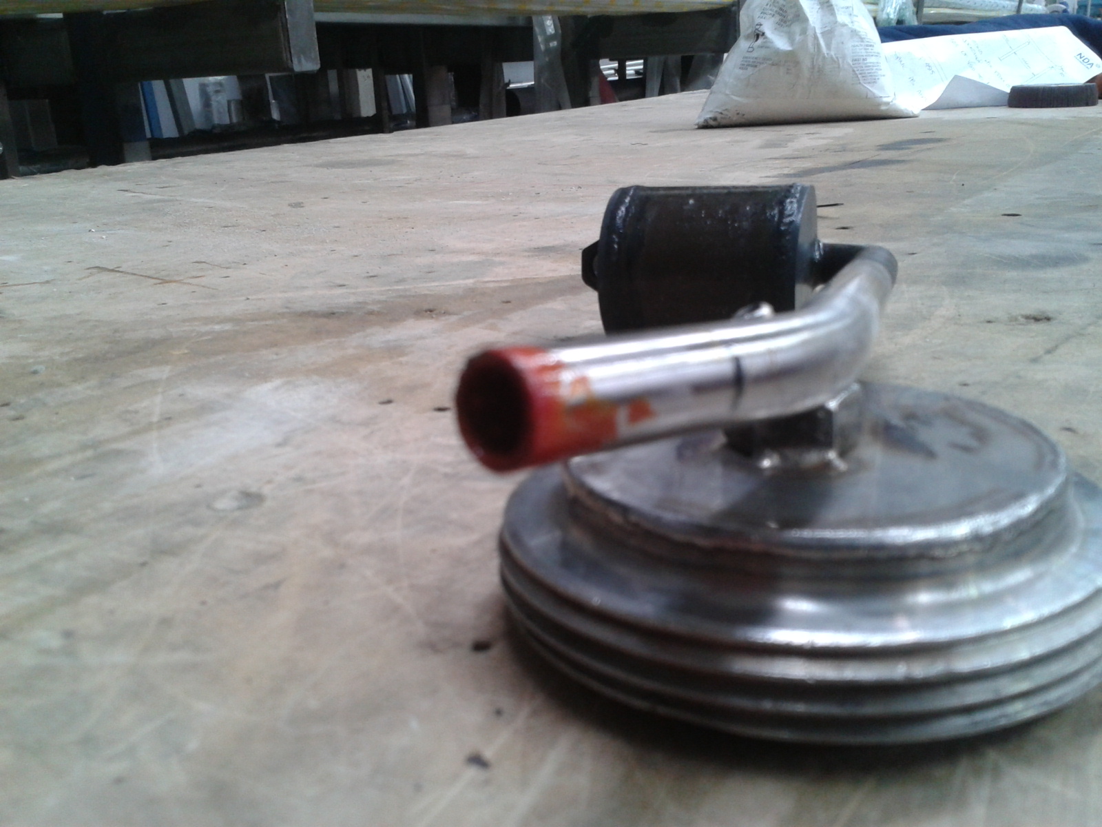

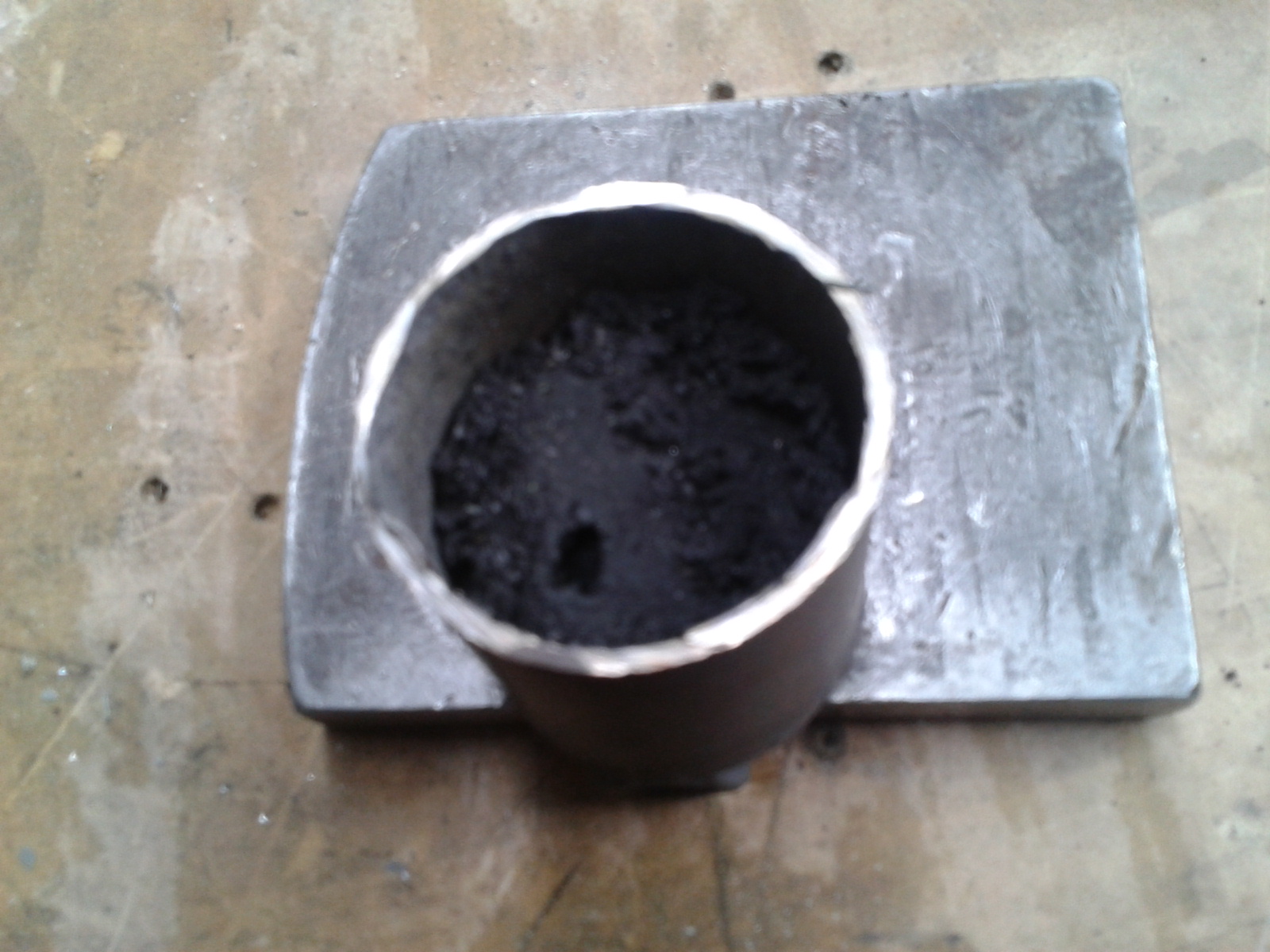

I knocked together a second retort today so i can run several batches in the one day, never bothered to have my own tig at home as i can always use my work tig on my own jobs at lunch time but i have to wait till I'm back at work to refill the retort now i have gone away from the triclover fittings.
Filled one retort with 15grm map and 30 grm heat bead mix, and the second one with 15 grm map and 30 grm heat bead mix plus 5 grms of garden lime interesting to see if there is differencece with the lime to no lime Other photo is a page from old book from 1920,s that has some info on phosphorus production . cheers nuxy

So, if I understand correctly, you are welding the retort pot shut then charging it with powder through the tube, right, or maybe charging then welding? If so, then how do you open the retort for cleaning and reuse? Do you have to cut off the retort floor, so to speak?
When heating the retort do you apply any heat to the tube or is conduction sufficient? How long is that tube and what is the diameter/height of the pot?
What's the purpose of the nut welded to the pot?

Magpie the main part of the retort is 50mm x 1.5 wall tube that is 50mm long the small tube is 12mm x 1.5 wall and is about 300mm long the nut is a standoff to raise the bottom of the retort off the firebrick.
I fill the retort first then weld the outlet end on if you look at my previous post there is a s/s mesh disk inside the retort to stop the contents from blocking the outlet.
