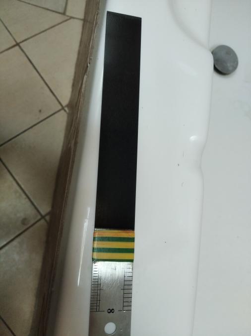

some stainless steel coated with PbO2-CeO2 nanocomposite layer will soon test if its viable.

Looking forward to hearing how it goes. Why did you go with a metal ruler as a substrate?
mysteriusbhoice
Posts: 477
Registered: 27-1-2016
Because its what I had on hand and overall its a really cheap 10 cent steel stick so why not and tho ive established Ti as a viable substrate I really
wanna move onto other substrates which are more accesible like copper for instance.
The main issue I have with stainless steel is adhesion of the PbO2 coating it just doesnt seem to want to stick to stainless steel maybe because its a
flat plate.
It also has issues sticking to Ti plates and seems to only want to stick to mesh type electrodes maybe due to having more surface area to latch onto.
