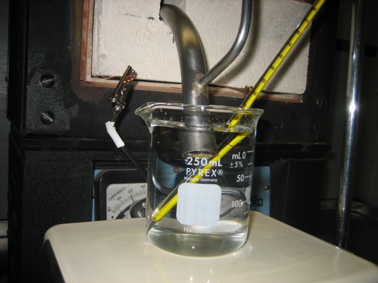

As a followup to my last post in this thread I fabricated a paint can retort with a Nichrome wire heating element. The wire was 0.56mm in diameter and 11cm long. When 9.7VAC was applied to the wire it would glow bright orange in 3 seconds. If the burn time was kept to 5 seconds or less multiple firings could be attained without the wire severing due to excessive heating.
Two holes, ~3mm in diameter, were located in the bottom of the wall of the paint can, diametrically opposed. The Nichrome wire was centered in these holes and cemented in place using furnace cement such that the wire was electrically insulated from the can. See pictures below:
element terminal.JPG - 106kB retort heating element.JPG - 107kB
A charge of 34.5g of Al/Bi2O3/NaPO3, with 15% Al excess, was placed in the can, covering the wire element. Using ss crimps 2 lengths of copper wire were extended from the retort. The retort was then loaded into the furnace as shown below:
copper terminals for retort.JPG - 115kB
Heating was started. At temperatures of 500C, 550C, 600C, and 650C, a 5 minute soak was applied then the heating element activated for 5 seconds. After each firing the element would be checked for electrical continuity to assure that it had not severed.
This plan was accomplished, but at no temperature did the charge react to produce phosphorus. The retort was allowed to cool to room temperature then opened for inspection. The charge had sintered and could only be removed with with a hammer & chisel.
Conclusion This method for initiating the charge was not successful. I believe that the sintering was normal and unrelated to the element firings.
