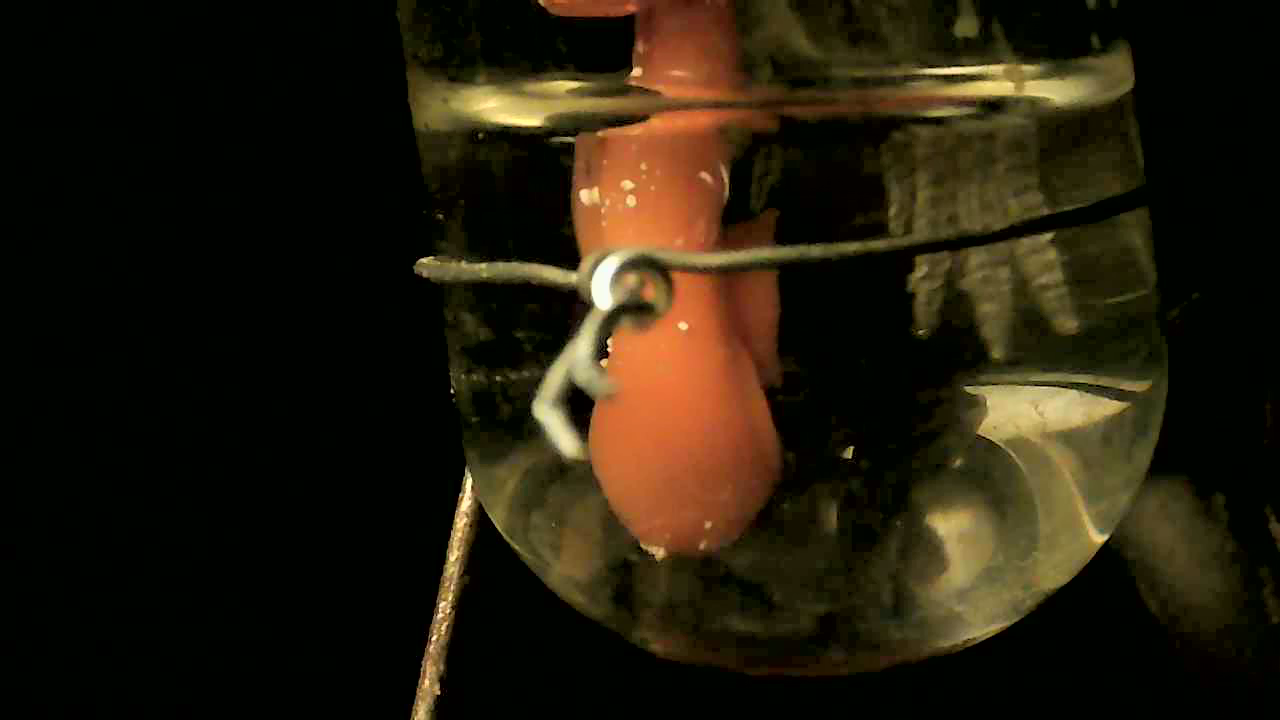

OK, I'm going to change one variable; and retry the melting experiment.
The variables I can think of are pre-drying by baking, kerosene as a reactant, urea brand (fertilizer) has contaminant, air may be necessary to melt urea normally; for it may interact either with oxygen or nitrogen during the melting process.
Did I overlook anything? ( suggestions welcome. )
I don't think kerosene ought to react with urea, but ...
Instead of kerosene, I'm going to try silicone oil, cosmetic grade.
I'll do the same thing, wire the soldering iron to the tube and make good contact; then bake about 1/2CC of urea at just above the boiling point of water for several hours to dry it; finally do a temperature sweep up to 155 [°C] and find the melting point of dry urea (if any.) I'll keep the picture count low, if I don't see a reaction and I'll just sumarize. If you want more pictures, just ask...
Setting the soldering iron to 50% power, I get a nice 105 [°C] temperature.
I don't see any steam or bubbling... but only a slow swirling of the silicone due to convection of heat. This suggests that the urea may be dry, already, in the bag. I am probably only driving off surface moisture, then, from the air.

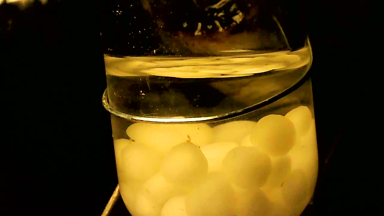

This is how the drying begins:
vlcsnap-2024-07-29-12h11m54s086.png - 422kB
I baked it dry for four hours.
Then, I did a temperature sweep all the way up to 100% power over 3 hours.

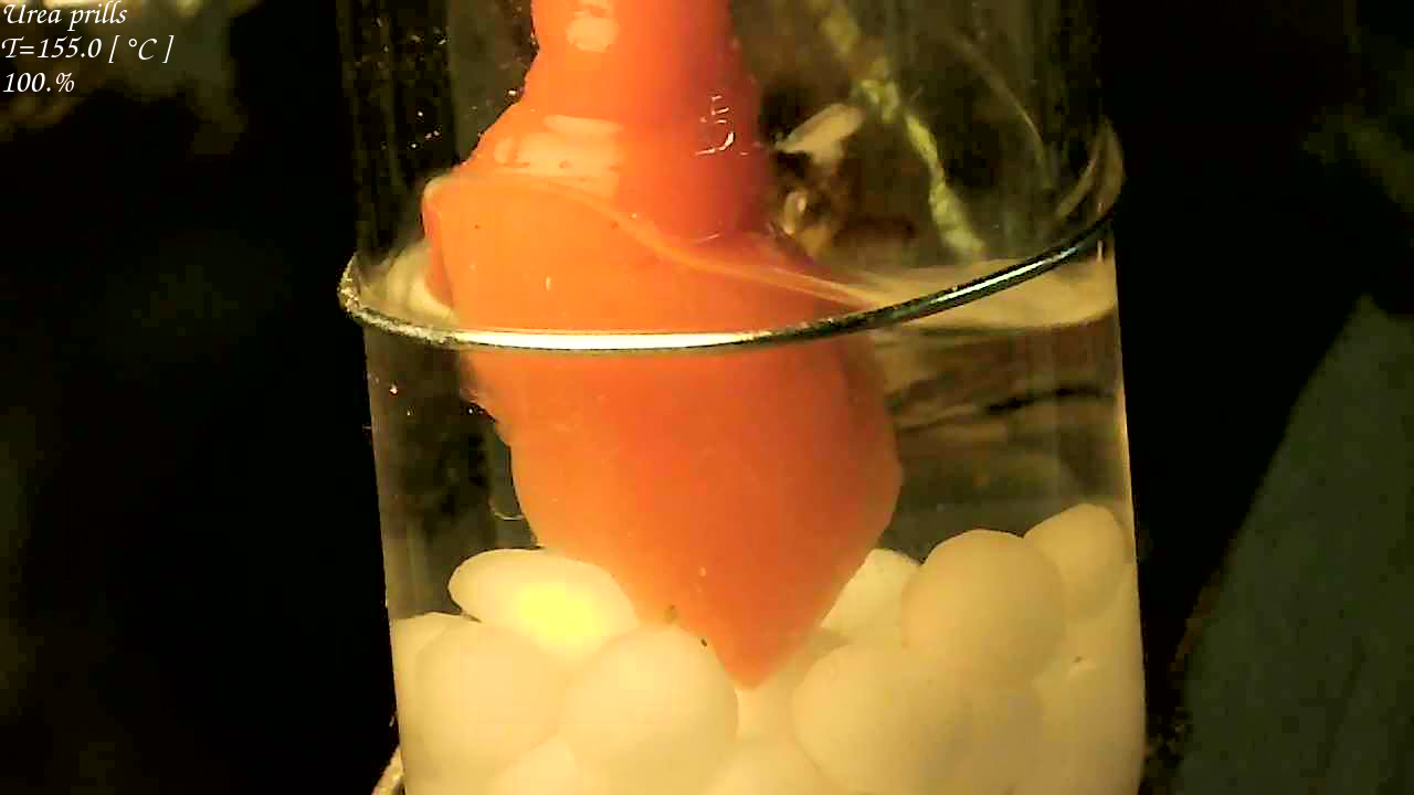

Urea did not melt under silicone, either!.
vlcsnap-2024-07-29-19h30m42s813.png - 352kB
1CST silicone oil, on the data sheet says it boils at 151 C.
Picutre says 154C, with rolling boil and a significant amount (10 to 20%) of silicone refluxing. Little bubbles began happening around 143C.
So, my thermometer is giving reasonable values.
I don't see any discoloration, which I expect silicone would cause if it chemically reacted. I'm more inclined to believe urea might react with air when melting, or perhaps I have an impurity which strangely raises the melting point rather than lowers it.
Not sure what to try next.... but this is repeatable. So something unusual is definitely going on. I've ordered reagant grade urea prills, from Loud Wolf™ to check for contamination issues.

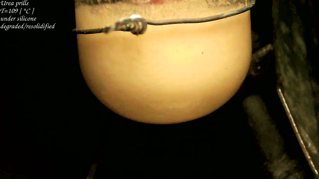

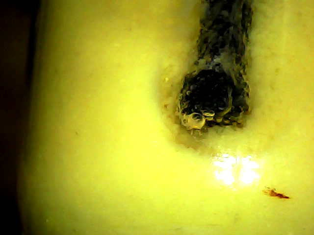

Edit: Note, allowed last experiment to reflux silicone at 154 [ °C ] for 8 hours. No melting or fusing was observed. After cooling, there was no residue on the walls of the test-tube. Urea either doesn't dissolve in silicone, or what little does dissolve is temperature independent. However, a slight yellow color showed up on the urea prills during cooling.
vlcsnap-2024-07-30-08h16m42s122.png - 352kB
I'm not sure if it's just inconsistency in the lighting. The color went back to white, slowly, while at room temperature; 21 [ °C ].

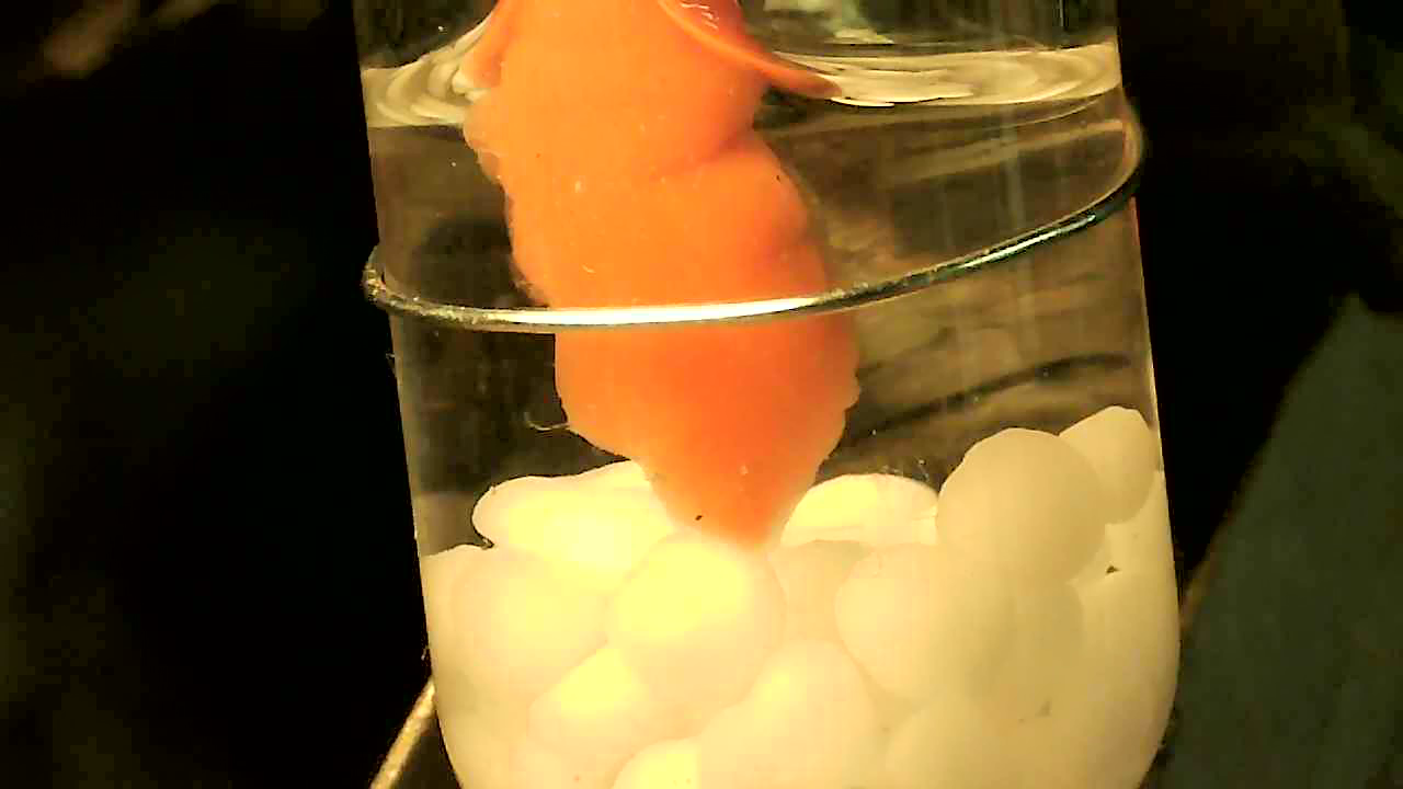

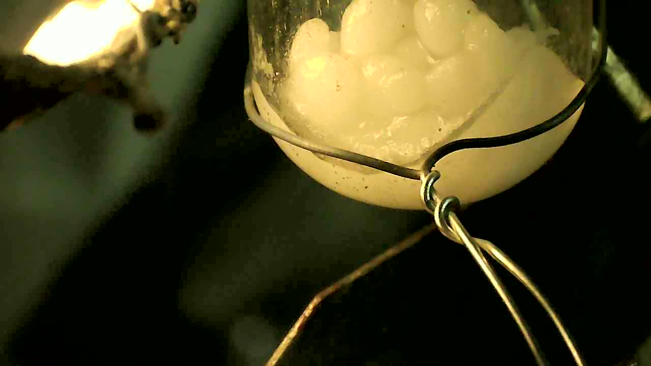

Placing urea in a test tube, exposed to air, and heating tube with same soldering iron at 100% from the start; result:
Urea nearest the soldering iron began melting within seconds. Liquid wicks into remaining urea and causes fusion of the surfaces.
Mild ammonia smell is present.
But: I could only smell the urea and oils, no ammonia, when it was under kerosene or silicone oil for a while.
vlcsnap-2024-07-31-13h45m10s512.png - 436kB
The thermal contact area is limited. I have to add more urea prills to get enough liquid. But it melts fine when there's enough prills to get the liquid level up to where the iron is. In fact, I need to turn down the heat; the liquid is bubbling and smells strongly of ammonia, now.
vlcsnap-2024-07-31-16h20m51s801.png - 417kB

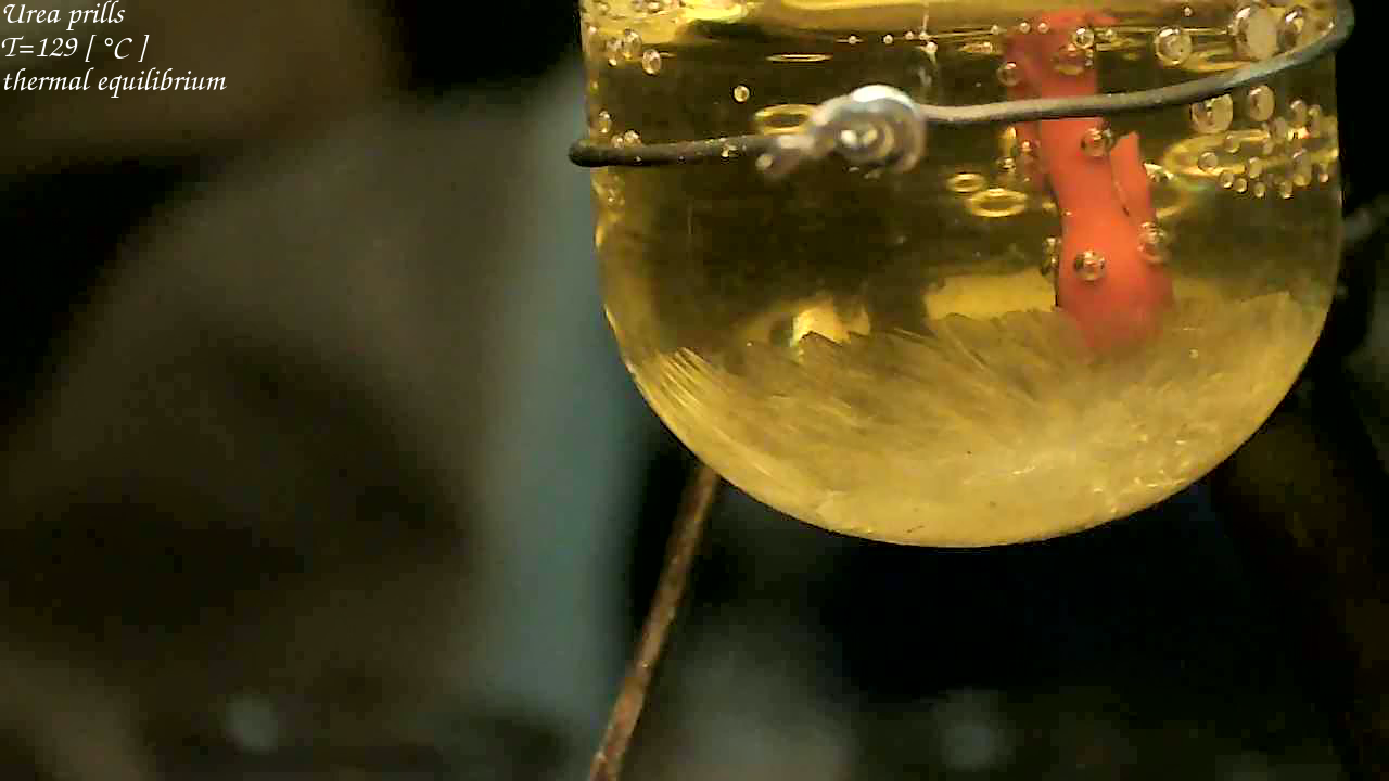

Ohh! fully melted, finally!
vlcsnap-2024-07-31-19h41m29s747.png - 380kB

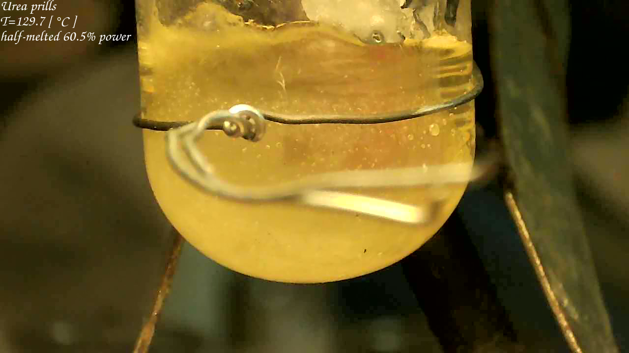

There was some urea condensing as solid, cotton candy like, on the test tube walls. I decided to place the melt under silicone to see if it stopped bubbling or triggered re-solidification; it didn't re-solidify for at least 4 hours; but Ammonia gas output reduced rapidly as temperature began to rise slowly even though power input was programmed not to change, anymore. Then some brown flecks formed in the urea. The temperature dropped (not sure when/why, need to modify program), and found tube as follows in the morning.
vlcsnap-2024-08-01-06h24m48s595.png - 275kB

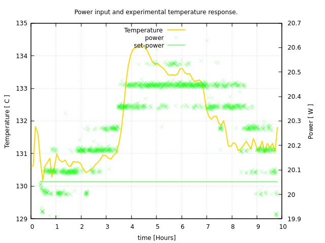

I figured out about how much energy it took to get the oil to 131 [ °C ], 72% or 20.05 [ W ] of power last night.
I programmed the KASA plug to report the voltage and current being supplied to the soldering iron so I could graph it and calibrate my temperature set-point.
Note:
This is a graph demonstrating the scientific concept of systematic error; even though I've tried to compensate for voltage changes on the power line. Apparently, I did it a little wrong. I've got to fix this before I can get really reliable data for science experiments.
systematic.png - 73kB
The spot where the temperature goes 'up' is in the hours between midnight and 8AM, local time. This is likely where all my neighbors have turned off their lights and gone to bed. But it might also be a time where the climate control in the lab (basement), changes a bit. I'll have to set up a second thermal monitoring ohm-meters in order to be able to compare what's inside the testube vs. the air around the test tube.
But, anyhow:
The temperature of the soldering iron bath rose 3 degrees during this dark of night, and I see increased power output to the soldering iron (on average) during this time.
So, power line regulation issues are a likely cause why the temperature rose on my last experiment, instead of being evidence for a chemical reaction.
I'll let this program run for another day or so, and get a long-term plot of the error and make sure it repeats as it hypothetically should, every night.
Then I can try to reprogram my heater code to *properly* compensate for line voltage variations.
