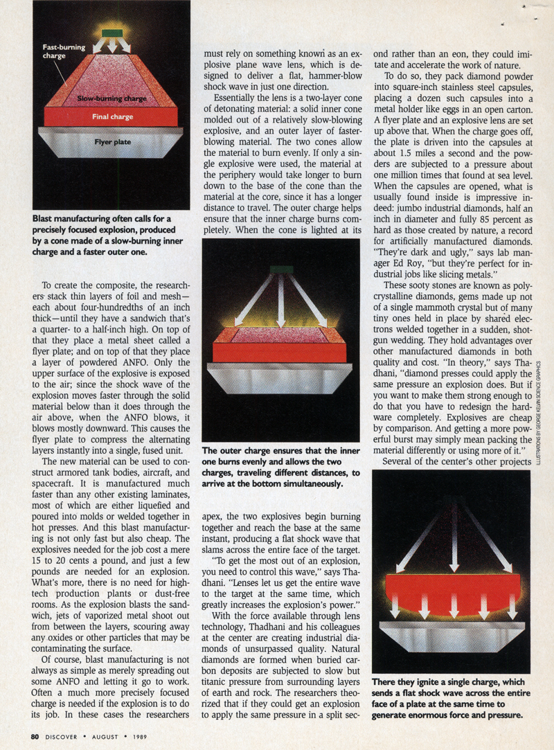

I suffer from the belief this was done on The Myth Buster's also-
on not by.
The Analogue guy returns from his files. Found this which
is not what I was looking (I am still looking) for.
