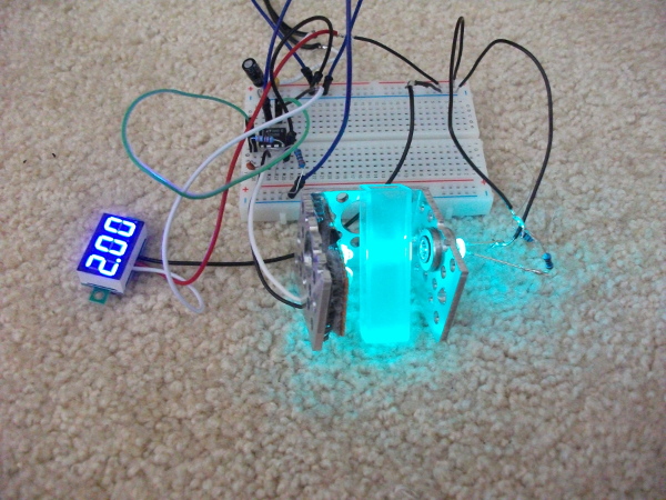

So I got the Hamamatsu S10784 PIN photodiode. It's maybe slightly better in the amp's out vs light intensity for my set up than the cheaper BPW34. I
think it's due to the smaller surface area. However, it works and I like the photodiode enough to use it over the BPW34 even though for this they are
likely interchangeable .
![DSCF0044.JPG - 160kB](http://www.sciencemadness.org/talk/files.php?pid=409416&aid=40947)

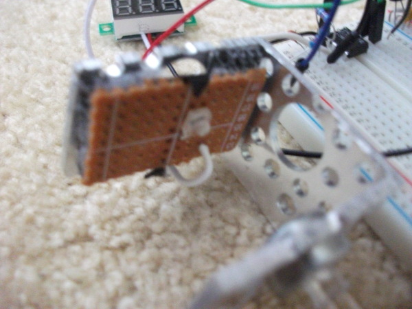

One thing I did to make alignment easy was to solder the photodiode onto some PCB and slap on some velcro. So I can move the velcro around on the
detector "wall". Hopefully that little trick helps someone else out .
![DSCF0046.JPG - 83kB](http://www.sciencemadness.org/talk/files.php?pid=409416&aid=40942)

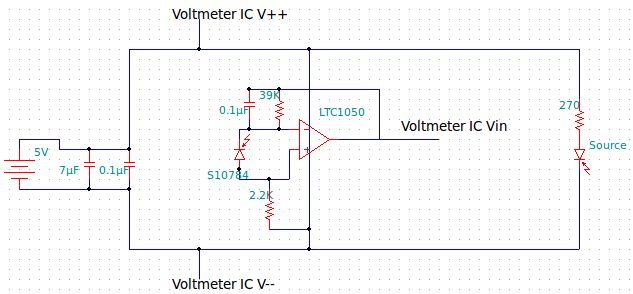

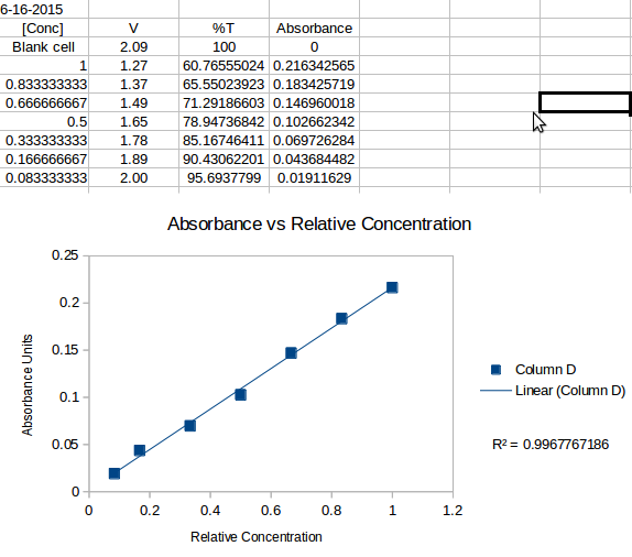

I put together my final circuit with the LTC1050 and get from 0.00V-2.19V using the green LED. Which is more than sufficient for me. I think the
schematic shows these elements being in parallel when in reality they are in series. Woops whatever.
![final circuit.png - 12kB](http://www.sciencemadness.org/talk/files.php?pid=409416&aid=40940)
I performed a more involve dilution trial with 7 dilutions to see if I could find a non-linear range at it's limits of detection. Not the case, linear
to good agreement all the way through (R^2 = 0.997).
![results.png - 32kB](http://www.sciencemadness.org/talk/files.php?pid=409416&aid=40944)

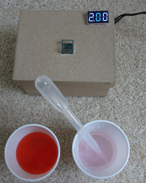

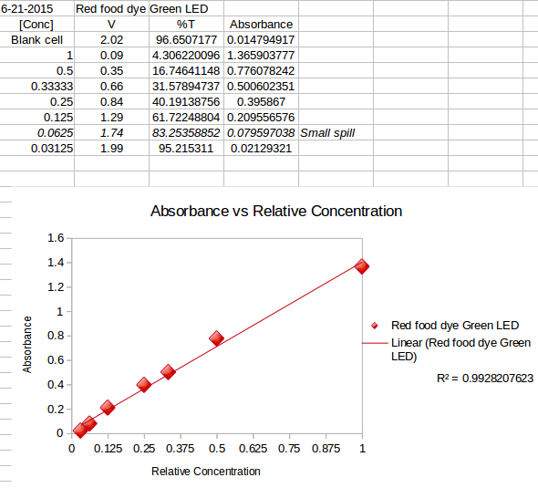

So I found a nice little house for the colorimeter. Craft stores in the US sell boxes called "paper mache" boxes which are really some variety of
cardboard easily sliced by a razor. I decided to test how well a green LED source could work with red dye rather then a green LED for green dye. As
the green dye green led couldn't get very dilute.
![DSCF0047.JPG - 121kB](http://www.sciencemadness.org/talk/files.php?pid=409960&aid=41190)
I ended up diluting it down to 1/32 of its original concentration, and maybe could have diluted it some more. The range was again linear. As you can
see the absorbance was nearly 5x compared to that of the green dye trial.
![red dye green led results.png - 41kB](http://www.sciencemadness.org/talk/files.php?pid=409960&aid=41192)
This time, I found that I maxed out the absorbance at high concentrations, but did quite well with low concentrations. I took a picture of the most
dilute sample I measured against a white background for reference.
![DSCF0048.JPG - 10kB DSCF0048.JPG - 10kB](http://www.sciencemadness.org/talk/files.php?pid=409960&aid=41193)
So in conclusion. The design I used isn't perfect. If the LED was closer to the detector it would do much better. The focussing idea IrC has is a
great one. However, the thing works reliably and can be used if the limitations of the instrument are known with the right LED for the right analyte.

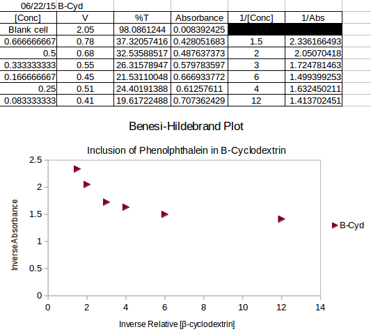

As promised I figure I'll show a 'real world' chemistry example of the instrument in use.
The experiment was to study the inclusion phenomena between β-cyclodextrin and phenolphthalein at ~pH 11.0. Unfortunately the indicator solutions
concentration could not be known as it was bought a brew store years ago. So all concentrations are essentially arbitrary.
Phenolphthalein is known to prefer the colorless lactonoid form in the presence of β-cyclodextrin due to sterical constraints and the energetic
favorability of complexation. So this means at a constant concentration of phenolphthalein and a varying concentration of cyclodextrin, the
concentration of the visible form of phenolphthalien should vary. As follows so should the absorbance.
1 to 1 inclusion is when one molecule (guest) docks into one other molecule (host). Meaning there aren't two guests to one host, or three, etc.
Without going into the math the Benesi-Hildebrand model of 1 to 1 inclusion suggests that if the host and guest of the inclusion pair participate 1 to
1 then there should be a straight line when the inverse absorbance of the guest is plotted against the inverse concentration of the host.(https://en.wikipedia.org/wiki/Benesi%E2%80%93Hildebrand_meth...) . This method is limited and only works if some assumptions are met.
So I performed the experiment very crudely and arrived at this result.
![benesi.png - 30kB](http://www.sciencemadness.org/talk/files.php?pid=410094&aid=41199)
Apparently the unknown concentration of phenolphthalein was not guessed correctly. Not really surprising. The result was that of an exponential decay
rather then a straight line. This result is typical for when the concentration of the host is too large relative to the concentration of the guest.Had
I of had solid phenolphthalien I could have performed the actual experiment with a bit more rigor. In any event this is actually why the Job Plot
method is preferred. (https://en.wikipedia.org/wiki/Job_plot )
It's not a thrilling experiment but the instrument can be used for real world chemical explorations.

smaerd:
In the experiment with the red dye what method did you use to prepare the standard solutions?
smaerd
Posts: 1262
Registered: 23-1-2010
Mood: hmm...
Oh for the red dye, all I did was take one drop of food coloring and dissolve it in approximately 15-20mL of water.
Then I dispensed 3mL of the main solution into a cuvette.
Then using the graduations on a disposable pipette I then did 1.5mL dye to 1.5mL water(1/2). Then 1.0mL dye : 2.0 mL water (1/3). Then I diluted an
aliquot of the dye solution by half. And continued on doing dilutions by half. So, that's why it starts going down by 1/4, 1/8, and 1/16, and 1/32.
smaerd:
You would get MUCH better results (better R<sup>2</sup> with volumetric
flasks and bulb pipettes (both calibrated).
Also, for once, run three standards for each concentration and carry out an ANOVA to work out the source of variability
[Edited on 23-6-2015 by blogfast25]
smaerd
Posts: 1262
Mood: hmm...
I definitely would. The main thing is this, the voltage display is only accurate to +/- 1%. I'm using graduations on a pipette which is two
significant decimals. So really any R^2 on the order of 0.99 is acceptable for me. In the red trial you'll also notice that I made a small spill which
may have effected the last two trials slightly (lost maybe half/quarter mL of solution). Keep in mind this is a home instrument, it will only be used
to get a "good inference". If I find something of interest I can take the idea/experiment to a UV-VIS at work/school. Also LED's have a spectral width
of like 15-30nm iirc so it's not really designed for anything 'definite'.
I also only have 1 volumetric (100mL) at the moment because I broke my other one (10mL), and I don't have a bulb for the pipettes I have at home. I'm
moving to a location where I won't have access to my home lab for quite a long time(in the next few weeks), so I'm not in the position to upgrade or
add more things too my lab that aren't portable or disposable. This is why you see me posting about creating instruments and miniaturizing experiments
lately. So I can still do science for funsies, just not the 500mL refluxing concentrated acids type science unfortunately.
If the question is whether the instrument reproduces the same measurements for the same concentrations the answer is yes. Even after turning it off.
In the cyclodextrin experiment I actually recreated several solutions/dilutions as I went just to see and they held up each time. Also I wouldn't have
to recreate solutions to test that , just re-run the same sample. The biggest
determining factor is if I place the cuvette into the slot off-axis, that really screws things up (experimental error).
I suspect that any variation that is occurring due to electronic noise is beyond three decimals (volts). Very rarely does the voltage flicker between
values and if it does I just assume it is X.XX5 (which may be poor practice). I didn't create the circuit to balance thermal conditions either, but
again I suspect those variations are beyond what the display can output.
