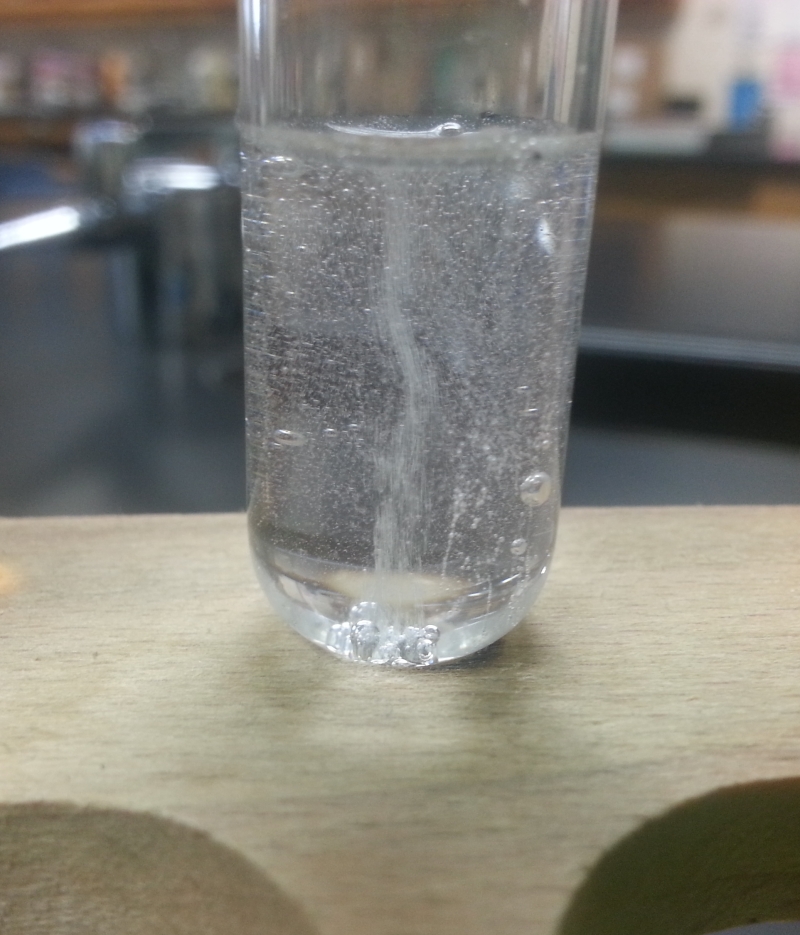

Tb-in-HCl.jpg - 415kB
yellow-Tb.jpg - 273kB
[*] posted on 13-12-2013 at 06:11
B&F:
I've never really heard of coordination complexes of the f-block elements. Most d-block elements that form them are amphoteric to some extent and the REs aren't amphoteric. But I could be wrong on complexes. Seems to me the f-orbitals don't lend themselves to bonding ligands very well. Again, I could be completely off the mark here. Will google a little later on.
What's happening in pic 1? Tb in HCl?

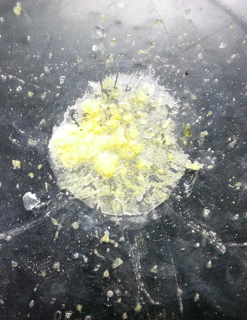

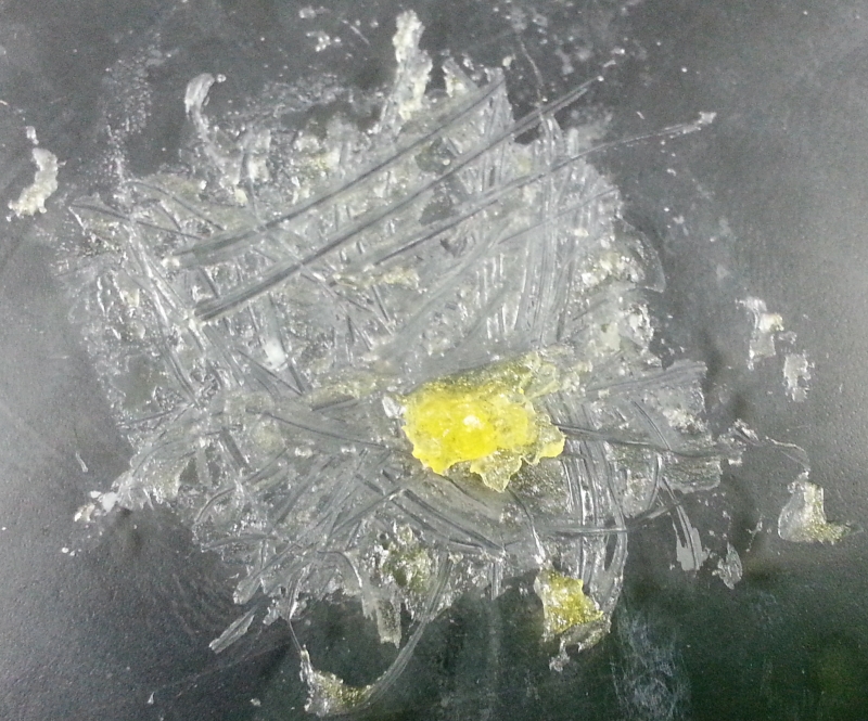

I was able to dry some TbCl3 in a vacuum dessicator, but only partially. It displayed a strong yellow color, similar to that of a fluorescent highlighter. It looks the same in sunlight and tube lighting. (I'll need to try CFL lighting as well because that produces the most dramatic color shift.) However, no fluorescence could be observed. I have a feeling water may be able to quench the fluorescence of terbium compounds - after all, terbium chloride is supposed to fluoresce. I'll test nitrate as well.
blogfast25: Pic 1 is Tb in HCl. The complex isn't visible until after the HCl solution is depleted.
Is it possible that this yellow color is TbOCl (terbium oxychloride) forming? This may be possible, given the complex appears to turn clear in even the slight amount of acid. If this were a chloro complex of terbium, I would expect the color to change only slightly as progressively larger amounts of HCl are added. I haven't tried redissolving in pure water - maybe that will confirm the result.
From woelen's site, praseodymium oxychloride appears to be only slightly, if at all, soluble in water. This complex is soluble in water - so either TbOCl is soluble or there's something else going on.
Perhaps the answer may lie in this thread? Perhaps different preparations can produce different colors.
Pic 1: complex after drying. It was still wet, I'm going to vacuum it some more.
Pic 2: I decided to dissolve it in a 0.3 molar TbCl3 solution with some excess HCl, originally clear, and the solution turns very pale yellow.
wet terbium chloride.jpg - 435kB Solution to dry.jpg - 408kB

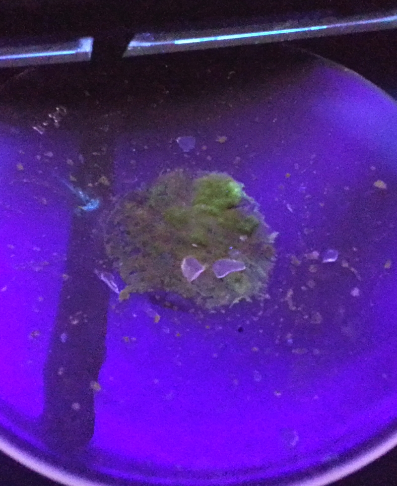

I dried the solution further and ended up getting yellow flakes of what appears to be terbium(III) chloride. Again, it should be white, but I have no clue as to what's causing the yellow color. There was iodine in the dessicator after a spill occured, but that can be ruled out because the color of the solution was yellow to begin with. A test for fluorescence came up mostly negative, but there were a few flakes that glowed greenish. The rest took on a very dim yellow color. (I've heard dysprosium has yellow fluorescence, but I have no idea if there really is any.) As expected, the flakes are paramagnetic, but only slightly.
In CFL light, the color does not change at all. It's still yellow.
Oddly enough, it smells like oranges. This is really unusual - the compound shouldn't be volatile at all. The only volatile compound I could fathom exists would be terbium(IV) chloride, but I doubt HCl can produce this. I can't be sure if it's the compound itself or some volatile substance that was in the vial earlier.
Now I need to figure out what this yellow stuff is...
Here are two photos of the compound - one it normal light, the other in UV. During the vacuuming, some glass in the dessicator chipped off, and there are fragments on the watch glass.
dry terbium chloride.jpg - 773kB tb in uv.jpg - 528kB

I doubt if TbOCl2 can form in these conditions. These halides are just not that prone to hydrolysis.
How pure is your HCl? Iron is very common in garden variety strong HCl. That picture looks so much like some white chlorides I've prepared with hardware store 'muriatic acid'!
Try also to add H2SO4 to the solution to see if the sulphate (hydrate) precipitates and whether it fluoresces (strongly green under UV, acc. Wiki).
