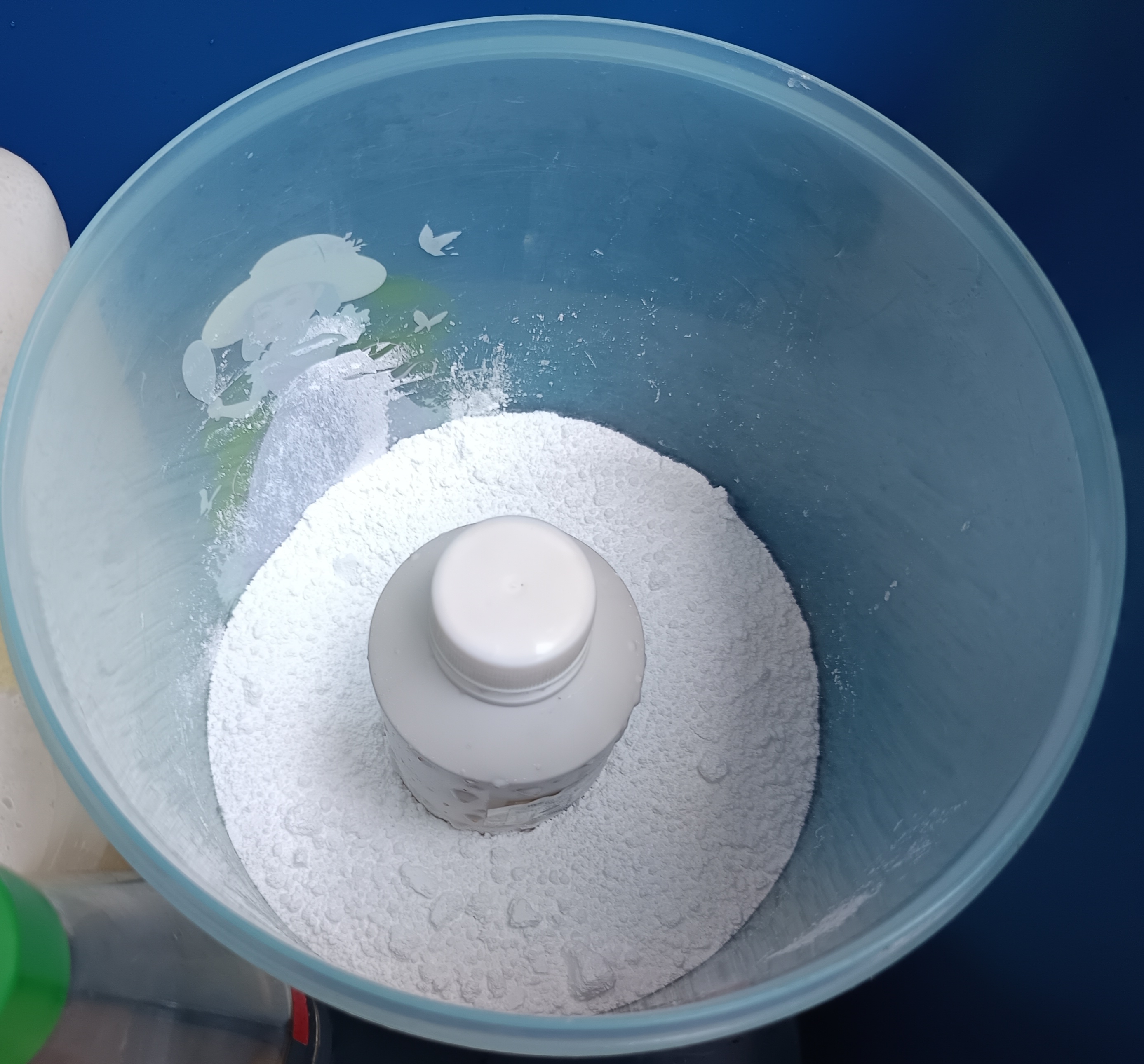

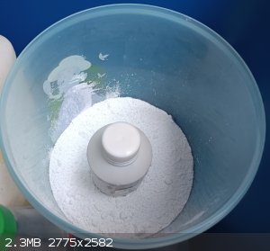

neutralising and disposing, plan A
After thinking it through, I'm not too keen on the CaCl2 option due to the HCl produced.
(55%HF = 32.4M, x500ml = 16.2 moles of HF converted to 16.2 moles of rust-generating HCl)
I'm considering agricultural grade Ca(OH)2 to produce the less soluble CaF2
which I could dispose of as solid waste to a landfill.
I have a few questions (Qn, where n>>3 but for now....)
(Q1= is this a sensible route?)
As calcium hydroxide is not very soluble I would:
. To a clean 45 litre black plastic bin (with lid) add a quantity of tap water
(Q2= how much water : more dilute = a calmer reaction but a greater volume to deal with)
. add the 500ml 55%HF to the water
. slowly add solid Ca(OH)2 until an excess has been added.
. evaporate by sunlight over days, with possibly a little added rainwater.
. collect, dry, contain the solid fluorite then send it to a landfill.
(Q3= any suggestions?)

I think there is a chance that reaction with Ca(OH)2 will not go to completion. This is just a safety remark. A constructive remark was given before.

Neutralise it like @woelen suggested in page 2 and add an excess of calcium chloride. Then you can do whatever you please with it: collect the solid and send to a landfill, give it a free toilet ride, store it for later, make a nice concrete block with it.
