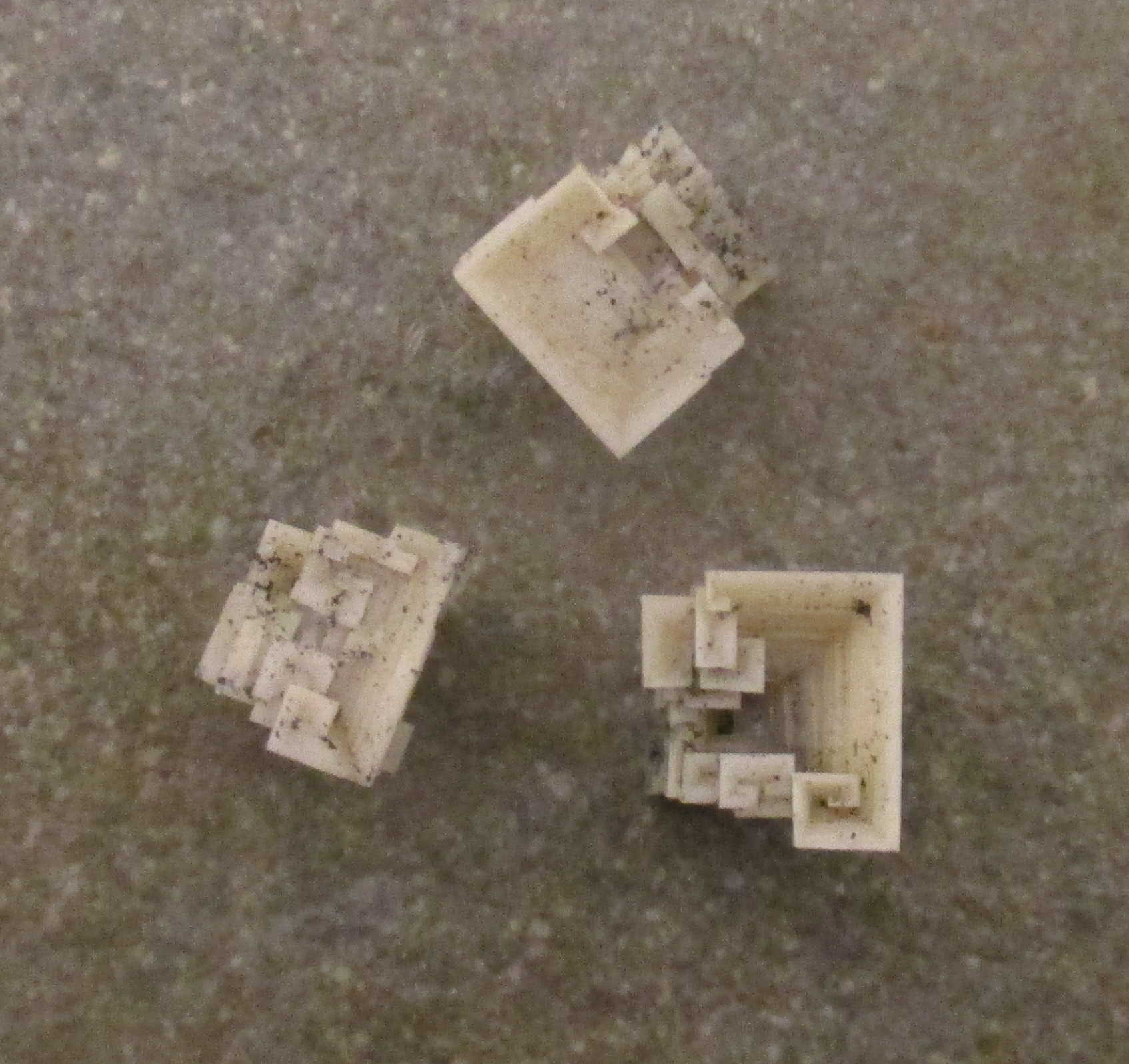

While emptying out the flask from one of the reaction I found these beautiful hopper salt crystals in the black residue. They are about 9mm on edge, there were larger ones but they were not so cute.
salt hoppers.jpg - 189kB
[Edited on 11-1-2021 by Boffis]
