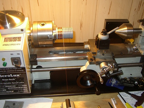

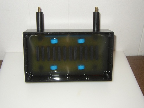

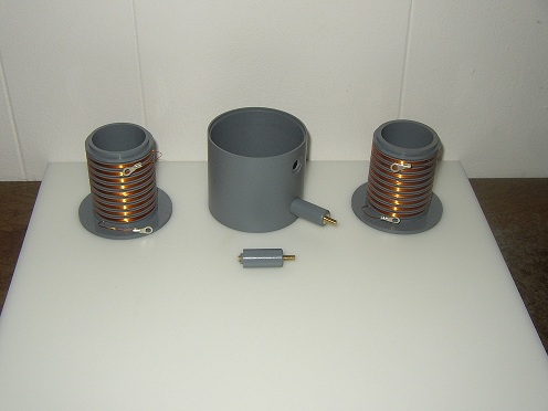

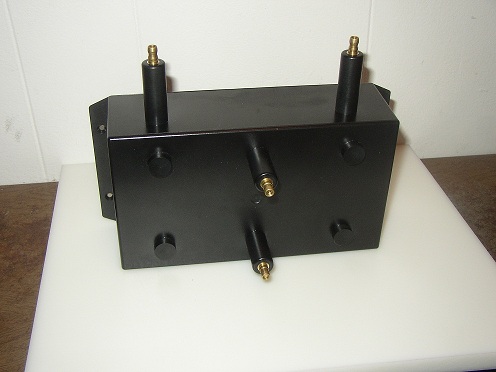

So far I've been mostly working with plastics and some brass. (I'm interested in high voltage pulsed-power stuff).
I got so frustrated trying to do simple things - without much success - that I finally went out and bought a mini lathe. And then later a mini mill.
I've made various coil formers, potting cups, coils, feed-through insulators, and complete high voltage, high frequency transformers. And also voltage multipliers.
(Right now I'm refurbishing some used high power spark gap switches I got from ebay).
Coil Winding.jpg - 93kB Coil With Feed Thru Insulators.jpg - 57kB Layer Wound Coil.jpg - 88kB Segmented Coils.jpg - 44kB Coil_In_Chamber.jpg - 114kB Xformer_Assy_2.jpg - 53kB Multiplier Inside.jpg - 45kB Multiplier.jpg - 45kB
