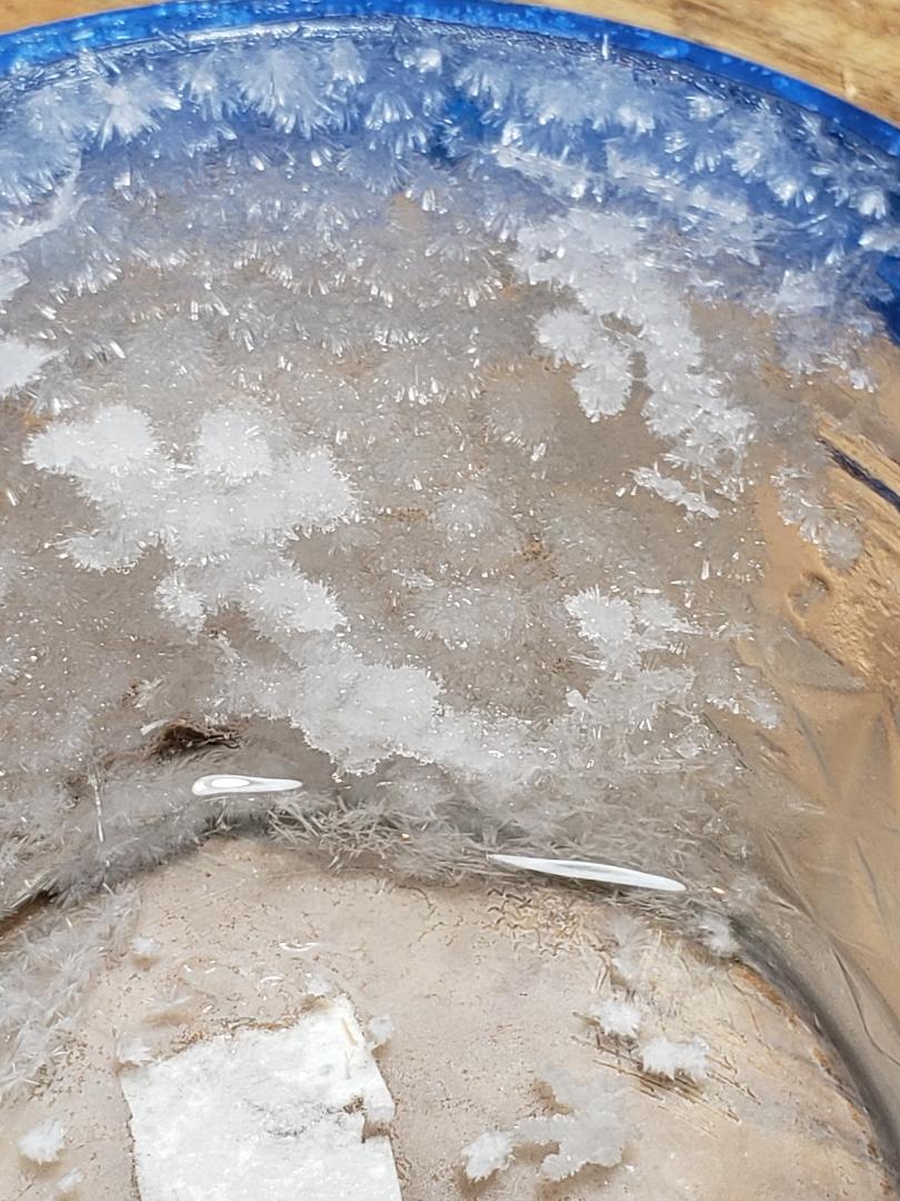

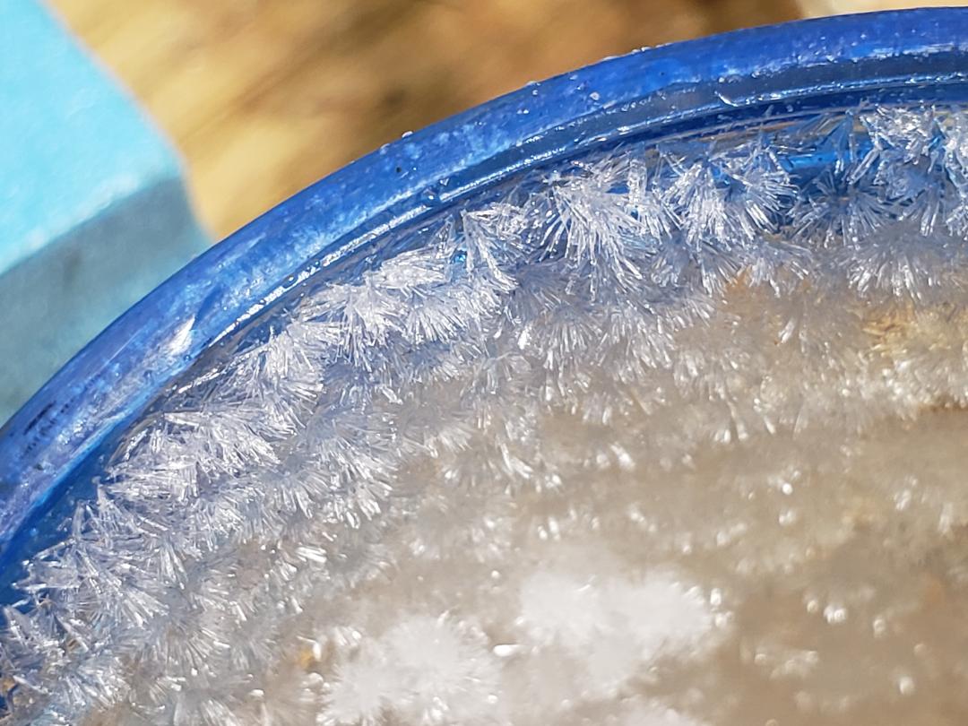

So, I attempted to dry it some more, using gentle heat and then vacuum. I got it down to a fairly small amount of liquid. I think it was nearly
water free. I added more methanol and put it back in the freezer for a day. Today there was something there. I thought maybe ice, and in fact some
did melt, although reluctantly. Still 2 hours after I took it out, it has been at RT for a while now and Ive still got about half of the mass
unmelted. May be a mix of DAUDN and water? Strange also since the first time I had it in the freezer for a day and a half and got NO crystals or
ice. If anything there should be less water in it now, yet I'm getting this:
![thumbnail (21).jpg - 130kB](http://www.sciencemadness.org/talk/files.php?pid=617199&aid=76219)
most of that has melted but there is still some that is definitely a solid, at RT for 3 hours now.
[Edited on 9-7-2019 by twelti]

Do you know what the solubility of DAUDN is in this solvent system? The "melting" that you see may actually be the product dissolving as the
temperature rises and the solubility therefore increases.
About the dessicants: P2O5 is certainly a stronger dessicant than concentrated sulfuric acid. In fact also stronger than SO3, since P2O5 can dehydrate
sulfuric acid to form SO3 and phosphoric acids of diferent kinds.
