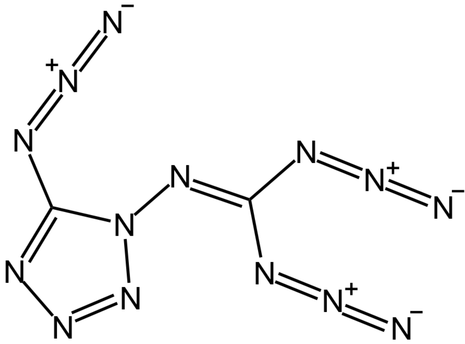

Synthesis of 1-Diazidocarbamoyl-5-azidotetrazole (C2N14)
So, for quite a while now I‘ve been wanting to try making some 1-diazidocarbamoyl-5-azidotetrazole, commonly referred to as “azidoazide azide“, as it’s one of the more chemically interesting energetics in my opinion, and it has quite a reputation of being the most sensitive one out there. While the second claim has pretty much been disproven by YouTubers like ReactiveChem and Explosions&Fire [1][2], for being completely heavy-metal free I still consider it to be quite an impressive substance, and kinda wanted to see for myself.
IMG_8487.jpeg - 174kB
Fig.1: Chemical structure of C2N14

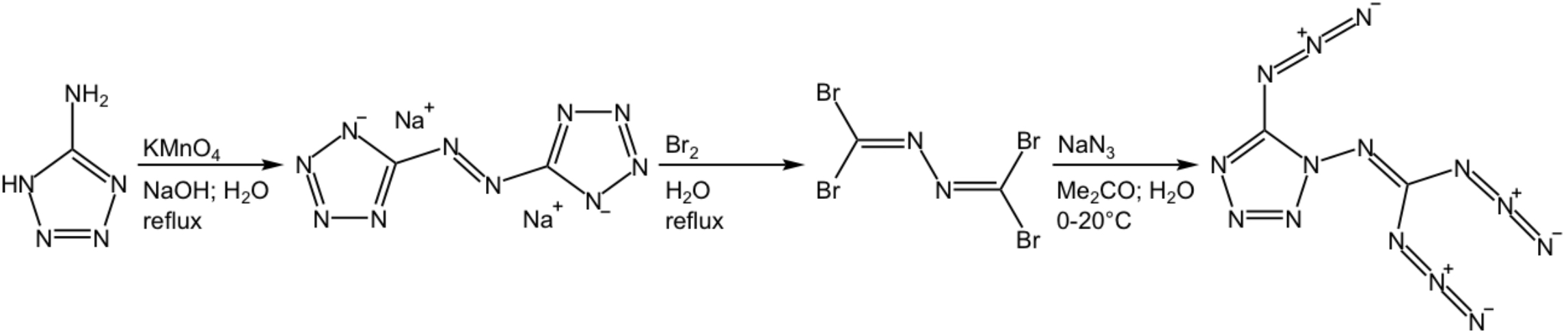

The 1961 approach by Grundman and Joseph [3]:
This is the approach most generally employed, and the synthetic details are given in Engager’s publication, which was my primary source for the entirety of the preparation [4].
The synthesis starts from 5-aminotetrazol (5-ATZ), which gets oxidatively coupled to the above mentioned azobistetrazolate, which then serves as a precursor to the isocyanogen-system by reaction with elemental bromine. The resulting tetrabromide can then undergo simple substitution with azide, and the resulting “open form“ of C2N14 (isocyanogen tetraazide) quickly cyclizes resulting in the desired end product.
IMG_8475.jpeg - 139kB
Fig.2: The 1961 synthesis of C2N14

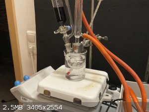

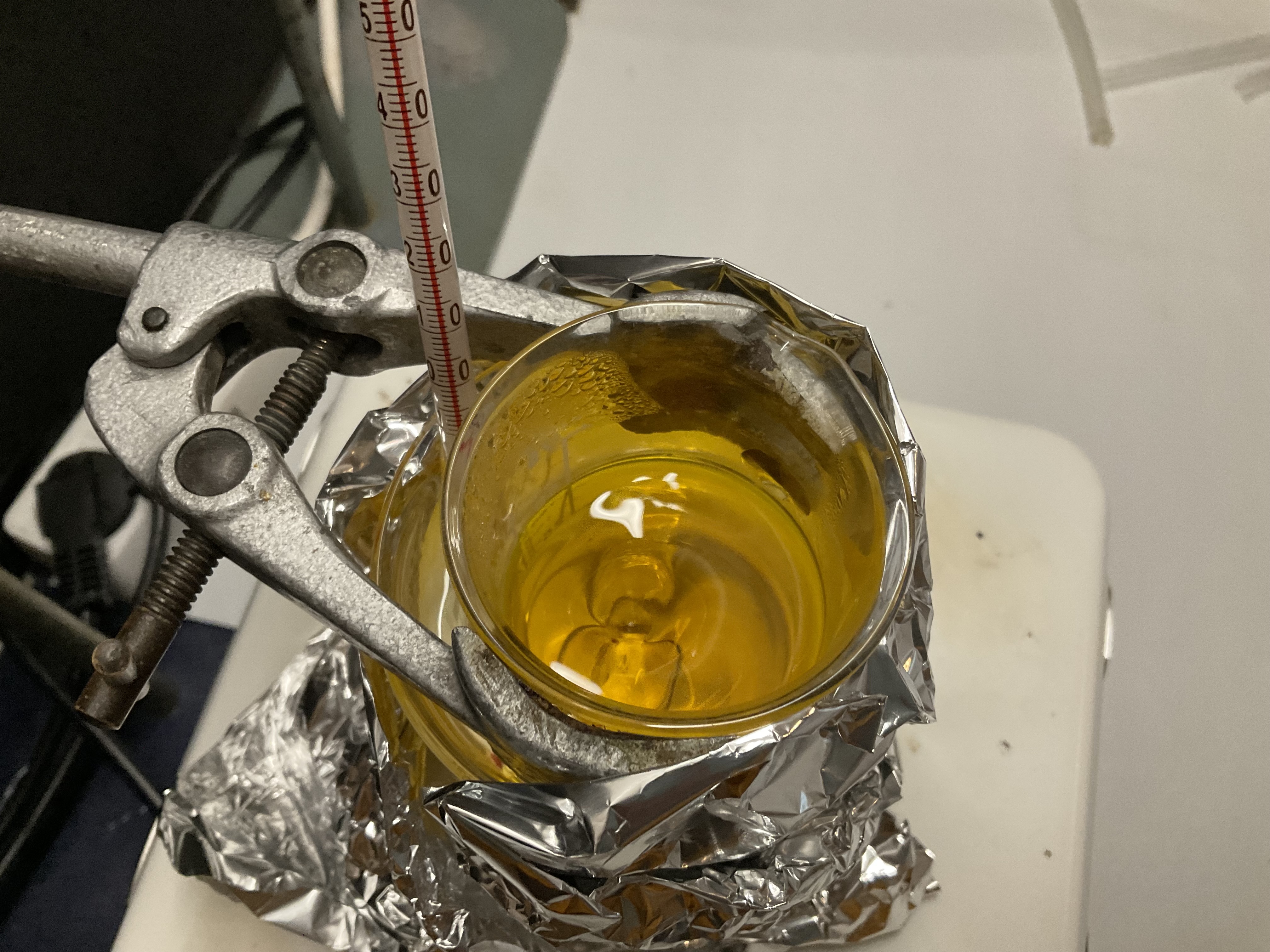

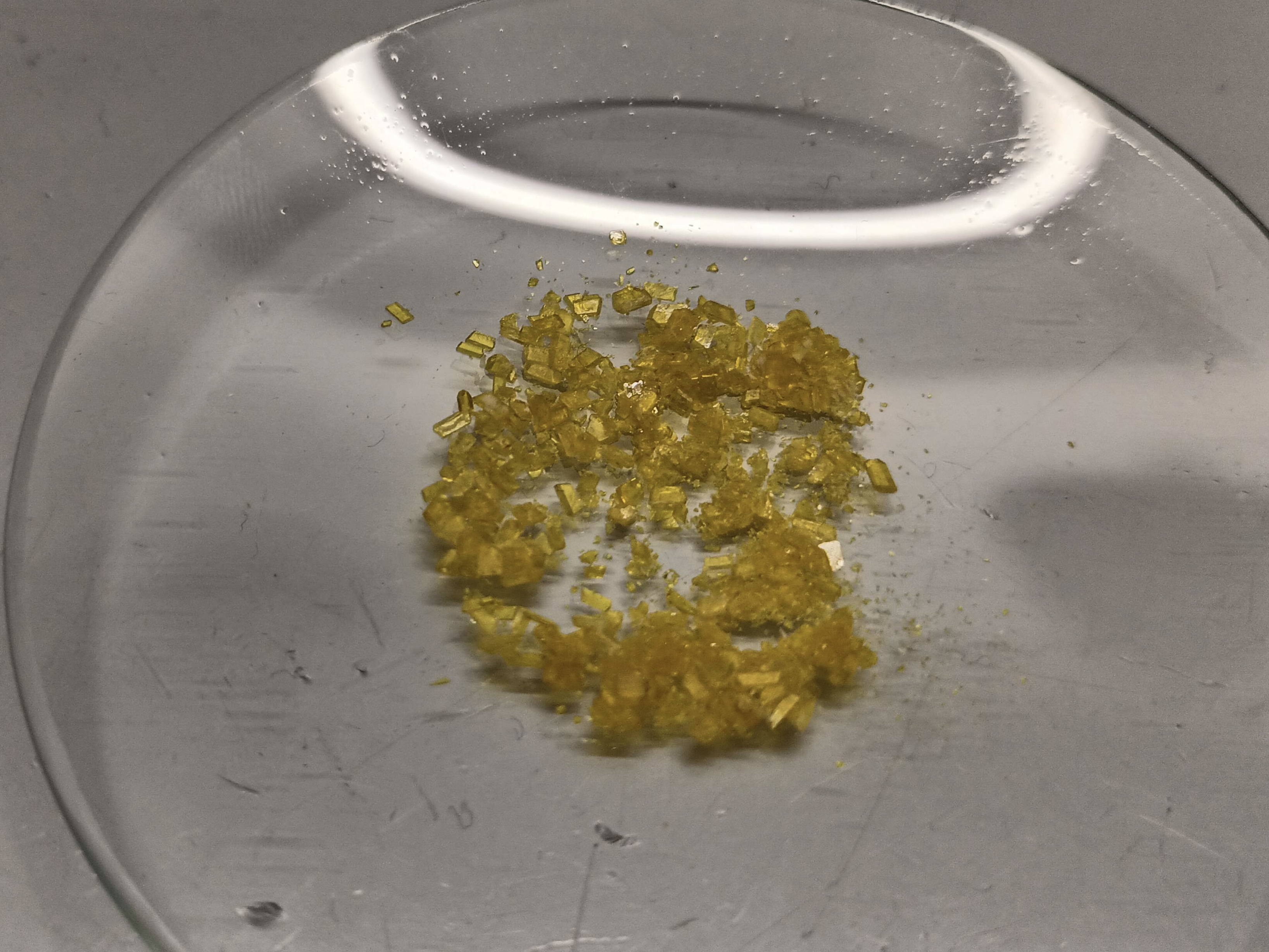

Disodium azobistetrazolate pentahydrate:
As I did this synthesis quite a while back, and my labnotes were rather scattered at the time, I unfortunately don’t have any of my experimental details on hand, though in the end I just followed the procedure given in [4] pretty much exactly, only adding the potassium permanganate as a saturated solution rather than as a solid, so by checking on it you should still be able to follow.
As one may expect from the nitrogen-rich structure this intermediate is already an energetic itself, and while testing some crystals of it on some aluminum foil does cause some rather significant damage (footage of some of its detonations can be found in Extractions&Ire‘s video covering this preparation [5]), as it’s a pentahydrate salt it’s impossible to properly confine it though. While it would therefore generally be advisable to store it wet, but as I didn’t notice any shock or friction sensitivity it was simply kept as the dry crystals shown.
IMG_3031.jpeg - 2.5MB IMG_3035.jpeg - 2.9MB
Fig.3-4: Synthesis of disodium azobistetrazolate and carefully evaporating down the final solution
20230530_162940.jpeg - 566kB 20230530_163056.jpeg - 327kB

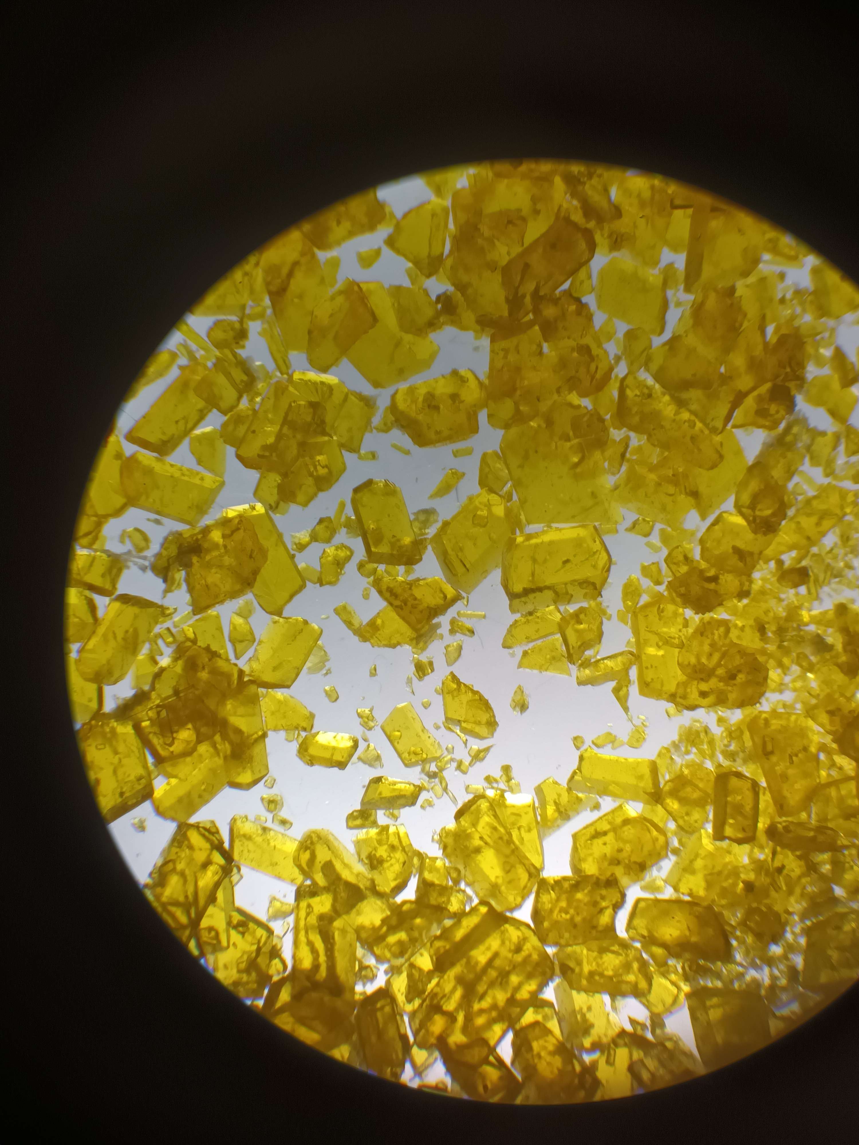

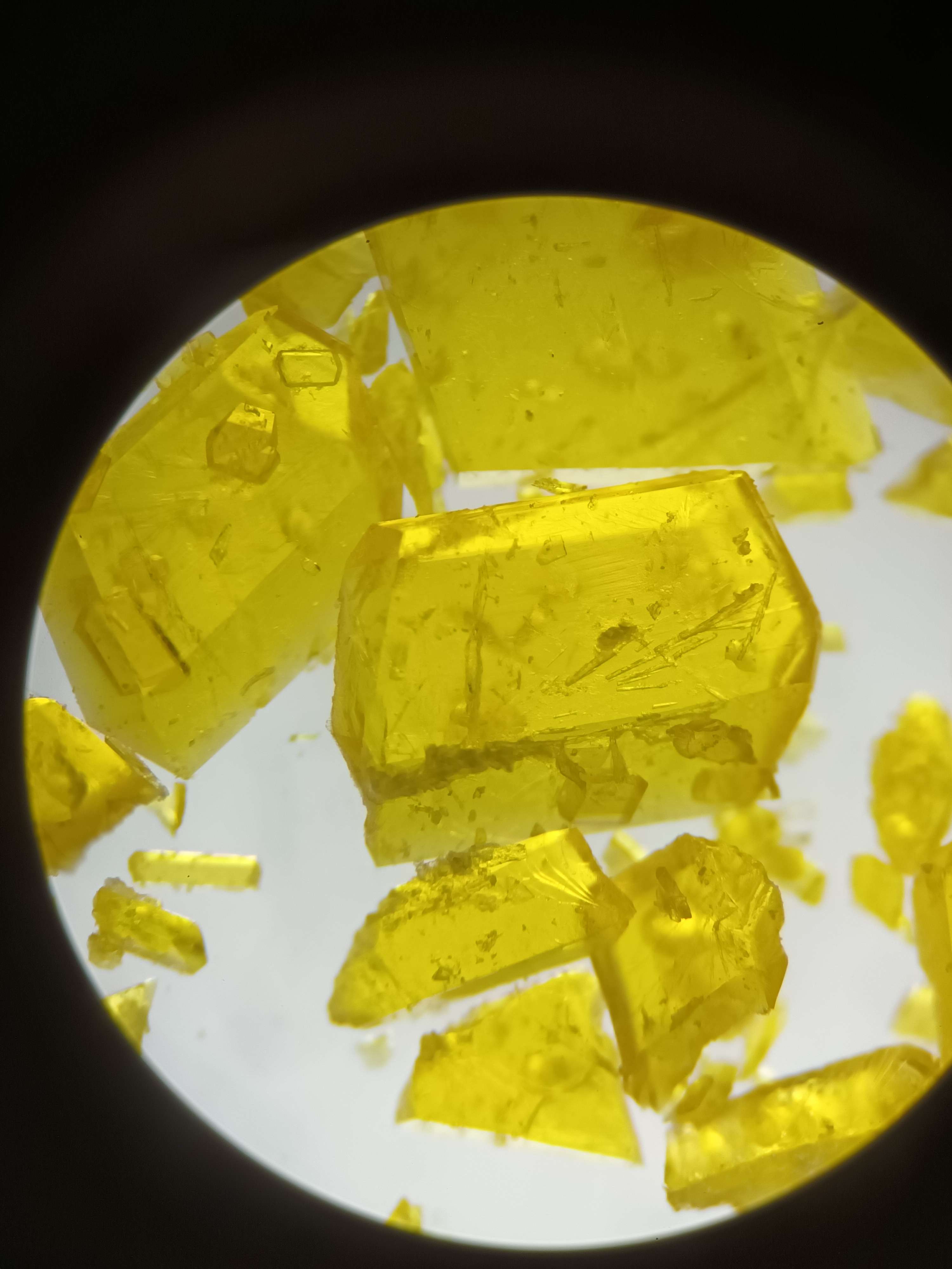

Fig.5-6: The product under the microscope
20230530_162817.jpeg - 1.7MB
Fig.7: Crystals of disodium azobistetrazolate pentahydrate

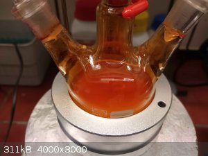

Isocyanogen tetrabromide:

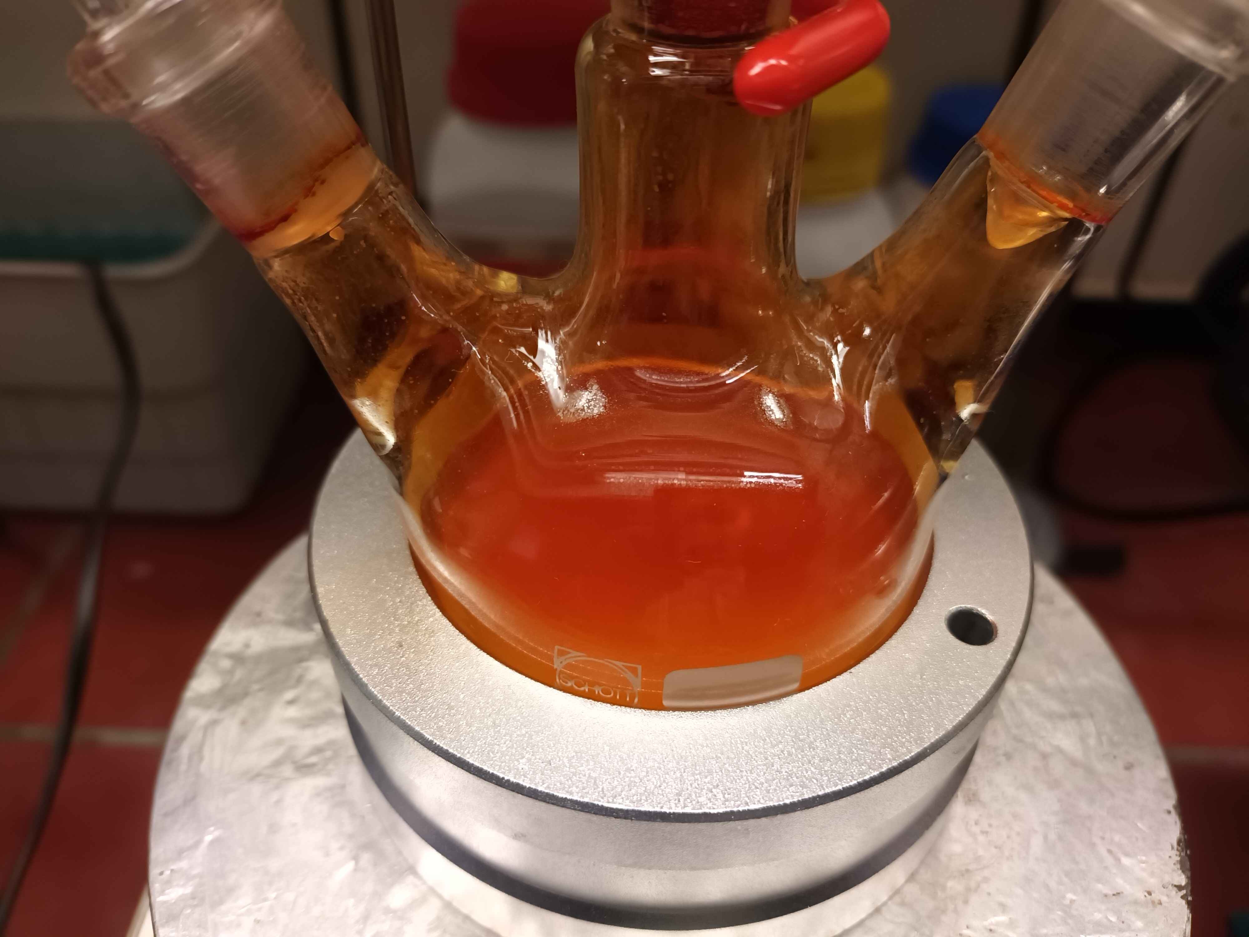

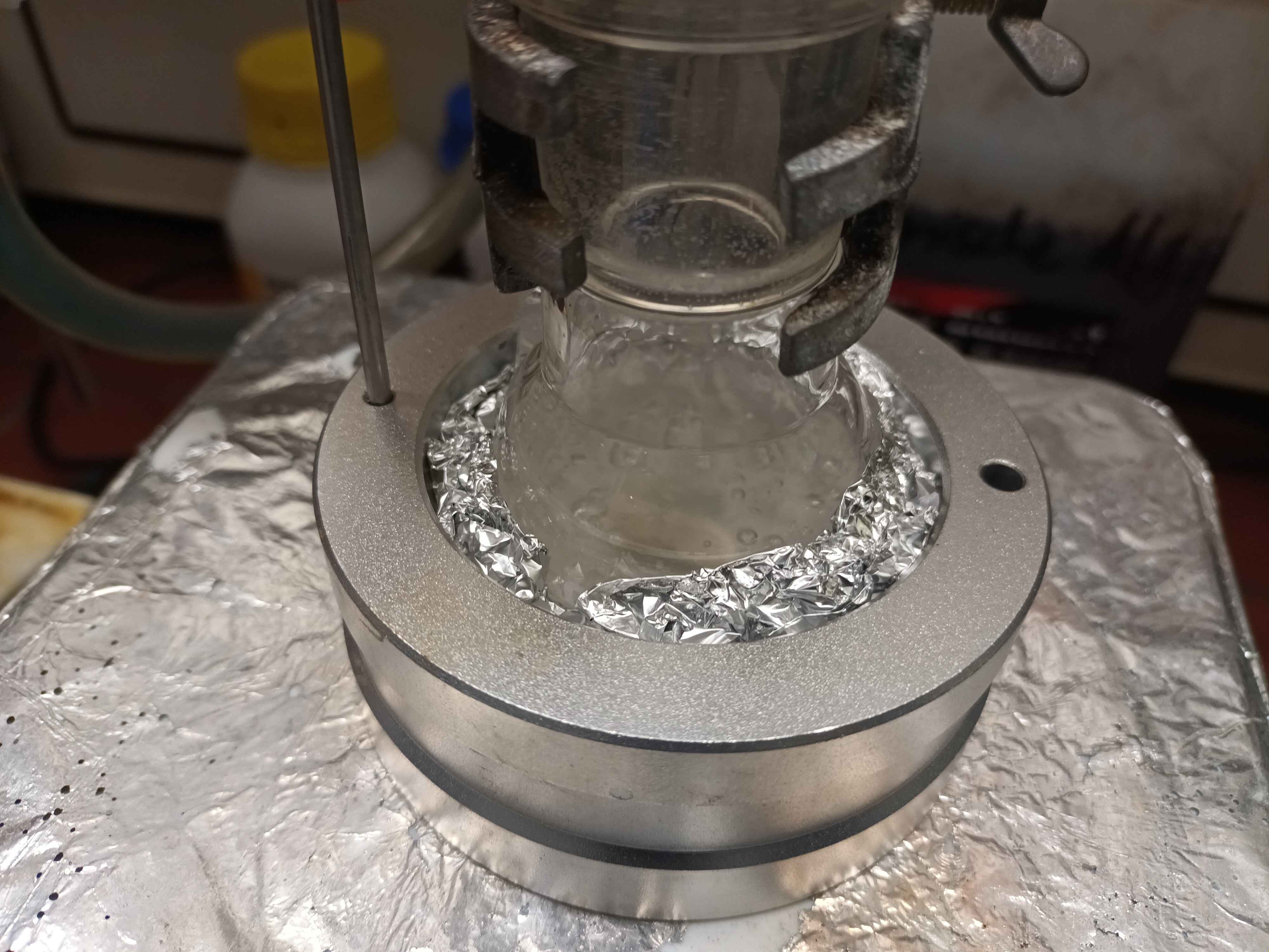

A 100 ml three neck round-bottom-flask, equipped with a Dimroth-condenser, was charged with 0,75 g of elemental bromine (9,4 mmol; made by the oxidation of sodium bromide with potassium persulfate in 95,6% yield), suspended in 20 ml of dest. water. To this, while stirring, a solution of 352,3 mg of disodium azobistetrazolate pentahydrate in 15 ml dest. water was slowly added dropwise, at which point some gas evolution quickly became evident. The mixture was refluxed in a heating block for 3 h, during which time the red bromine color increasingly discolored, and a red oil separated, which eventually “steam-distilled“ into the condenser collecting as a beige solid. The condenser was washed out with DCM, the light yellow reaction mixture extracted more three times, and the pooled extracts washed with saturated brine and dried over anhydrous sodium sulfate. The solvent was removed by rotary evaporation, resulting in a yellowish-green oil, which solidified into a crystalline solid on cooling to room temperature. This crude product is sufficiently pure to be used in the final step of the preparation. 136 mg, 31,3%
20250201_153255.jpeg - 310kB 20250201_155200.jpeg - 311kB
Fig.8-9: Synthesis of isocyanogen tetrabromide
20250201_202715.jpeg - 211kB
Fig.10: the collected crystalline isocyanogen tetrabromide

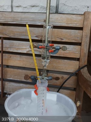

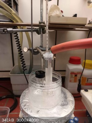

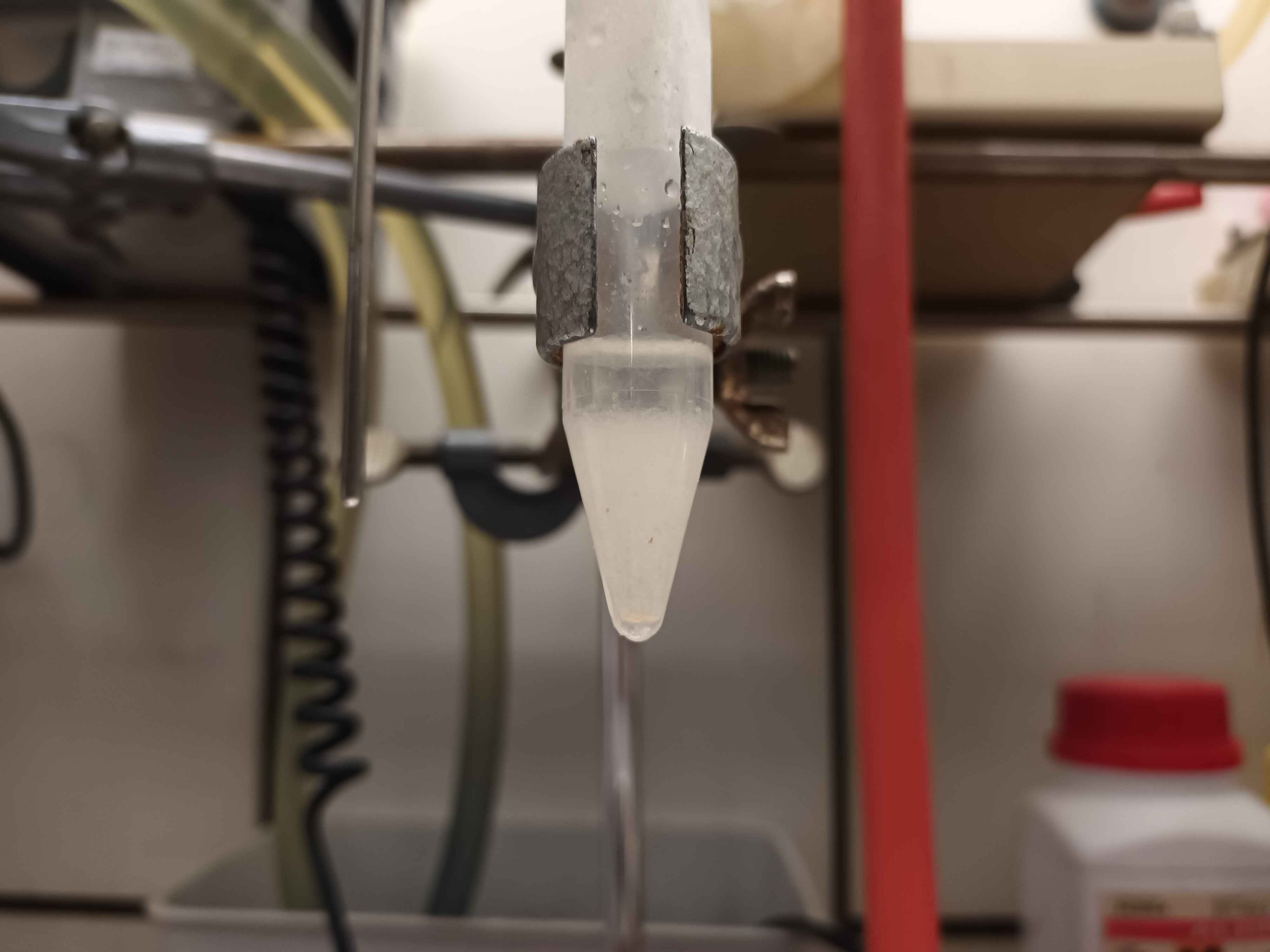

1-Diazidocarbamoyl-5-azidotetrazole:

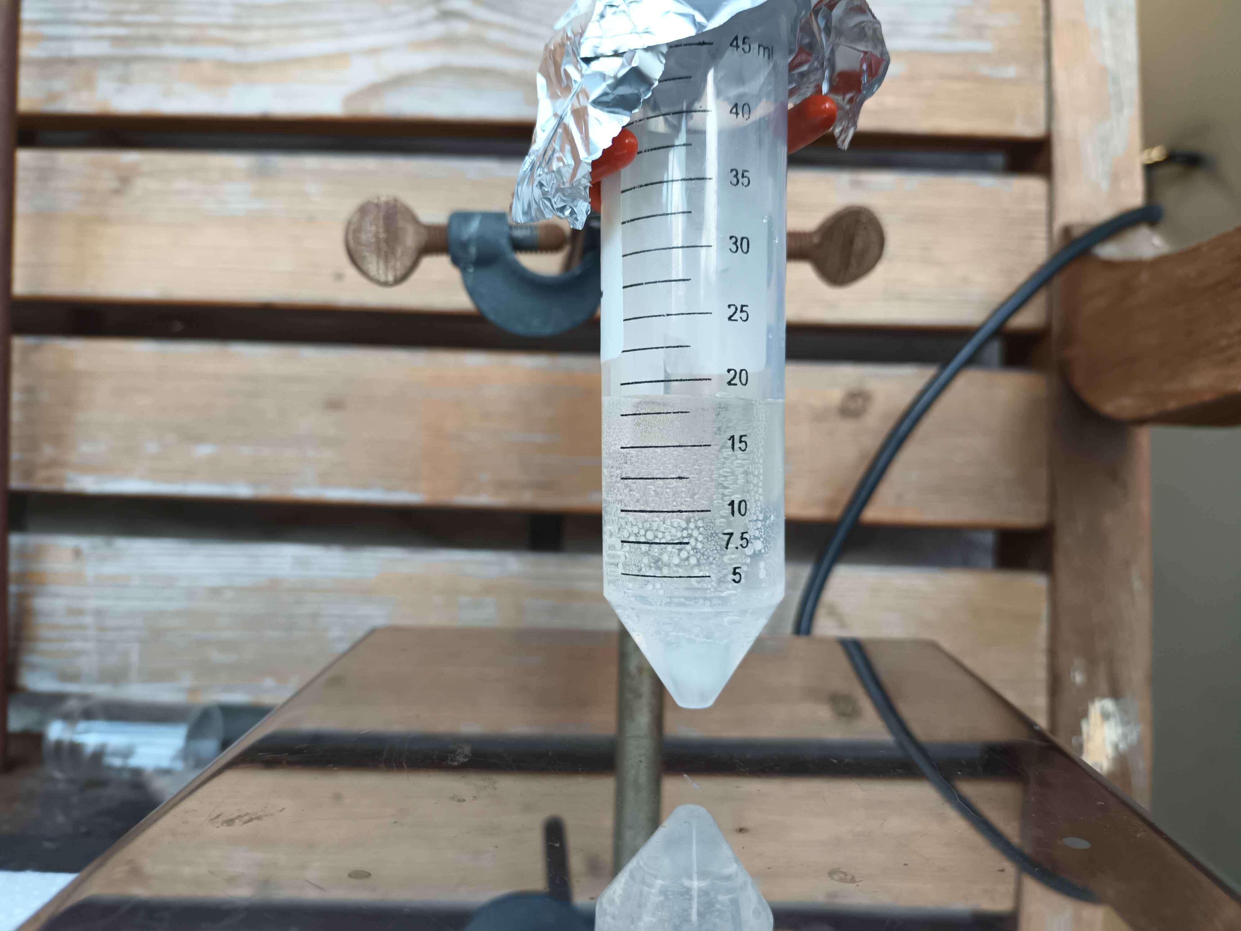

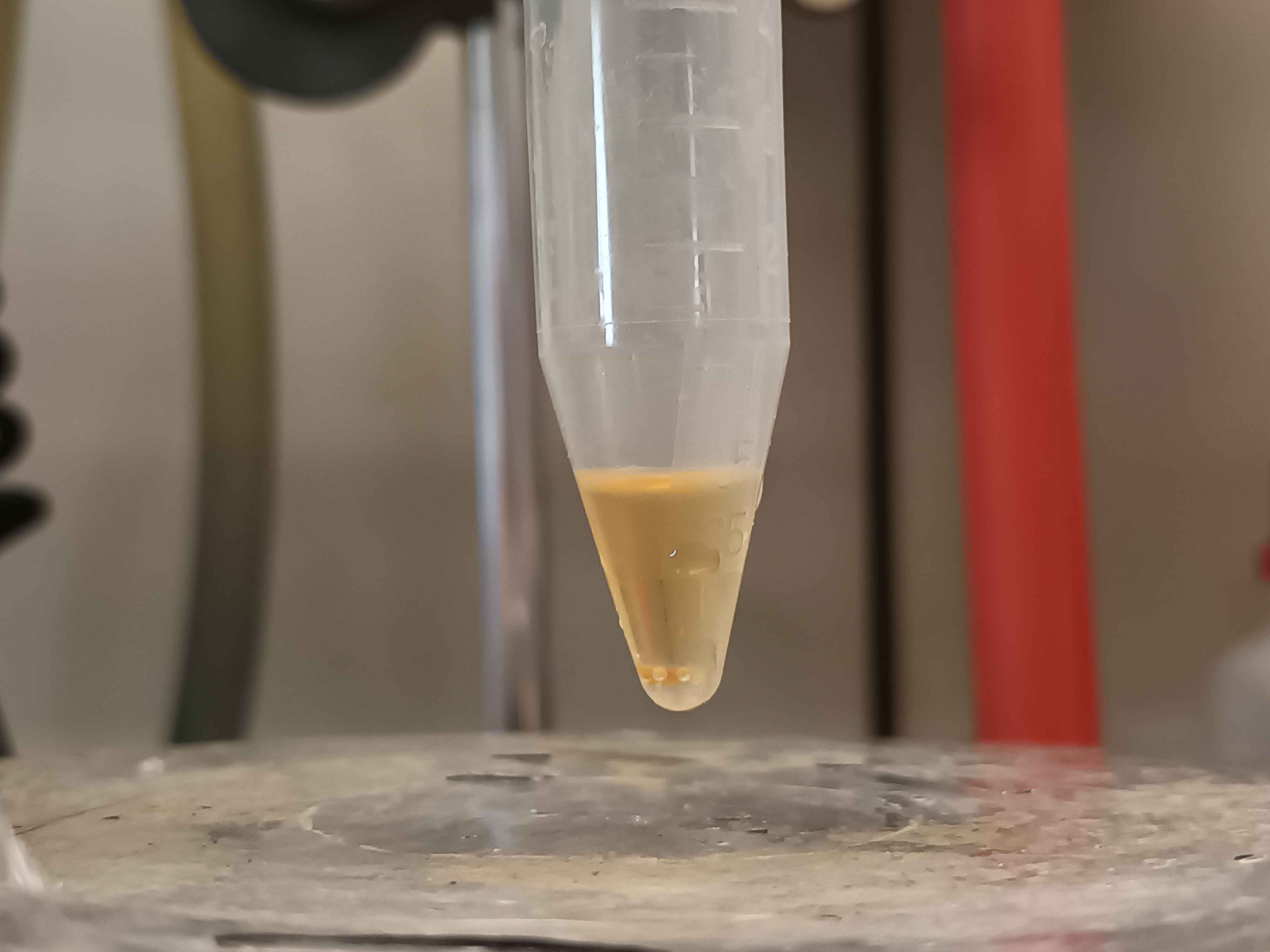

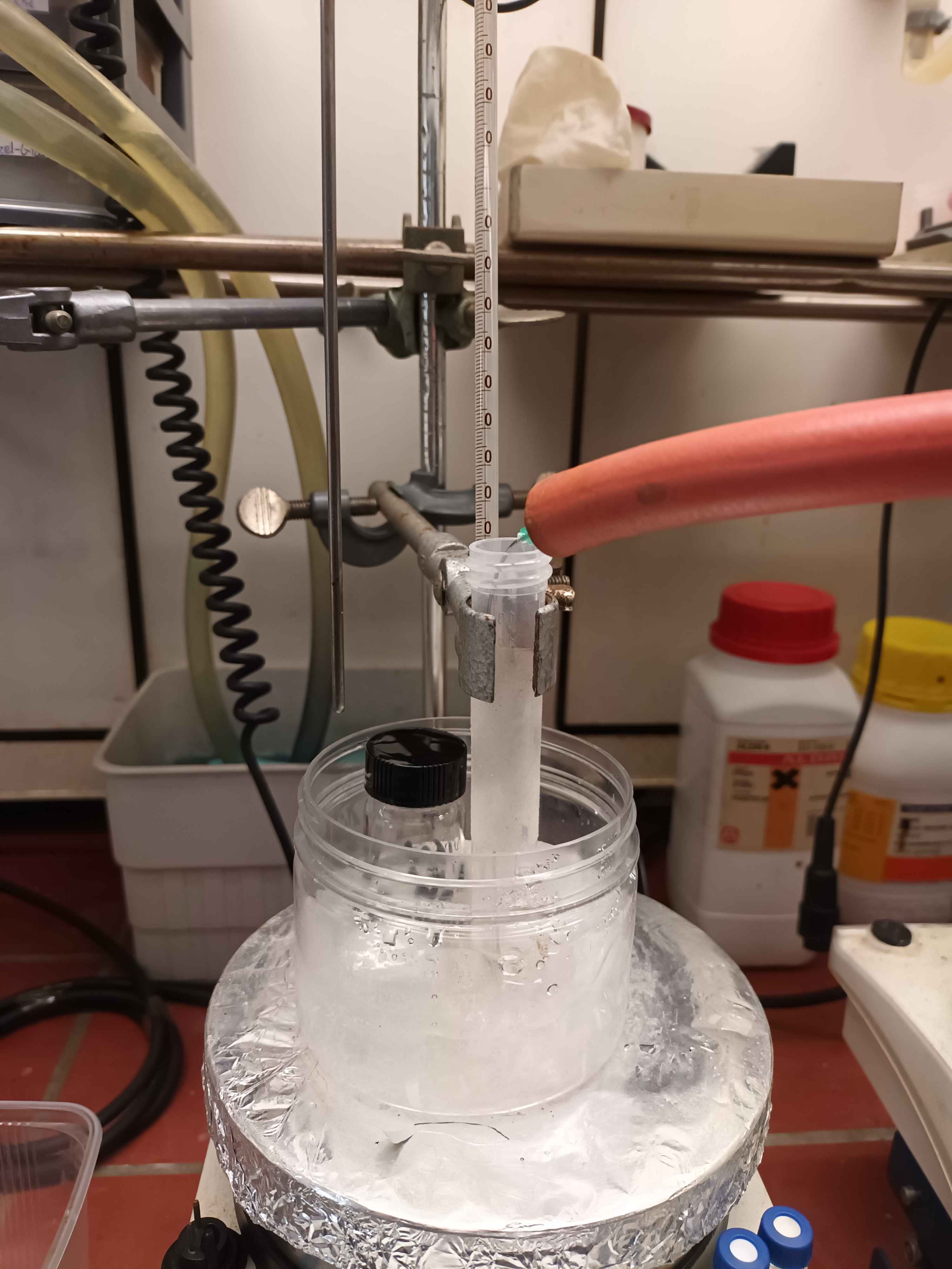

In a 10 ml falcon-tube 25 mg of the isocyanogen tetrabromide (67,3 μmol) were dissolved in 0,3 ml of acetone and and the greenish solution cooled to around 0°C with the help of an icebath. The mixture was purged with argon for around a minute, and the tube loosely capped to ensure somewhat inert if an atmosphere. To this 150 μl of a solution of 0,9 g sodium azide in 6 ml dest. water (346,1 μmol), cooled in the same icebath, were slowly added dropwise with occasional swirling of the reaction vessel, and things were then left to stand first for 1 h at 0°C and then 3 h at room temperature. After this 2 ml of dest. water were added to the now orangish solution, and things left to stand in the icebath for 45 min to allow the product to separate. Nothing really happened though until the walls of the tube were very carefully scraped with a plastic pipette, on which a white crystalline solid gradually precipitated. This was removed by gravity filtration, the residue washed with some more water, and the wet white crystals used as such for further experimentation and energetics testing. The footage of those tests can be found in [6].
20250202_121340.jpeg - 341kB
Fig.11: Synthesis of C2N14
20250202_131332.jpeg - 166kB 20250202_172816.jpeg - 183kB
Fig.12-13: The reaction mixture before and after the addition of the water

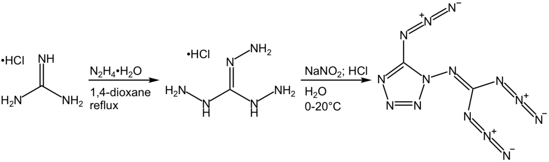

The 2011 approach by Klapötke [7]:
This approach seems much less accessible on first glance, starting from triaminoguanidine hydrochloride in the original publication. This precursor can actually easily be prepared from widely available guanidine hydrochloride though, and I personally based myself on the procedure given in [8]. This doesn’t just make it a particularly easy approach though, and the key-dimerization (for mechanistic details check out [7]) actually is really pH-sensitive to the extent that tracking the pH with pH-paper doesn’t really suffice [9]. Therefore I may revisit things as soon as I get a proper pH-probe.
IMG_8497.jpeg - 163kB
Fig.14: The 2011 synthesis of C2N14

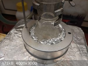

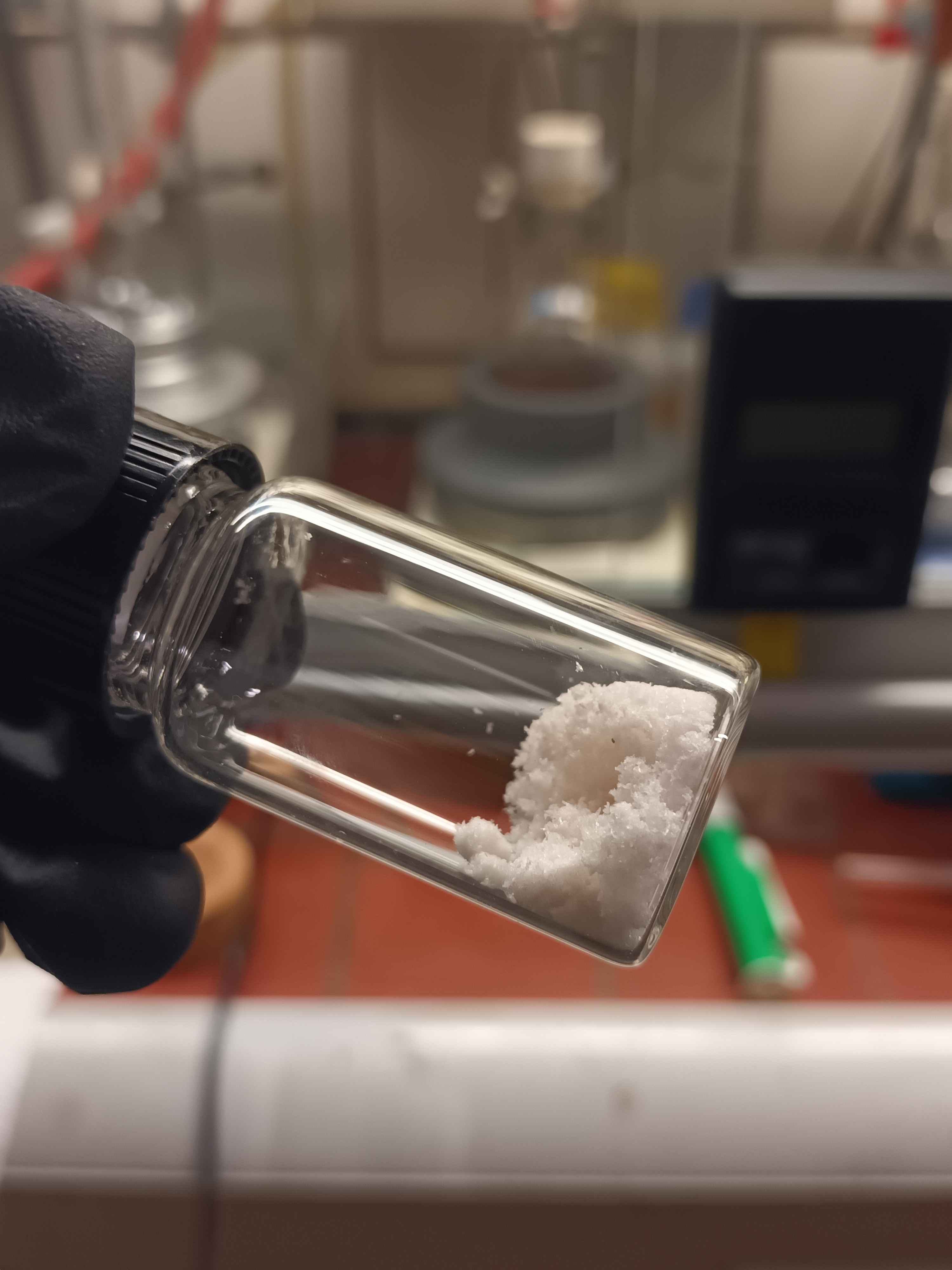

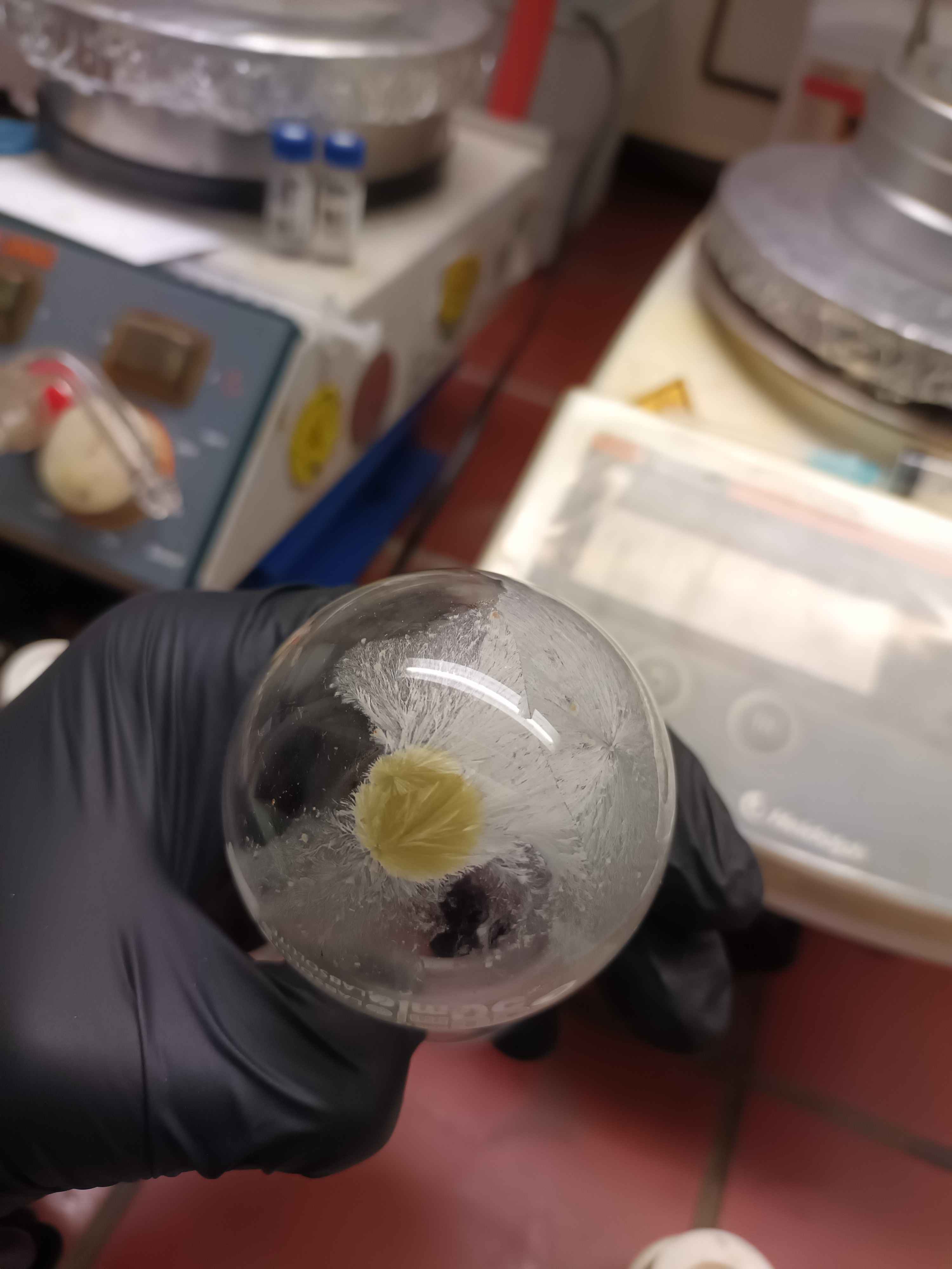

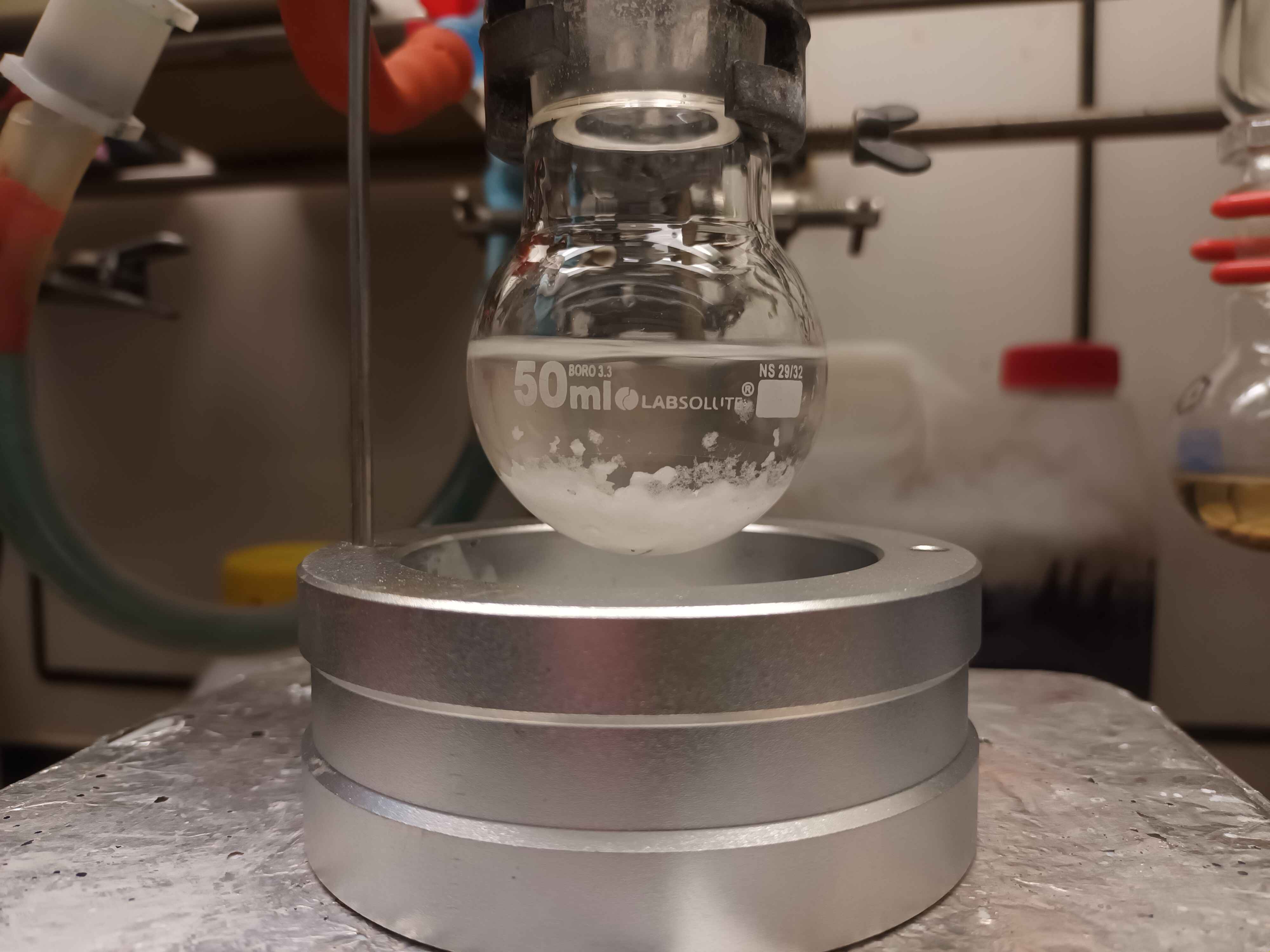

Triaminoguanidine hydrochloride:

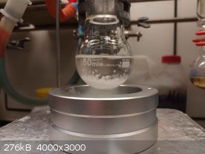

In a 50 ml round-bottom flask, equipped with a Liebig-condenser, 970 mg of guanidine hydrochloride (10 mmol) were dissolved in 25 ml of warm dioxane and 3,7 ml 100% hydrazine hydrate (75 mmol) quickly added over the course of one minute. The colorless mixture was heated to a reflux in a heating block for 3 h, with some ammonia generation quickly becoming evident (detectable by holding some wet pH-paper over the opening of the condenser), and a white solid starting to precipitate. Things were cooled left to cool down over night, during which time the mixture seemed to have pulled some moisture from the air, so around 10 ml of the solvent were quickly removed by heating on the hotplate, and the precipitated solids removed by vacuum filtration after things had cooled back down again. The residue was washed with some diethylether and acetone, and the very slightly pinkish* crystals dried on the air. 983 mg, 70%
*This discoloration later turned a slight yellow, it can generally be expected to get a completely white product though as this presumably just came from the glassware being contaminated.
20250128_170445.jpeg - 471kB 20250128_201004.jpeg - 276kB
Fig.15-16: Synthesis of triaminoguanidine hydrochloride
20250129_172542.jpeg - 219kB
Fig.17: The collected slightly pinkish crystals of triaminoguanidine hydrochloride

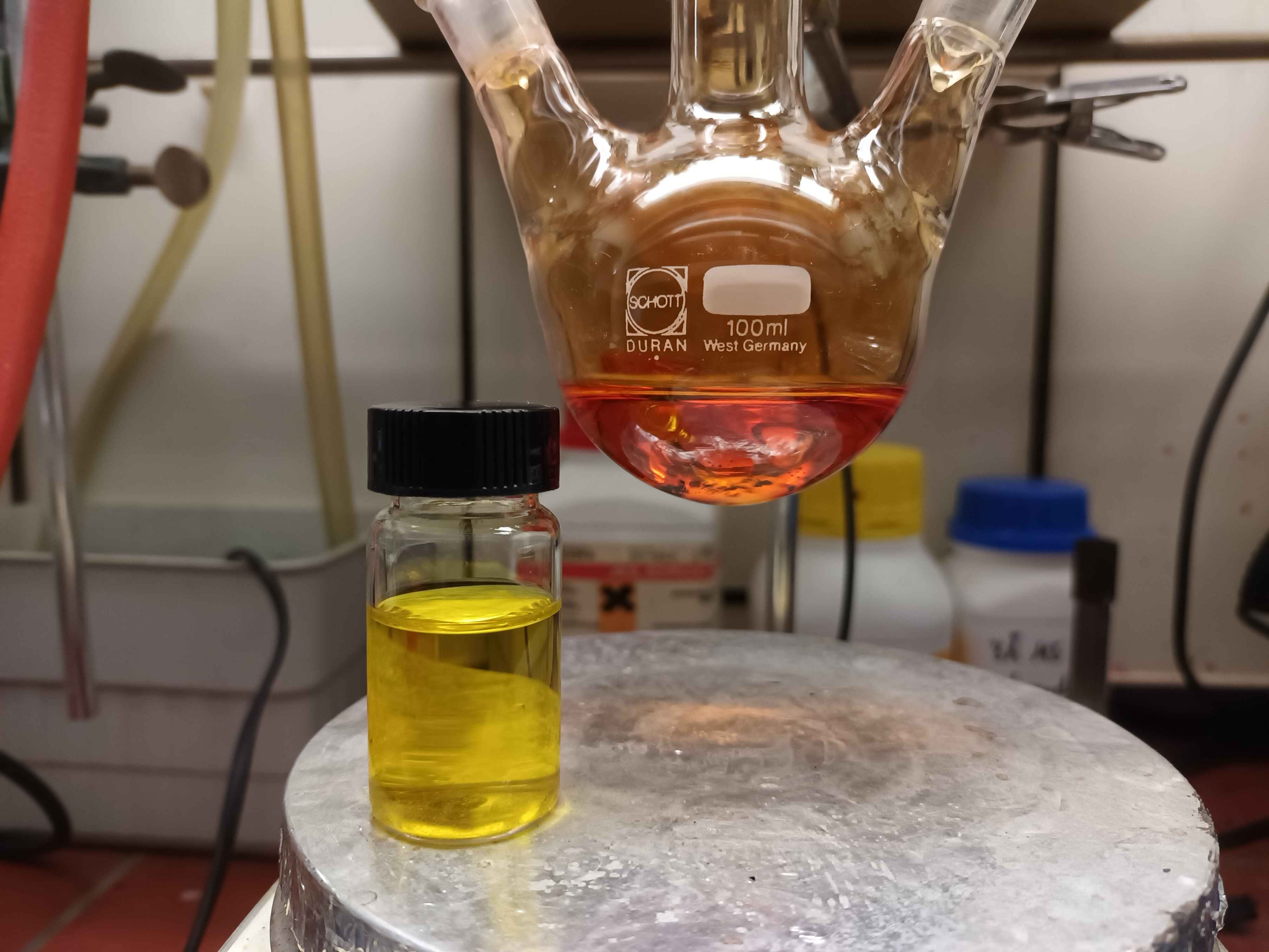

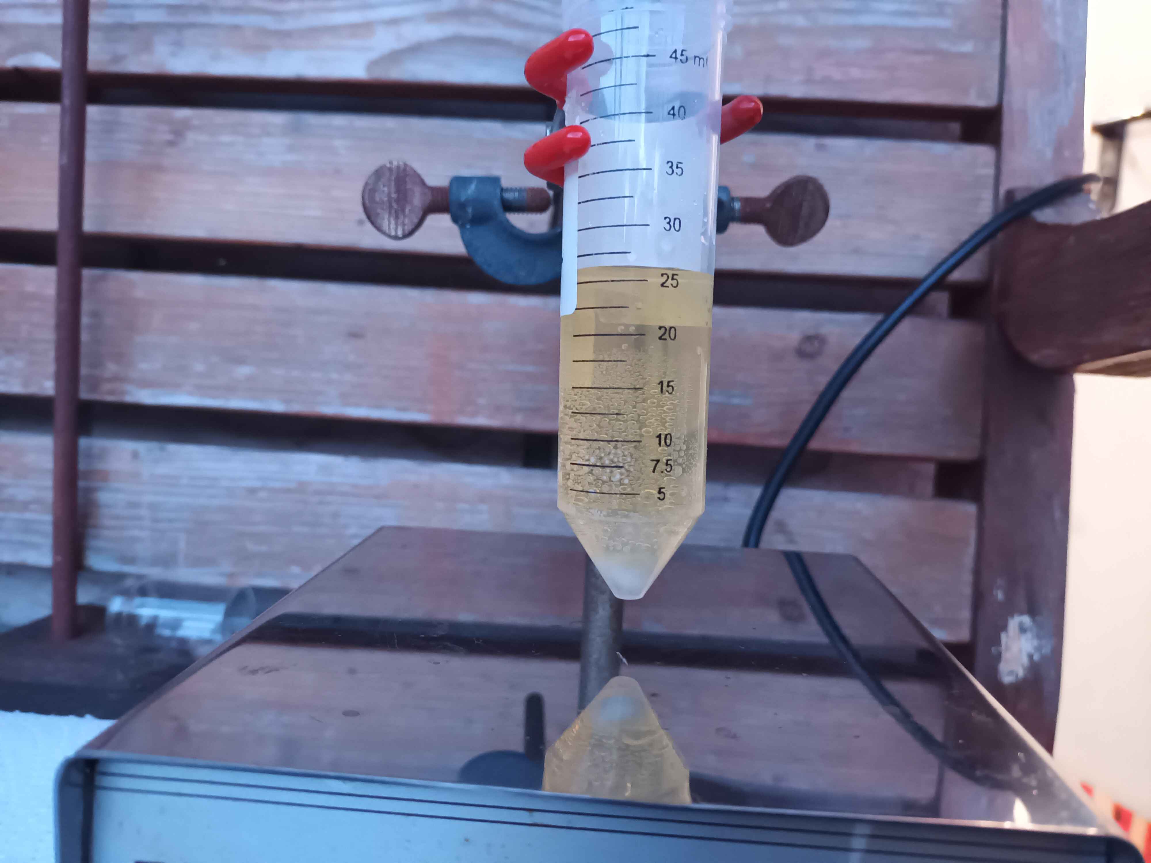

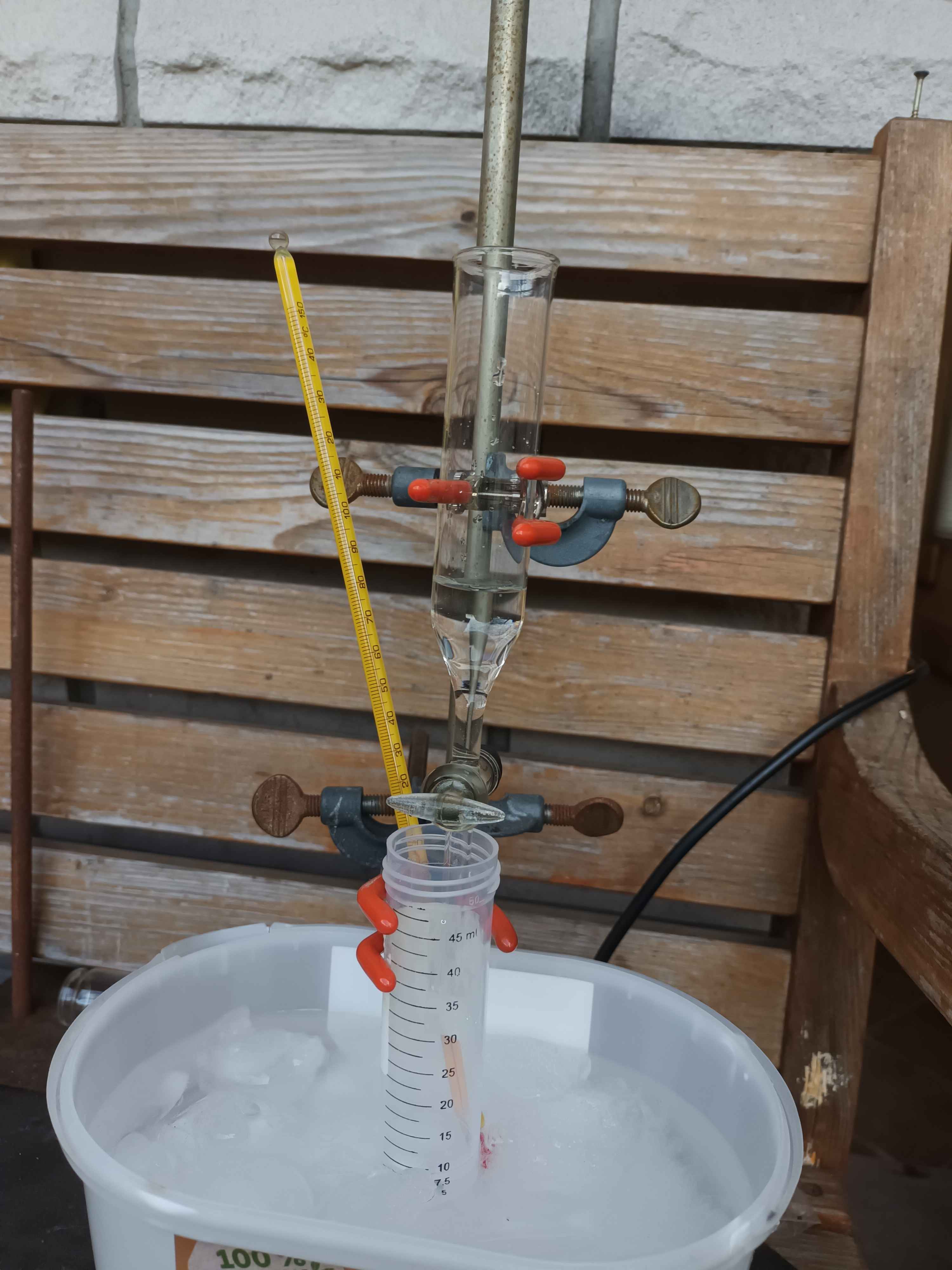

1-Diazidocarbamoyl-5-azidotetrazole (failed attempt):

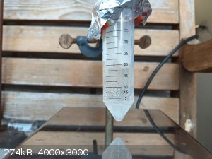

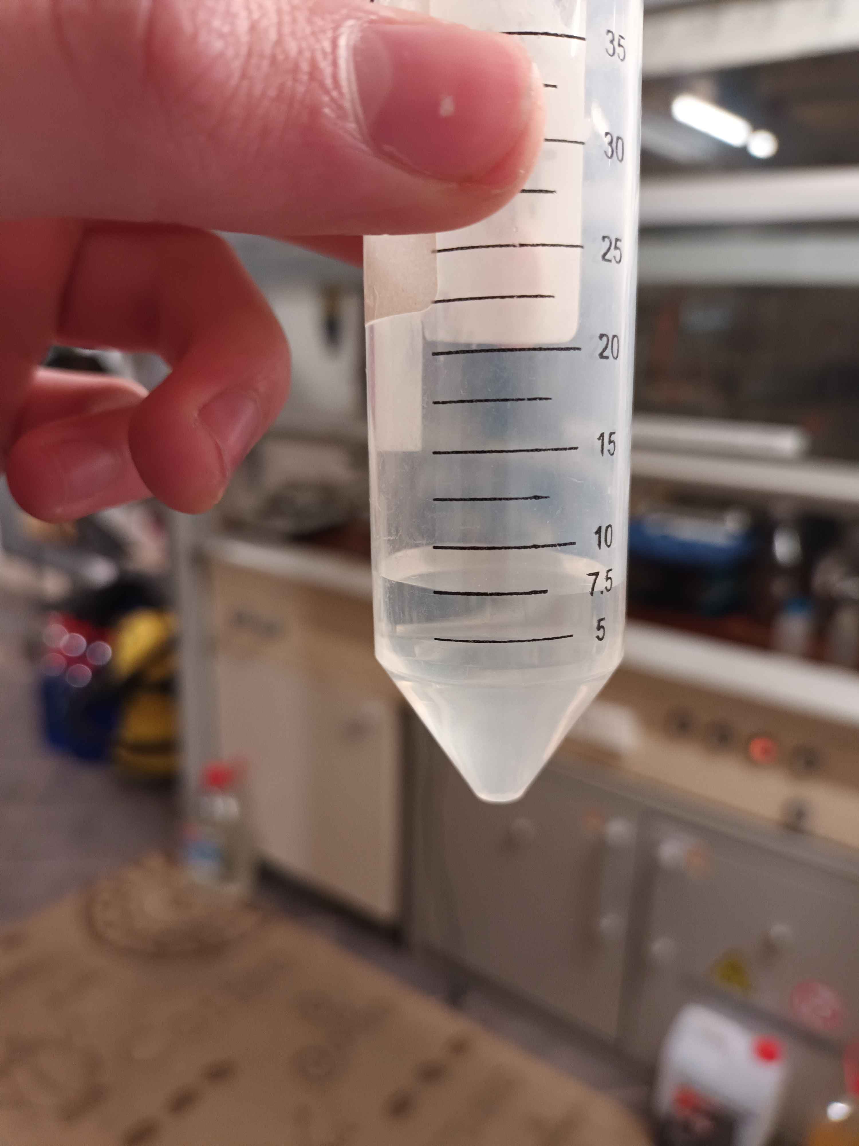

In a 50 ml falcon-tube 70,5 mg if the triaminoguanidine hydrochloride (0,5 mmol) were dissolved in 7,5 ml of dest. water, and 1 ml of 1 molar hydrochloric acid (1 mmol) was added to the colorless solution. Things were cooled to around 0°C in an icebath, a solution of 69,5 mg of sodium nitrite (1 mmol) in 7,5 ml dest. water was then very slowly added through an addition funnel while magnetically stirring, and the stirring continued for 45 minutes at room temperature afterwards. The pH was very slowly brought to exactly 8* by dropwise addition of 0,1 molar sodium hydroxide solution, during which the previously colorless solution gradually turned a yellow color. Things were extracted three times using 15 ml of diethylether each, by shaking inside the falcon-tube and removing the top layer with the help of a pipette, and the yellow extracts passed through a silica-filled syringe in hopes of removing some amine impurities which would otherwise require the use of a short chloroform column after isolation. The now light yellow extracts were carefully evaporated down in a 50°C water bath while, on which only a tiny quantity of a totally non-energetic yellow oil remained though, why this attempt was discarded.
*This was achieved using pH-paper in this run, what, as mentioned above, isn’t sufficiently precise for this reaction, why this presumably failed.
20250131_154225.jpeg - 207kB 20250131_161742.jpeg - 337kB
Fig.18-19: Failed attempt of synthesizing C2N14
20250131_164400.jpeg - 274kB 20250131_172543.jpeg - 245kB
Fig.20-21: The mixture before and after the addition of the base
