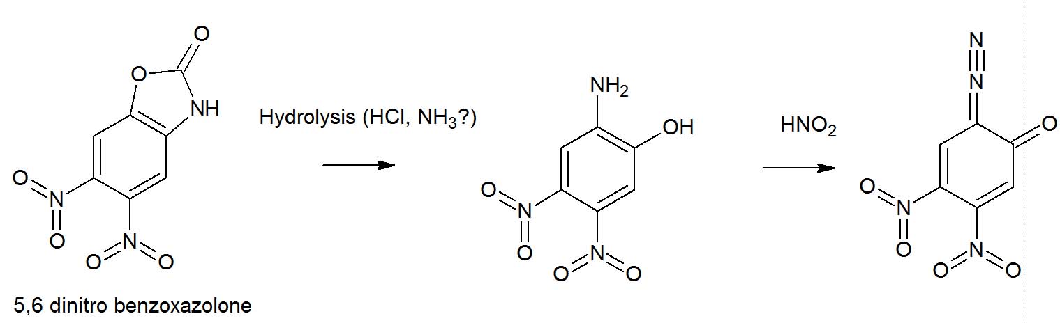

This was briefly mentioned before in the DDNP thread, though now I’ve had the time to do some reading regarding the potential use of benzoxazolone
to produce 2-diazophenols. In general, ring opening and deprotection are problematic and I doubt the nitration of benzoxazolone is able to produce di
or trinitro isomers other than the described ones below.
Benzoxazolone can be prepared by numerous routes, of which some are easily in reach for the amateur, completely OTC and high yielding:
1. Reaction of 2-aminophenol and urea in a mineral acid solution (sulfuric acid monohydrate, HCl, phosphoric US3812138)
2. Hofmann rearrangement of salicylamide under strongly basic conditions (CA 1150276 A1)
In general, the 6 (meta to the hydroxyl) and 5-positions of benzoxazolone are most activated, accordingly nitration using 65% nitric acid produces
almost exclusively 6-nitrobenzoxazolone, while further nitration using fuming nitric acid gives 5,6 dinitro benzoxazolone [1].
Although nitration using nitric acid alone is well described in literature, I couldn’t find many references regarding the products using mixed acid
nitration (nitric/nitrate salts+sulfuric). One option could be that concentrated sulphuric acid (being a stronger acid) leads to opening of the
oxazolone ring, which could influence the orientation during nitration to produce different isomers than those already described. Then again, heating
of 2-hydroxy phenylurea in sulphuric acid is mentioned to lead to ring closure and patent US3812138 describes condensation of urea with 2-aminophenol
using sulphuric acid to yield benzoxazolone, which would imply that either this depends on pH /sulphuric concentration or benzoxazolone is reasonably
stable in concentrated sulphuric, but not soluble enough or too activated for mixed acid nitrations.
One reference in which mixed acid nitration of benzoxazolone to 6-nitro benzoxazolone (92% yield) is mentioned is “Synthesis of
2-Amino-5-Nitrophenol by Two Step Process, Yin Zhenyan and Li Yanyun (2007)” They further describe hydrolysis the 6-nitro benzoxazolone using 96%
ethanol and NaOH, which would represent a usable OTC route to 2-amino 5-nitrophenol.
Anyway, an idea that I had was that perhaps starting with 65% nitric and gradual addition of sulfuric acid (or even AN/SA and a good icebath) may
produce 5,6 dinitro benzoxazolone directly. Would it be possible to hydrolyse the oxazolone ring without hydrolysis of one of the 2 nitro groups? If
this would give 2-amino 4,5-dinitrophenol and diazotized would this lead to an undescribed isomer of DDNP, or would it be unstable? Reportedly,
2-diazo 5-nitrophenol is pretty stable and used in coupling reactions for dye manufacture. My hopes for the hydrolysis of the 5,6 dinitrobenzoxazolone
are not too high though, due to the reported stabilizing effect of a 5-nitro group against hydrolysis of the oxazolone ring [2] in combination with
likely increased susceptibility towards hydrolysis of the 2 adjacent nitro groups.
Anyway, any input on the behaviour of benzoxazolone during mixed acid nitrations or other ideas regarding the synthesis of energetic derivatives from

This may be interesting for you...6-carbamido-benzoxazolone from 6-amino-benzoxazolone and K cyanate.US Patent 2806853 A (downloadable into pdf format from there by clicking "téléchargez le pdf")
So
H2N-C6H3(-O-CO-NH-)cyclo turns into H2N-CO-NH-C6H3(-O-CO-NH-)cyclo
This may help prevent oxydation when nitrating.
To help a bit (by fixing the idea) I have made a synthetic pathway of your reaction...a drawing speaks more than a text...at least it helps me to have
a visualization to refer to.
![benzoxazolone-jpeg.jpg - 64kB](http://www.sciencemadness.org/talk/files.php?pid=466946&aid=54899)
[Edited on 18-11-2016 by PHILOU Zrealone]

You are facing several problems/challenges here!
1°) ortho and para compounds of the type amino/hydroxy are very succeptible to oxydation (formation of o- (or p-) quinon) sometimes leading to black
polymerized tars...complete decay of the molecule into CO2 is rare.
2°) not strong enough HNO3 may lead to diazotation (by self catalytic decomposition into HNO2 while oxydising part of the substrate) and into this
case to a triazole p-quinon-imine bridge between the H2N- (diazotized into HO-N=N-) and the available acidic H form the Acyl-NH-..
3°) The prioritization of introduction of -NO2 in ortho or para position
HO- > H2N- > Acyl-NH- > Acyl-O- (> = stronger than)
Here by introducing an extra NH2- it becomes collaborative with the Acyl-O- and so they will favor entrance of the -NO2 into position 5 or 7 (or both
since the new introduced -NO2 favors meta vs itself) but this is true only if the oxazole ring survives the first or second NO2 introduction because
otherwise you are playing eather with 2,5-diamino-4-nitro-phenol (or/and 2,5-diamino-6-nitro-phenol) or with 2,5-diamino-4,6-dinitro-phenol.
Such compounds will probably oxydise and split off a nitro for an HO- (see nitranilate (2,5-dihydroxy-3,6-dinitro-paraquinone) formation from
chloranile and NaNO2).
So quite complex!
Into your first trial, I'm not sure you got nothing...maybe the compound was too soluble...
--> an extraction with an organic solvent and evaporation would have told you something was there.
--> or maybe the introduction of a heavy metal to precipitate a salt (like AgNO3, Hg(NO3)2 or Pb(NO3)2 (this is not applicable to your second test
because sulfates of Hg(2+), Pb(2+) or Ag(+) would precipitate)
About your quest for Diazodinitroresorcinol (DADNR),
I think you are on a good track...
Chlorination of 6-aminobenzoxazole via diazotation is a good idea... but I would go straight from 6-nitrobenzoxazole.
1°) hydrolyse the nitrobenzoxazole with HCl to get 2-amino-5-nitrophenol
2°) nitrate further since hydroxy will prevail it will introduce a second nitro into position 4 or 6 (or both)
3°) then it will hydrolyse the NO2 into position 5 and at the same time diazotise to o-DADNR
Both routes are prompt to easy oxydation because amino-phenol in ortho vs each other.
Eventually diazotise directly 2-amino-5-nitrophenol into 5-nitro-ortho-diazophenol and nitrate futher to 4,5,6-trinitro-orthodiazophenol (diazo is
indeed a meta director) and submit to water for hydrolyse of the 5-nitro to DADNR
But this route involve the use of explosive diazo compound from the begin to the end and increase of the OB with increasing amount of NO2 -->
Caution, low heat/agitation, an tiny minute amounts.
Working into a dillution solvent unreactive towards HNO3 might be a must for safety (CH2Cl2/conc HNO3 for example)
Last idea...probably safer:
work from meta chlorophenol, trinitrate to 2,4,6-trinitro-3-chlorophenol, hydrolyse to TNResorcinol and submit to NH4SH for a mono nitro group

Quote: Originally posted by nitro-genes ![](images/xpblue/lastpost.gif) |
Nitration of benzoxazolone:
10 grams of 65% nitric and 5 grams of 96% sulfuric acid was added to a 20 ml beaker and cooled to 0 deg C. using an icebath. In small additions, 2
grams of benzoxazolone was added over about 30 minutes. This was kept stirring on ice for an hour and then allowed to stir at room temperature for 15
minutes or so, the mixture had thickened considerably at this point and was poured on ice. After drying at room temperature for a week, this gave 2.1
grams of cream coloured putative 6-nitrobenzoxazolone. When on the hotplate, it starts to blacken at around 200C, melting at
240C. With the hotplate at 250C a sample melts instantly (literature 240C). Both melting point and yield of the 6-nitrobenzoxazolone is much
higher using the nitric/sulfuric acid nitration instead of using 65% nitric at 50C, suggesting that either less oxidation is occuring this way, or
this nitration scheme is more selective towards 6-nitro instead of the much lower melting 5-nitro isomer.
Reduction of 6-benzoxazolone to 6-amino benzoxazolone:
The reduction of 6-nitro benzoxazolone was performed as described in some article I found. To 70 ml water was added 2 ml of 8% HCl and brought to 90C.
Then 6 grams of steelwool was added in slightly compacted chunks. Over the course of 30 minutes, 2.1 grams of 6-nitrobenzoxazolone was added in small
portions. The dissapearance of yellow colour is a good indication that complete reduction has occured, which only took about 45 minutes. Then 2.5
grams of NaOH in 10 ml water were added, everything heated to 50 deg and the iron oxides filtered off. The basified filtrate containing the sodium
salt of 6-aminobenzoxazolone turned slighly reddish over the course of several hours. The filtrate was neutralized with dilute HCl to precipitate the
6-amino benzoxaolone. This needs to be done carfully with good lighting to precipitate most of the product. If the pH is lowered little too much,
everything goes immediately in solution again. Final yield was 1.2 grams of brownish/white glittering crystals that melted sharply at around 200C
(literature 202C), brownish colour probably from sligth oxidation or iron contamination. Product was not recrystallized.
I just want to point out that into the document you posted a few post above "Synthesis of some substitued benzoxazolone" they mention on p2:
QUOTE:
6-Nitrobenzoxazolone was prepared using the method of St. Von Chelmi~ki.~ Fifty grams of benzoxazolone was added in portions to 240 ml. of concd.
nitric acid. Slight warming was necessary to start the reaction, then it was kept at 50" by addition of benzoxazolone. Product began to separate
toward the end of the addition. After standing 20 minutes the mixture was diluted with water to give 55 g. of 6-nitrobenzoxazolone. Recrystallization
from ethanol-water raised the m.p. to 146'.
6-Aminobenzoxazolone.-The above nitro compound was hydrogenated in 70% alcohol using 570 palladium-on-Darco. It was crystallized from methanol, m.p. 310". Anal. Calcd. for C7H&*O*.HCl: C, 45.05; H, 3.78. Found: C, 45.25; H, 4.00.
END OF QUOTE:
So between your 240°C and the reported 146°C there is a very big gap...one of the two must be wrong somewhere.
PH Z (PHILOU Zrealone)
nitro-genes
Posts: 1048
Registered: 5-4-2005
Thanks for that drawing, it does make things more clearly. There is indeed
something funny about the melting points mentioned in the various nitration schemes of benzoxazolone in literature. Maybe using high temperature 65%
nitric, partial hydrolysis happens during the reaction, producing more of the 5-isomer, leading to melting point depression, or maybe has to do with
the reasonance of the oxazolone group and acidity during reaction otherwise. I do know that the melting point of 6-nitrobenzoxazolone from commercial
providers is given as 244-249 C, and 6-aminobenzoxazolone as 202 C, so these are more trustworthy probably.
I don't think there was much left after the nitration of 6-amino benzoxazolone, even very small amounts of some residual nitrophenols could produce
the orange colour and if there would have been anything left, even it's possible ammonium, sodium and potassium salts must have also been extremely
soluble. I lack any good extraction solvents like ether or DCM, so wouldn't have been an option anyway.
Your right, o-aminophenols (and m-aminophenols) are quite easily destroyed (even in the presence of deactivating groups), so probably nitration of
2-aminophenols even when partly nitrated wont work. Quite surprising that this is very different from p-aminophenols indeed. In fact, p-aminophenol
itself can actually be nitrated using mixed acids in reasonable yields, in which case a sulfonic acid and nitro group are added ortho to the hydroxy
group [1]. In contrast to acetaminophenol, benzoxazolone does not seem to react with N2O3 or N2O4 at ordinary condidions to produce an N,N
acetylnitroso and rearrangments to the diazoacetate, leading to deactylation/deprotection. [2]. So at least for benzoxazolone itself, the
o-aminophenol groups seem well protected during nitration. The question is what happens when an amino group is added, which can be oxidized and may be
stabilized by the lactim form. I was hoping that using 65% nitric this would favor formation of a 6-quinone. The position and order of the nitrogroups
introduced would also matter and I'm not into organic chemistry enough to make any acurate predictions. A nitro in 7 position would likely lead to
ring opening [3], and the possible resulting formamido group may react with HNO2, maybe leading to deamination with evolotion of N2 and CO2, or other
side reactions. For that matter nitration of 6-chloro benzoxazolone might be interesting, perhaps leading to a diazooxide or 3-chloro 2,4,6
trinitrophenol directly. Then again, maybe I'm missing something and the nitration would stop at the 5-nitro 6-chloro benzoxazolone or would be
destroyed completely again. Chlorination of benzoxazolone itself should be pretty straightforward, with the most prominent danger being
over-chlorination. I noticed some russian patent that got 80-90% yields using bleach and HCl directly, though sulfuric acid/TCCA may also be an
option. I'm not overly fond of chlorinating and nitrating chlorinated benzoxazolones though and not sure I will actually do these experiments, due to
toxicity reasons. Maybe I tried nitrating the wrong amino-benzoxazolone isomer and maybe the 5-amino benzoxazolone would behave different during
nitration.
