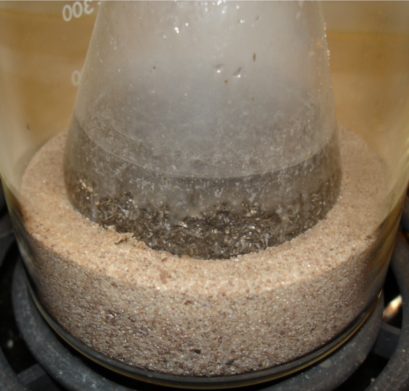

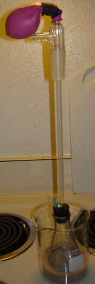

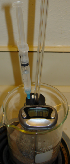

[*] posted on 4-1-2011 at 20:49
Failure (Negative Result Report)
1.58 g of Mg "shavings" from a firestarter and 3.06 g of reagent (though quite old) KOH hemispheres were added to a 125 mL flask containing approx. 50 mL of Kroger brand *mineral oil "laxative". The flask had a rubber stopper with a long glass tube in it. At the top of the tube was a balloon with a few small "needle-holes" poked in it. A wet paper towel was wrapped around the tube near the top. The flask sat in some sand in a 600 mL beaker. The stopper was placed on and the sand was heated (I can't find my damn glass thermometer so I couldn't measure the temp. directly) to a temperature of 200*C over a period of about 30 mins. Then, a hypodermic needle containing 0.6 g of mineral oil and 0.6 g of Reagent t-butanol (the alcohol did slowly dissolve with just a bit of stirring) was thrust through the stopper and injected into the solution over about 25 mins. I noticed "instant" boiling of the alcohol/oil soln. as soon as it hit the main mixute. Once the temp. got up to around 250*C there was sporadic boiling. S
tarting at about 200*C (I'm not quite sure on this exactly and will have to check my notes at home) there was quite a bit of gas evolution and it stayed steady for several hours. The t-butanol did seem to increase the amount of bubbles but it could've just been boiling. The reaction did not seem to proceed at all and after about 3 hours a few black specks were noticed floating around. Then the Mg started to turn black and eventually I started to notice a white "precipitate" on the bottom of the flask. It seems as if the reaction did not occur and the KOH just settled at the bottom and the Mg was oxidized (by H2O/air?) I desperately added quite a bit more t-butanol (unmeasured) and just got refluxing t-butanol in the rxn mixture. I finally stopped heating after 6 hours.
My guess is that there was not enough mixing due to the sporadic boiling. Also, the KOH could've been poorly stored and could thus be mostly the carbonate. It could also be the Mg but I doubt it. I simply shaved off Mg from the block with the tool that was included (and damn that took a long time and a lot of elbow grease; the battery to my drill was dead).
And before anyone says anything: Yes, I know there are different and better ways to set this up.
*The mineral oil said it contained vitamin E as a stabilizer.
The setup:
SETUP.PNG - 216kB SETUPCLOSEUP.png - 173kB
About an hour after adding t-butanol and 1.5 hours into the rxn:
MIDRXN.png - 541kB
The results:
RESULT.PNG - 374kB
Thanks for your time!

MJP, Looking at your setup, you very well may have lost your t-butanol to the atmosphere.
About the t-butanol crystallization problem, how about adding a touch of hexanes?
[Edited on 1-5-2011 by smuv]

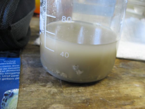

Here's the rest of the report on the first batch:
Last night, I was too tired to look after the reaction after the 4 hours of reflux were over, so I let it run overnight, for a total of 12 hours reflux after addition of the t-BuOH.
The next day, after cooling down, it was still turbid and there was a large amount of brownish powder and crumbly substance under the solvent, with no visible potassium any more.
I emptied the flask into a beaker and sorted through the crud with a spatula and tweezers.
There was a large irregular dirty lump of what first appeared to be byproducts, but upon cutting turned out to be massive potassium metal! The whole lump was softer than sodium and could easily be deformed between two fingers.
It weighs 2,1g and is shown on the first picture, under clean fresh Shellsol. Anyone familiar with potassium will recognize the bluish appearance of the recently cut surface.
I could have cleaned its surface with 1-butanol, but since it rapidly regrows the oxide layer upon storage, this was omitted.
There was another smaller lump of potassium, weighing 0,4g, and several more 3mm pieces that were dropped onto ice outside, making a nice show of flames and sparks.
The K pieces were recovered from the byproducts by manual sorting based on appearance (the K pieces were dark colored on the outside, contrary to the white/grey Mg oxide byproduct). On the second picture, the reaction mixture minus the first lump of K is shown.
So I conclude that Pok's method has worked for me and made 2,5g of useable potassium from 6g KOH and 3g Mg powder in 50ml of Shellsol D70.
Deviations from the procedure were that I added 0,2g more t-BuOH after losing some to evaporation, and boiling for 12h instead of 4h.
The most important observed difference was that I did not get any shiny potassium balls, but large lumps with oxidised surface.
Kalium-Test_1.jpg - 30kBKalium-Test_2.jpg - 37kB
