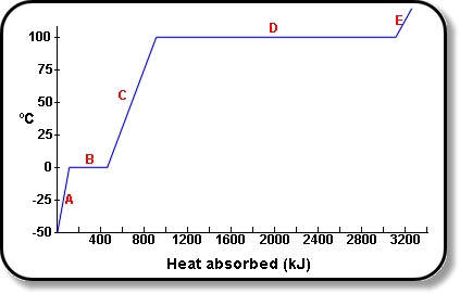

Bert
Posts: 2821
Registered: 12-3-2004
If you have ENOUGH cold water, and the reaction vessel configuration and rate of addition allow the heat to be removed, it will be possible to prevent
a run away. Determining in advance HOW MUCH ice and WHAT SHAPE/SIZE reaction vessel is what all the engineering math earlier was about. You only need
to keep the charge below someplace around 20 C, but colder gives more margin for error-
The key difference in starting with cold water: there is a substantial amount of energy required to MELT the ice. You're going to need substantially
MORE cold water than ice, even comparing liquid water at .001 ºC, to solid ice at -.001 ºC.
Water heat of fusion: 334J/g (334kJ/kg)
See area "B" of graph below:
![image.jpg - 22kB](http://www.sciencemadness.org/talk/files.php?pid=390780&aid=37298)
The diagram shows the uptake of heat by 1 kg of water, as it passes from ice at -50 ºC to steam at temperatures above 100 ºC, affects the
temperature of the sample.
E: Steam absorbs heat and thus increases its temperature.
D: Water boils and absorbs latent heat of vaporization.
C: Rise in temperature as liquid water absorbs heat.
B: Absorption of latent heat of fusion at 0 ºC,
A: Rise in temperature as ice absorbs heat.
from-http://www.physchem.co.za/Heat/Latent.htm
[Edited on 6-2-2015 by Bert]
