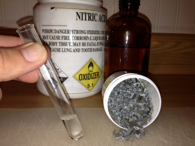

As for the chromium? No reaction with nitric acid. It passivates. Just for fun I did a quick little demo here ![:)](./images/smilies/smile.gif)
70% HNO3, along with a dumped out container of pure Cr.
![photo 1.JPG - 109kB](http://www.sciencemadness.org/talk/files.php?pid=264432&aid=20976)
Threw a bit of Cr in the HNO3.... No reaction.
![photo 2.JPG - 87kB](http://www.sciencemadness.org/talk/files.php?pid=264432&aid=20978)
And of course, to avoid wasting the HNO3, who could resist....Copper turnings!!!!(you can see the nitrogen dioxides running over my skin, so nice!)
![photo 3.JPG - 101kB](http://www.sciencemadness.org/talk/files.php?pid=264432&aid=20974)
