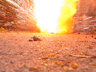

Bismuth
Posts: 41
Registered: 19-12-2008
Ag2SO4 thermite
I gave this a whirl about three years ago. I used 300MESH magnalium powder as the fuel and diapered the mixture together. The mixture was ignited with
a piece of visco-fuse.
![vlcsnap-2010-11-11-19h12m36s190.png - 139kB](http://www.sciencemadness.org/talk/files.php?pid=320254&aid=30051)
The composition would self-confine easily and it was a very vigorous reaction. Due to no presence of nitrogen in the reagents, one could only deduce
that it would decompose the nitrogen in the air into various oxides, as evident from the orange fumes in this still image.
Compared to silver nitrate, silver sulfate has a low solubility in water with a quick glance at Wiki quoting its solubility at 0.79g/100mL at 20
degrees Celsius. I actually never experimented whether or not it would be water sensitive, but having no interest in its practical uses it wasn't an
interest at the time.
I also experimented with silver oxide, but the results weren't nearly as exciting. Perhaps my ratio calculations were off. To this day, I still have
300g of both these silver salts, as well as acetate...
