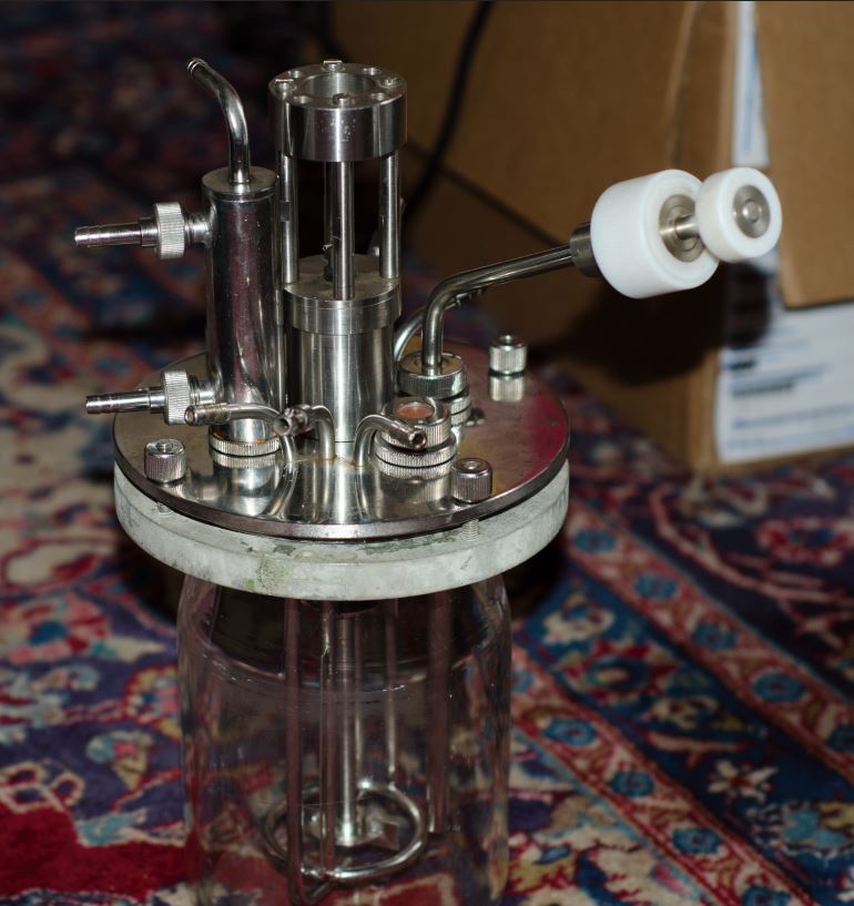

I am also trying the grass fermentation, but first I am giving it two days of free air but a little heat (26c), i chose this because I figured the stage would need air like a silage pit does, then its closed up to exclude most the air, in practice the farmers I know wait for the pile to drop a couple of feet then they seal the pit off (this is called a clamp in the uk), its different from the wrapped bales but gives much better feed. So I figured I would compact the grass a bit and wait till the level drops a little then seal up.
I might also add cow shit (tiny amount) as going the methane route as a start point is a good idea.
I am going to use one of these
fermentation.JPG - 88kB
at the moment my grass is in a plain glass jar, but once it starts to do something I can transfer to the fer mentor. it should give me good control over the fermentation and i can add buffers ect via the septum or one the tubes. It also has a stir thing and any gas evolved could be piped into this
wash bottle.JPG - 43kB
I might add some form of wet sugar like honey or malases (again tiny amount). i will let you know if anything happens. If it start to ferment I will up the temperature to around 30C, I found out methane ect should stop at 40c, this was from a bio gas page about a car in the uk running from the gas made from chicken shit back in the 70's, I will try and find the page again
